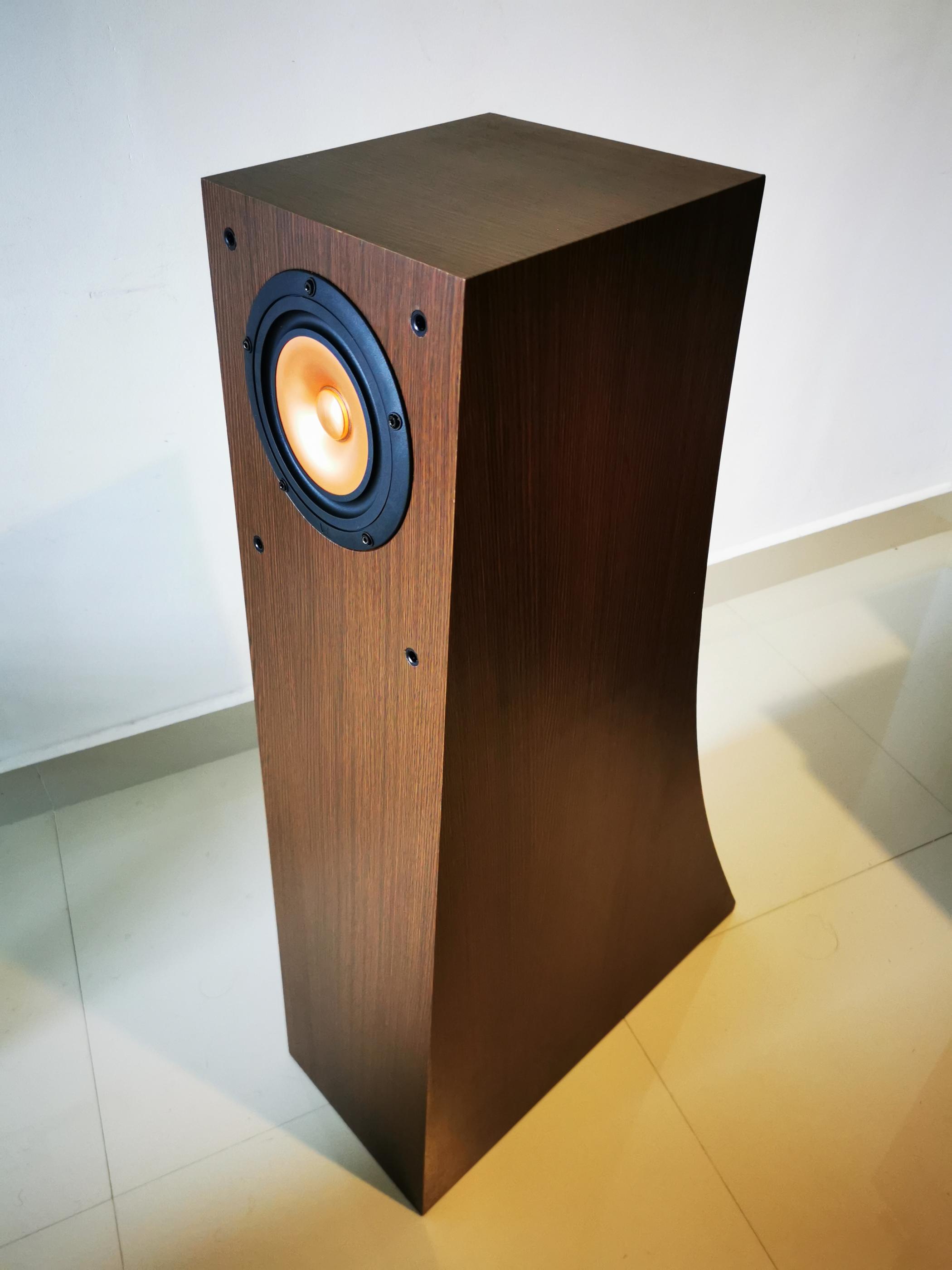

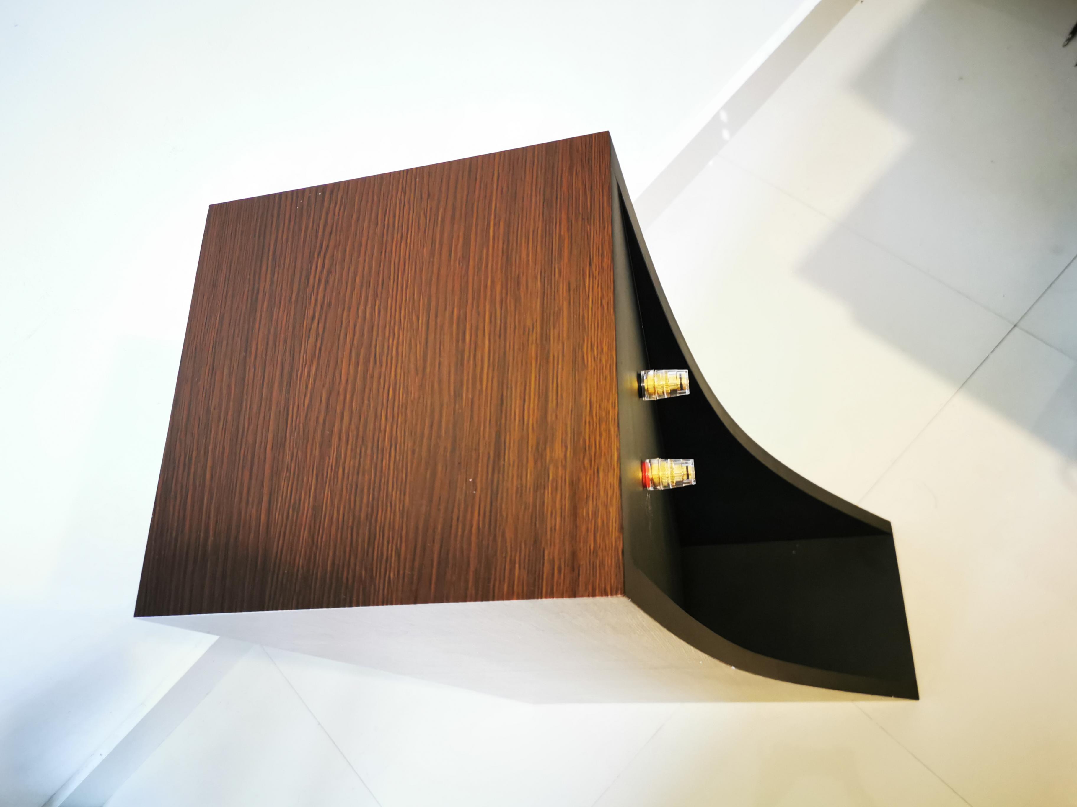

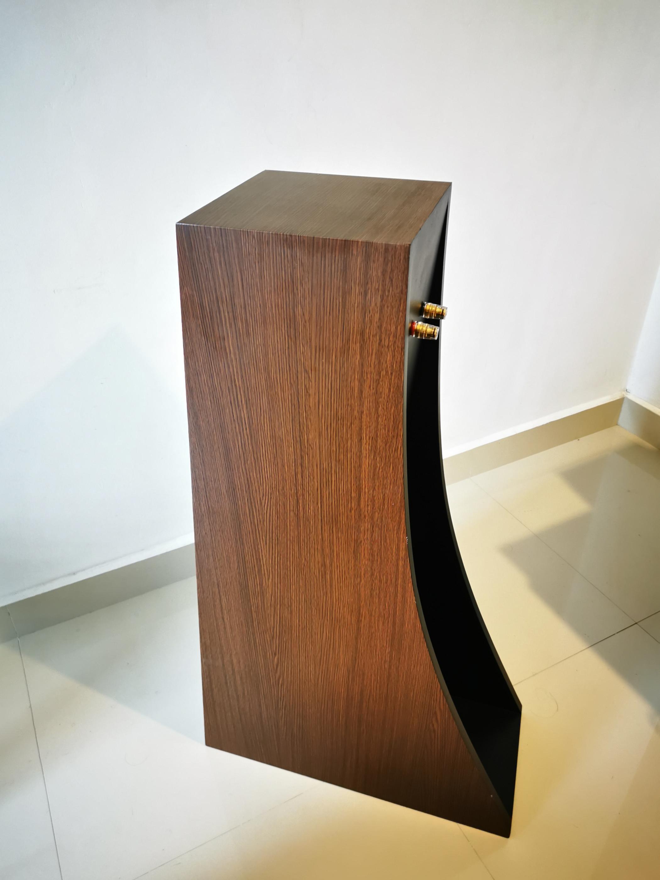

Hey folks
I'm delighted to tell you guys that I just finished my Alpair 11ms Frugel-Horn XL and currently going through warming up the speaker.
I couldn't have completed this task without the help of this forum members especially planet10, orangeart and Scottmoose. I will be always grateful to you guys.
Initial impressions are very positive.
Sound stage is wide and I can clearly see the point source benefits mentioned by Mark Fenlon.
Treble is running a bit low at the moment, it might turn a bit more bright after the warm up I assume. Might be to do with my tube preamplifier treble roll off as well
Bass is already pretty deep going. The character of the bass is very similar to what comes from a subwoofer. Subtle room filling bass but at the same time very deep and sustaining.
Overall sound signature has a certain cohesion to it. All the frequency ranges comes out very balanced and synergistic.
Will post further impressions as the speakers warm up.

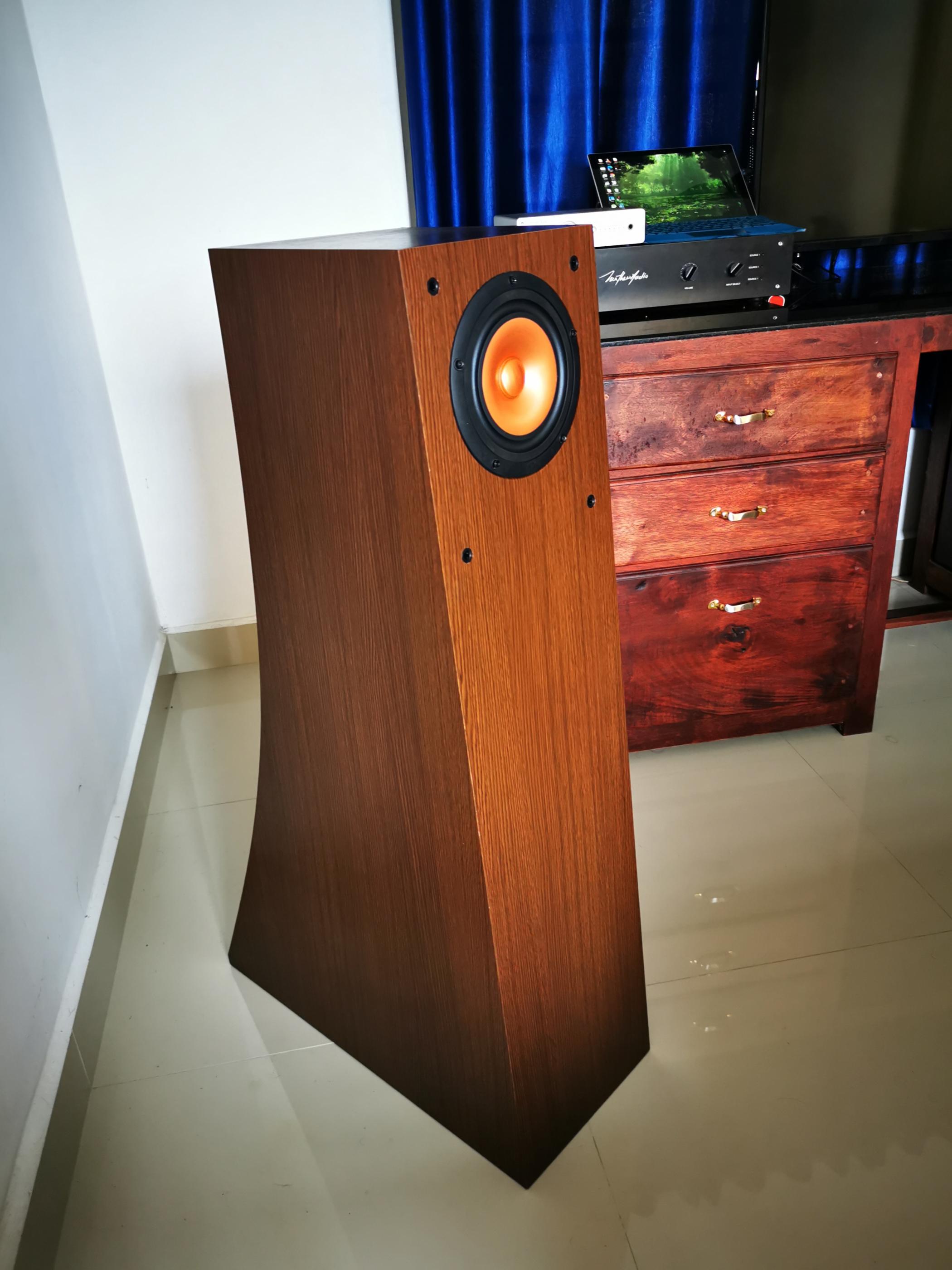

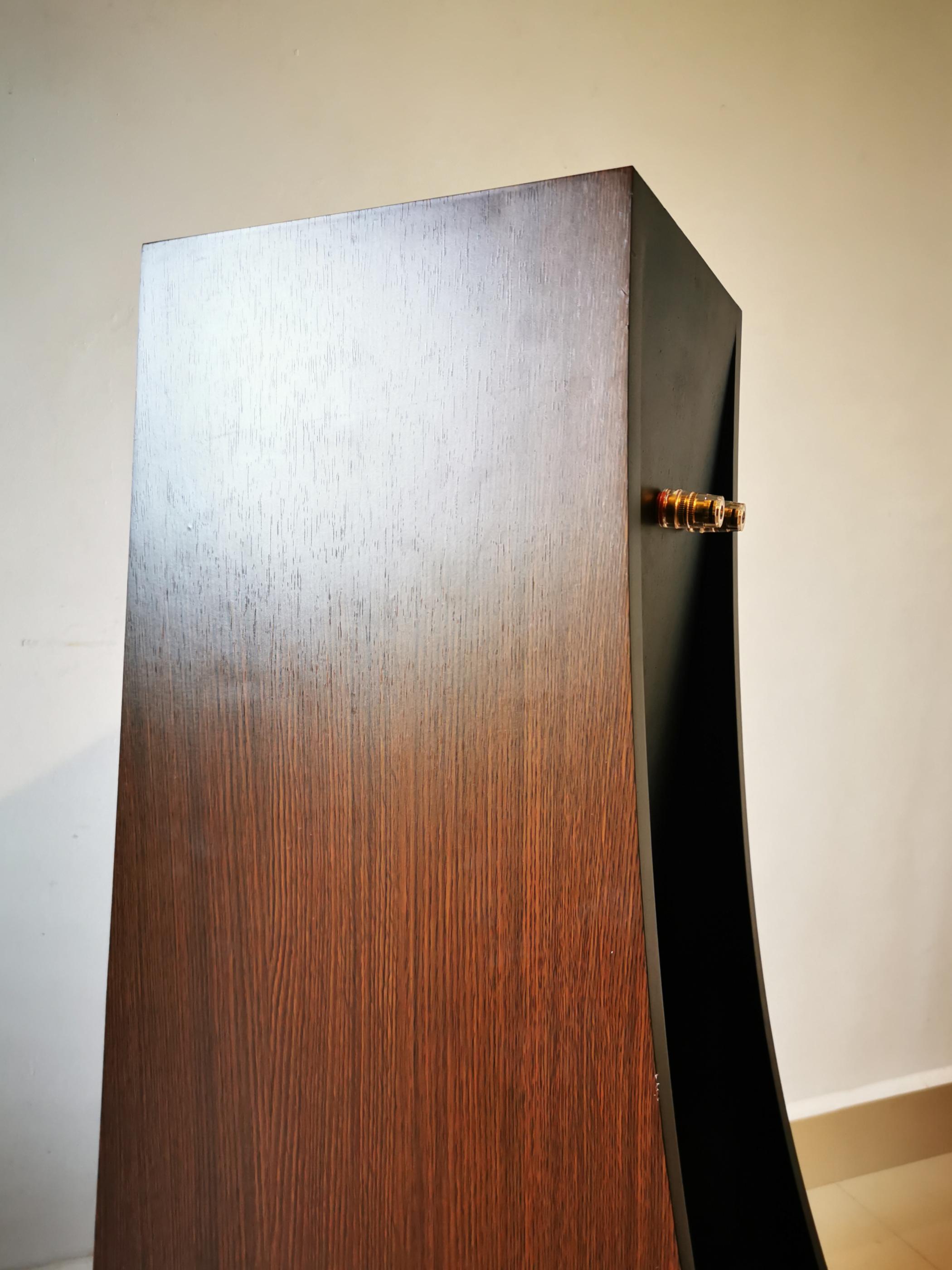

Berlyassocial - looking very nice !
What veneer did you use, and how did you finish it ?
I have just bought a pair of the same, but mine were orangeart's own ones he used for demonstrating, and have the MAOP 11's in them - while I've only managed a couple of hours listening time, they compare very well to my existing speakers that cost over £3200 new...
in fact, what I've used is wooden finish vinyl wrap. In my opinion vinyl wrap performs as well as veneer in terms of finish and looks.its not easily scratchable and is quit thick as well. just you have to do some preparation on the surface you are going to wrap it which was done by the person who build the cabinet.

Did you slightly rebate the drivers or they are flush-mounted on the front baffle? I am asking because I haven't not seen these new Mark Audio drivers with slimmer bezels in real life, so difficult for me to be 100% sure.
The cabinet maker did a good job with both the cabinets and the vinyl wrap.
We did create recess for a flush fit. But we didn't count for the rubber gasket seal which comes with the driver. So right now it's not perfectly flush. Maybe around 1 or 2mm protruding from baffle surface
Wow berlyassocial, those speakers look beautiful. Do you have any more info on the wrap that was used?
I don't have anymore information on vinyl wrap used. It's was finished by the cabinet maker. He sourced it and wrapped it. There is some additional treatment he did to the plywood before wrapping which I don't have much info about.
