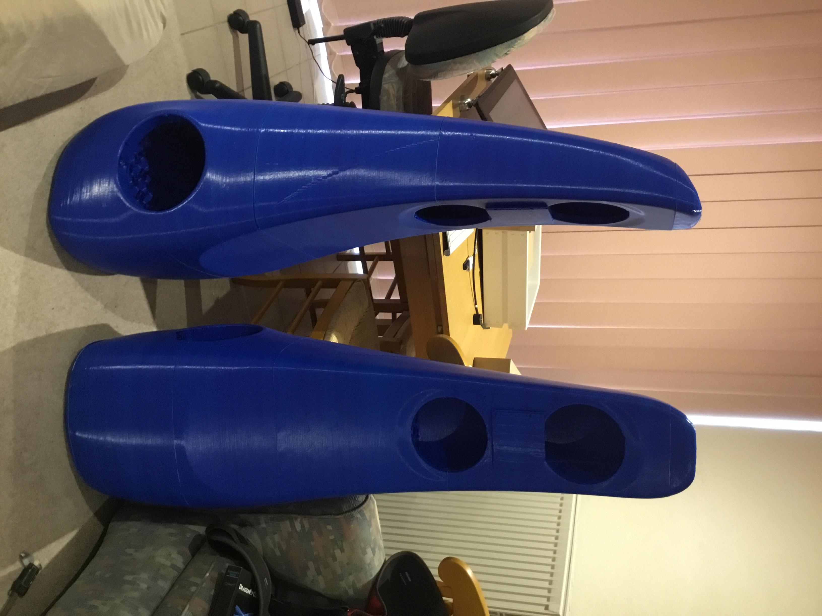

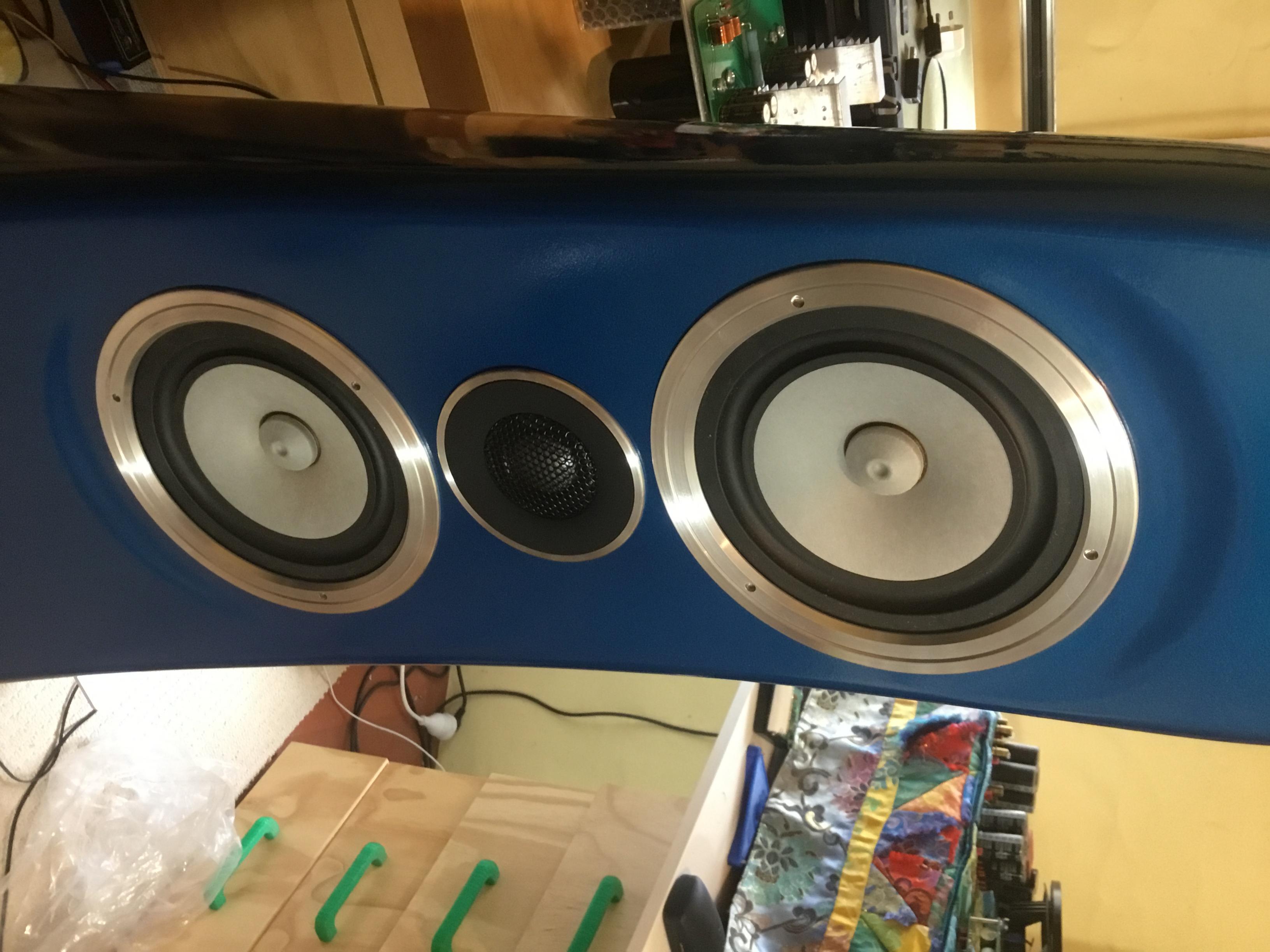

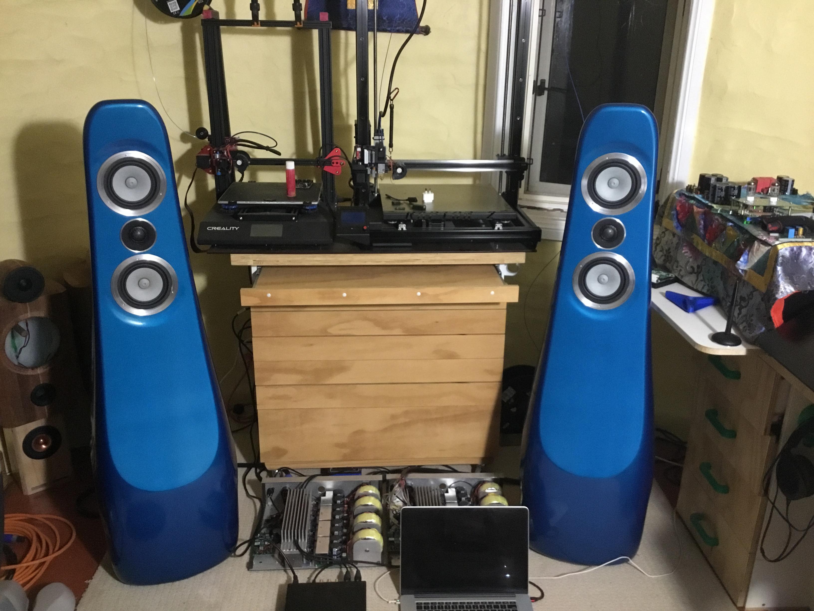

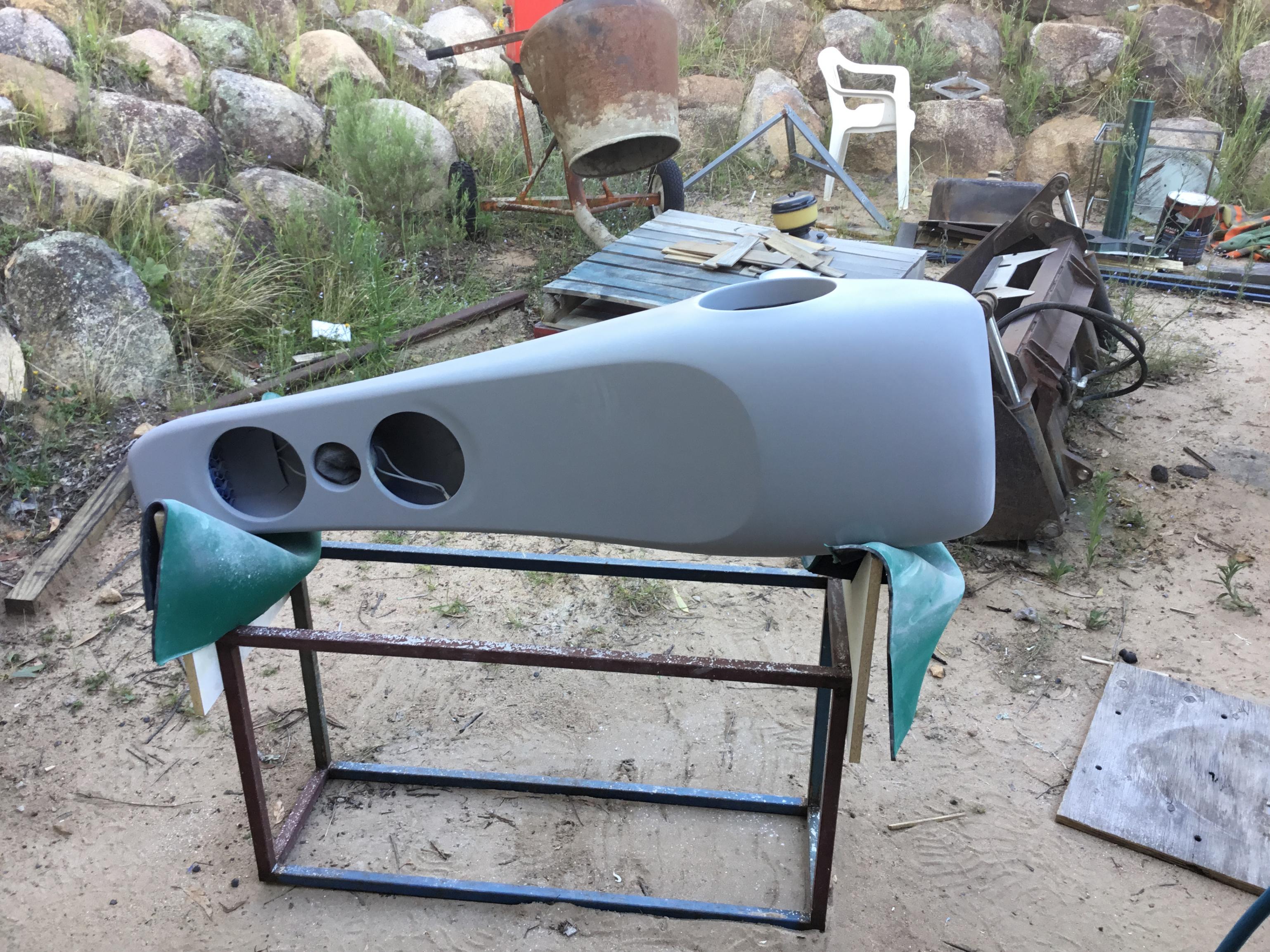

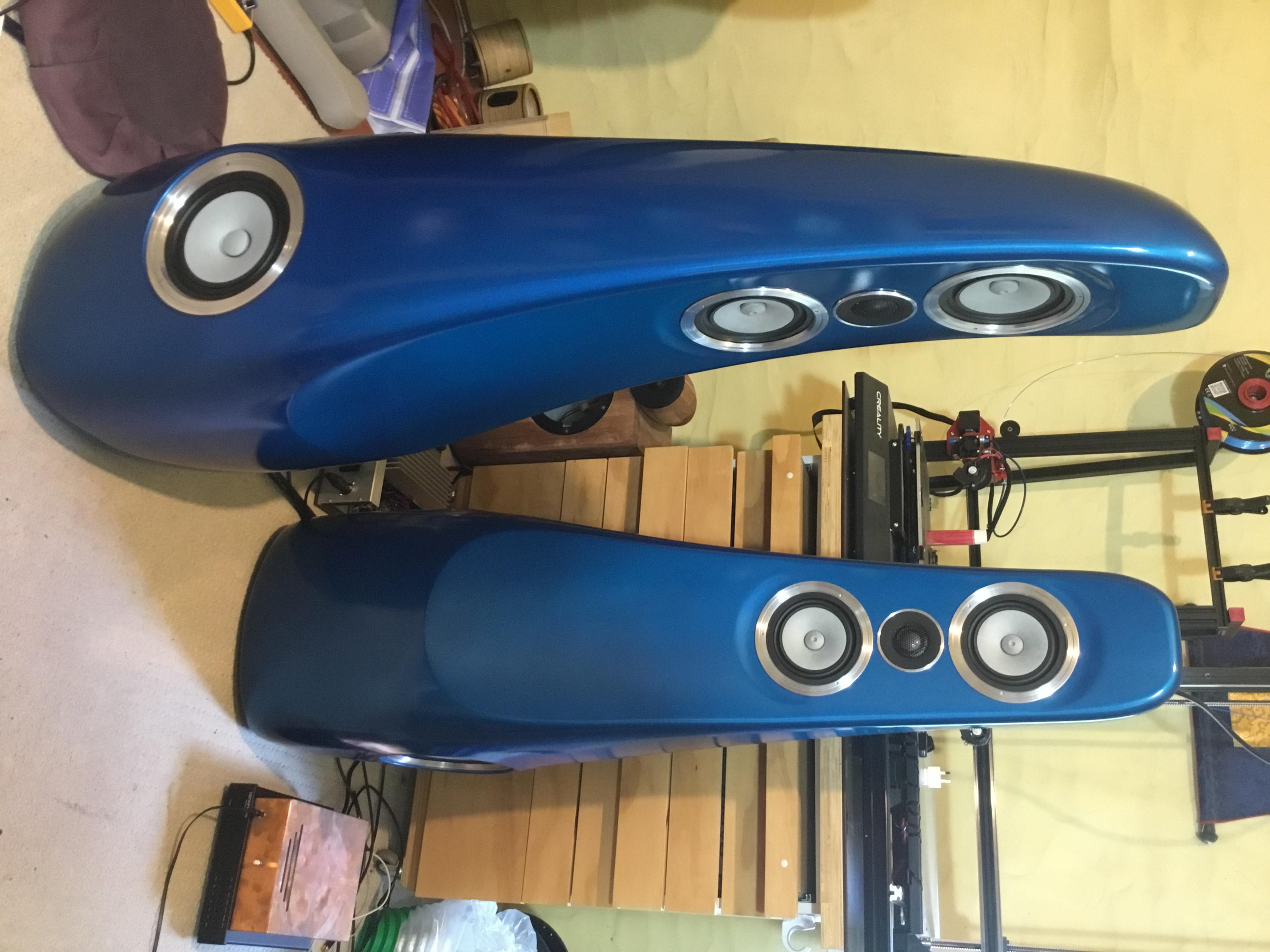

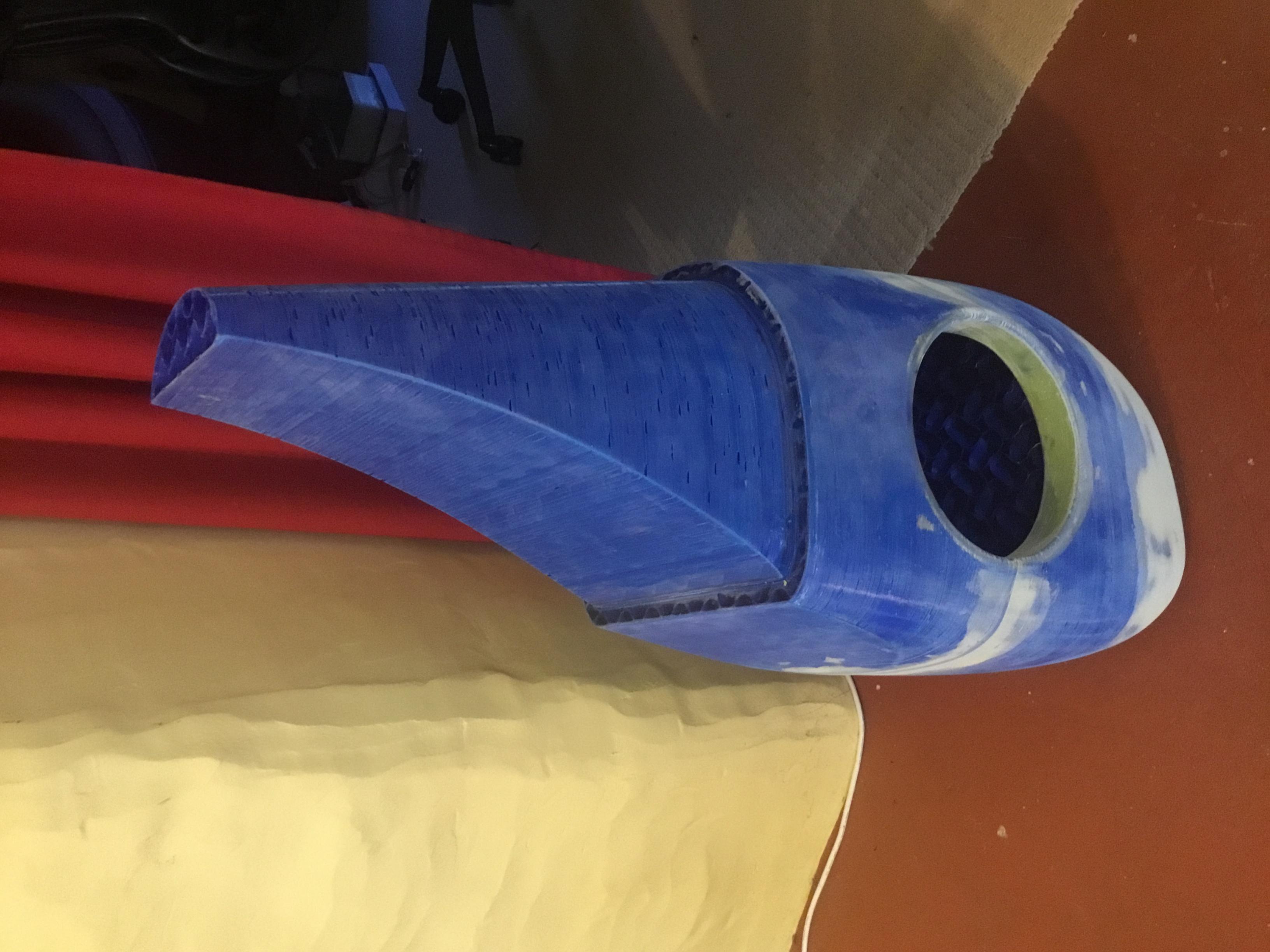

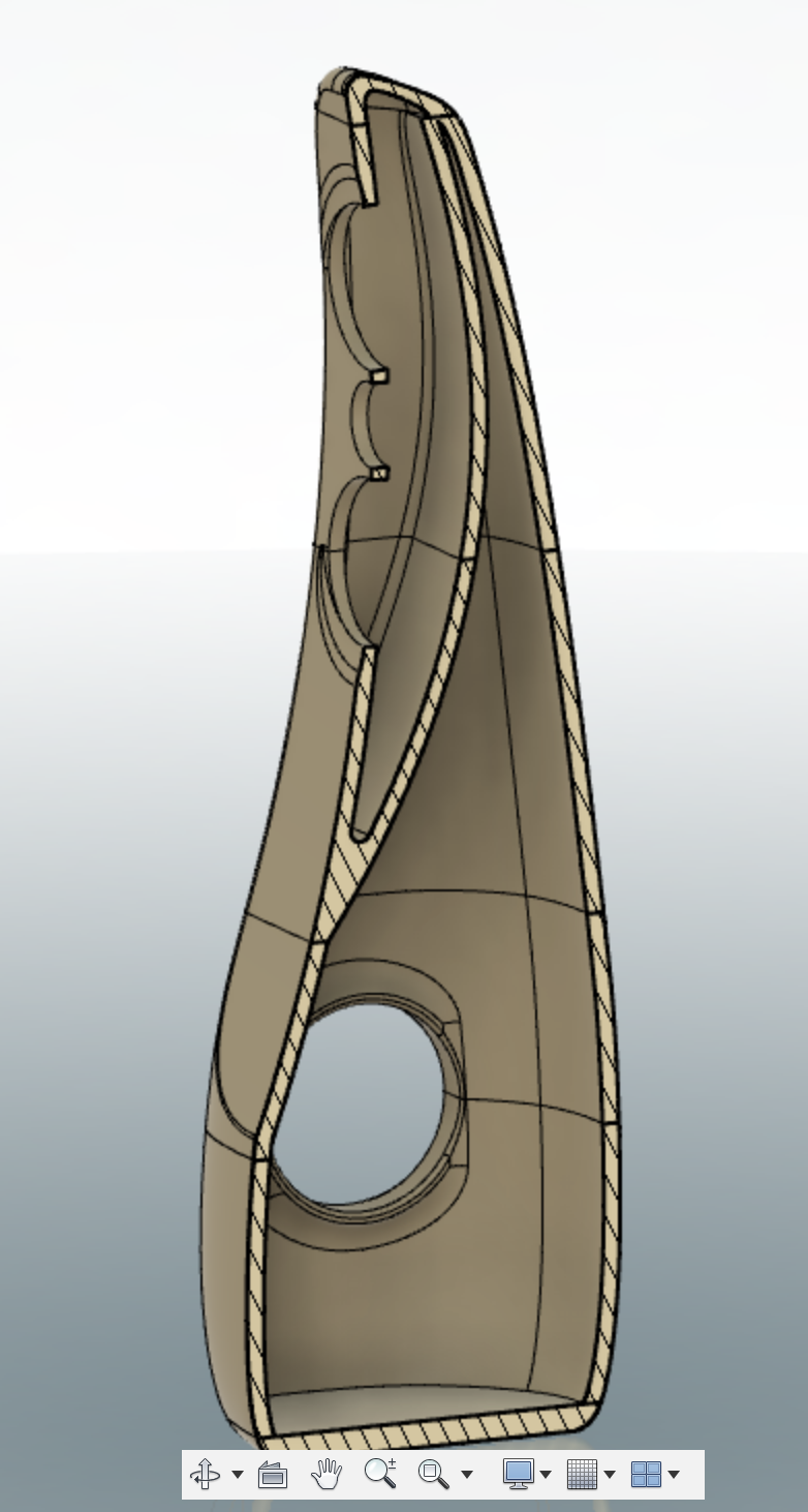

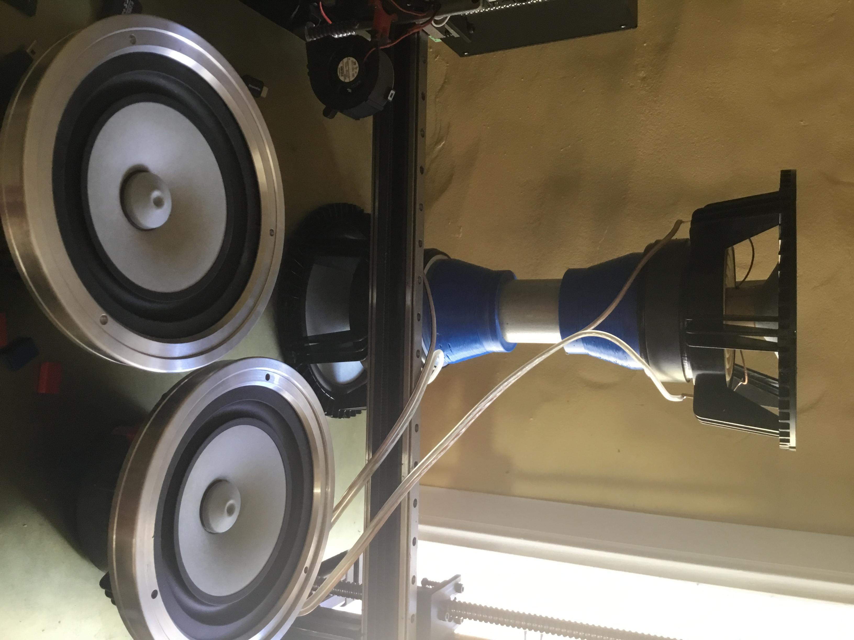

Just finished this build and though it might be of interest. Drivers are 10p and 12pw and SB acoustics tweeter. The speaker is 3D printed and features a hollow 18mm outer wall which is filled with pourable urethane rubber. Internal bracing is a 3d permeable (but incredible rigid) structure called known as gyroid infil. So the speaker is braced by a rigid internal foam like structure with rubber walls.

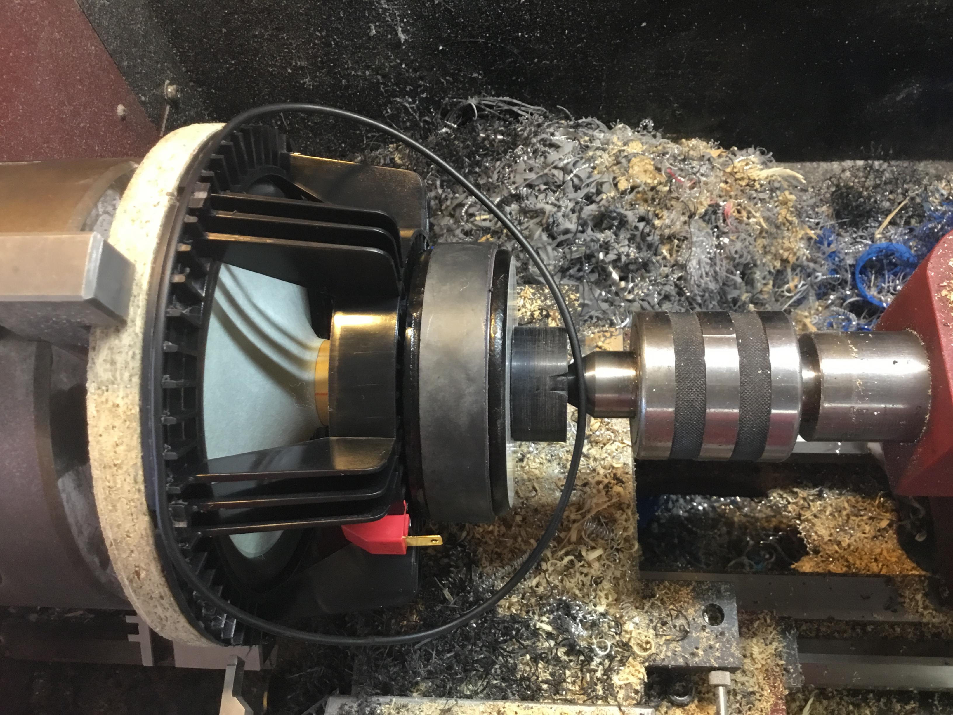

Drivers are mounted in compression with a face ring that post tensions the driver frame against a block that sits behind the magnet. All drivers are decoupled from the enclosure at each contact point with o-rings. I trimmed quite a bit of the mounting flange of each driver on the lathe, this was a bit scary but necessary to increase the rigidity of the driver frame in compression and to keep the baffle size and mounting ring as small as possible.
Sealed internal cavity is about 50lt and features my approximation of an exponential absorber tapering towards the top of the enclosure.
Amplifier is made up of 8 individual channels with active crossovers at 200hz and 3000hz. So one channel per driver except for the two 10p which share a channel and are connected in series.
I have learned a lot from this forum over the years and hope that some of you find this design interesting. I have made quite a few boxes with Mark Audio drivers over the past years and lots of listening led me to the decision that i wanted to go with this design. I guess the goal was to get the incredible articulation of the MA drivers but to marry that with the benefits of a multi driver design. I know this isn't really Mark's intension for his his driver designs but I think the sound quality of this design really speaks for itself, it is just breathtaking.
Anyway, big thanks to Mark Fenlon for his visionary engineering and also to this forum for providing such excellent information.
Best wishes,
Ben.
PS sorry the pictures are sideways... not sure how to fix this.

Hi Benjhla,
They look absolutely incredible, with exceptional workmanship & design flair.
Thanks for sharing
Thanks for sharing
