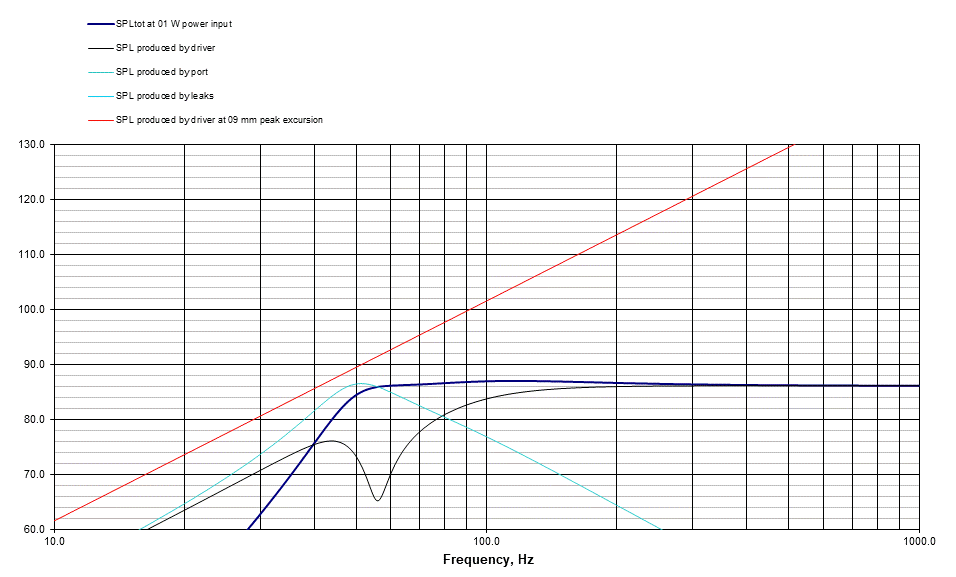

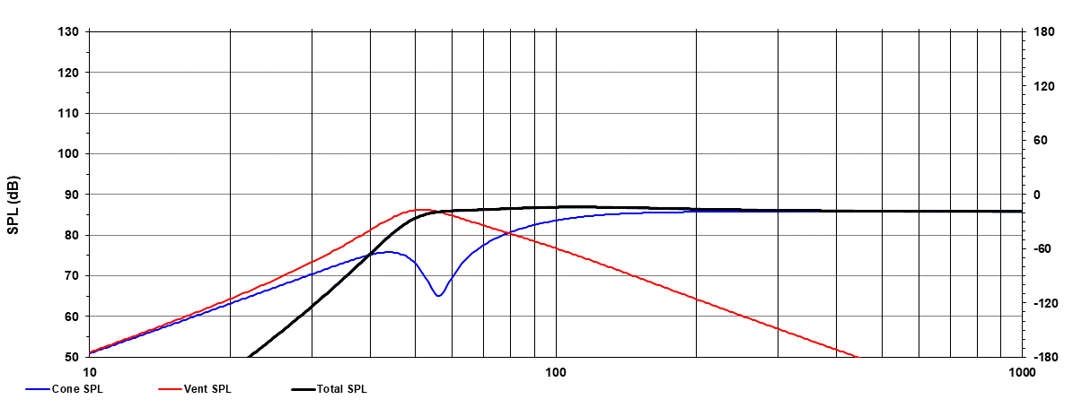

What is the frequency the vent is optimized in this case? Is it smth ~90Hz?
If you look at the graphs in post 1493 above, system tuning (Fb) is 45Hz. The second plot shows the nominal driver and enclosure outputs -the latter is the dotted blue line. The third plot shows the LF system impedance; Fb is the minimum between the two peaks.
Thank you for explanation. This is for me to still to learn, but I will try to learn quick.

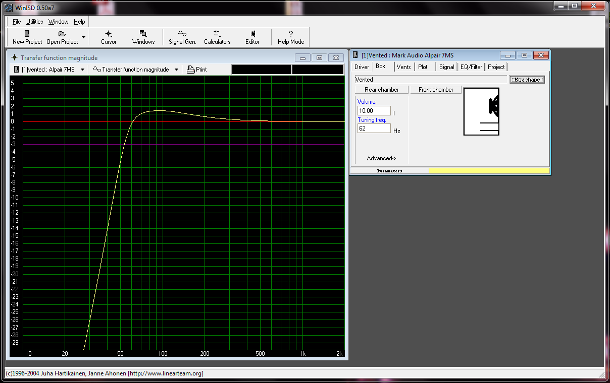

Does anyone know what kind of bass extension can be expected from the Ibelin Reflex enclosure for the 7ms (on page 10 of this thread)? Was hoping to use these nearfield crossed over to a sub in a small room (approx 3m x 3m)
Here's a plot in WinISD. So approx. 10L volume tuned to 62Hz.
jeff
jeff
Not quite. 10.2 litres effective, lagged walls, Fb = 56Hz, 0.5ohm series R incorporated for typical wire loop / connection resistance.
Thanks for your quick responses guys. This should be fine to cross to a sub at about 80hz, right?
Yeah, that looks better, thanks. For some reason I entered 50mm for the vent length, instead of 60mm from the drawing.😱
