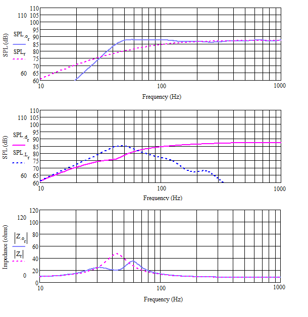

In the process of trying to learn Hornresp, I thought I'd take a shot at modelling Sea Stack for the 11MS - does this look like about what you'd expect out of that design?
That is one of the best HornResp sims of a TL i have seen yet.
I haven’t seen Scott’s sim (just built the box), F10 in the low-mid 30s sounds about right.
Your Path parameter value should be the length of the shortest acoustic path between the two outputs - see Help file.
The value would only be zero if the two sound sources were co-located.
Thanks for the reminder - I was looking for that to fix it and I couldn't remember where it was.
EDIT: To be clear, I still can't remember where to set that.
OK, found it! And...it smooths out the top a lot, which is good to see, but I was mostly interested in the bottom corner anyway.
EDIT: Swapped out the image to one that shows the effects of stuffing just in case people want to comment on that...
Quite close. 🙂
As designed. I don't normally do a maximally flat (or near max-flat) alignment, but this box was created as a simple, large, relatively low-tuned MLTL with less forcing than most use for a similar Fb.
