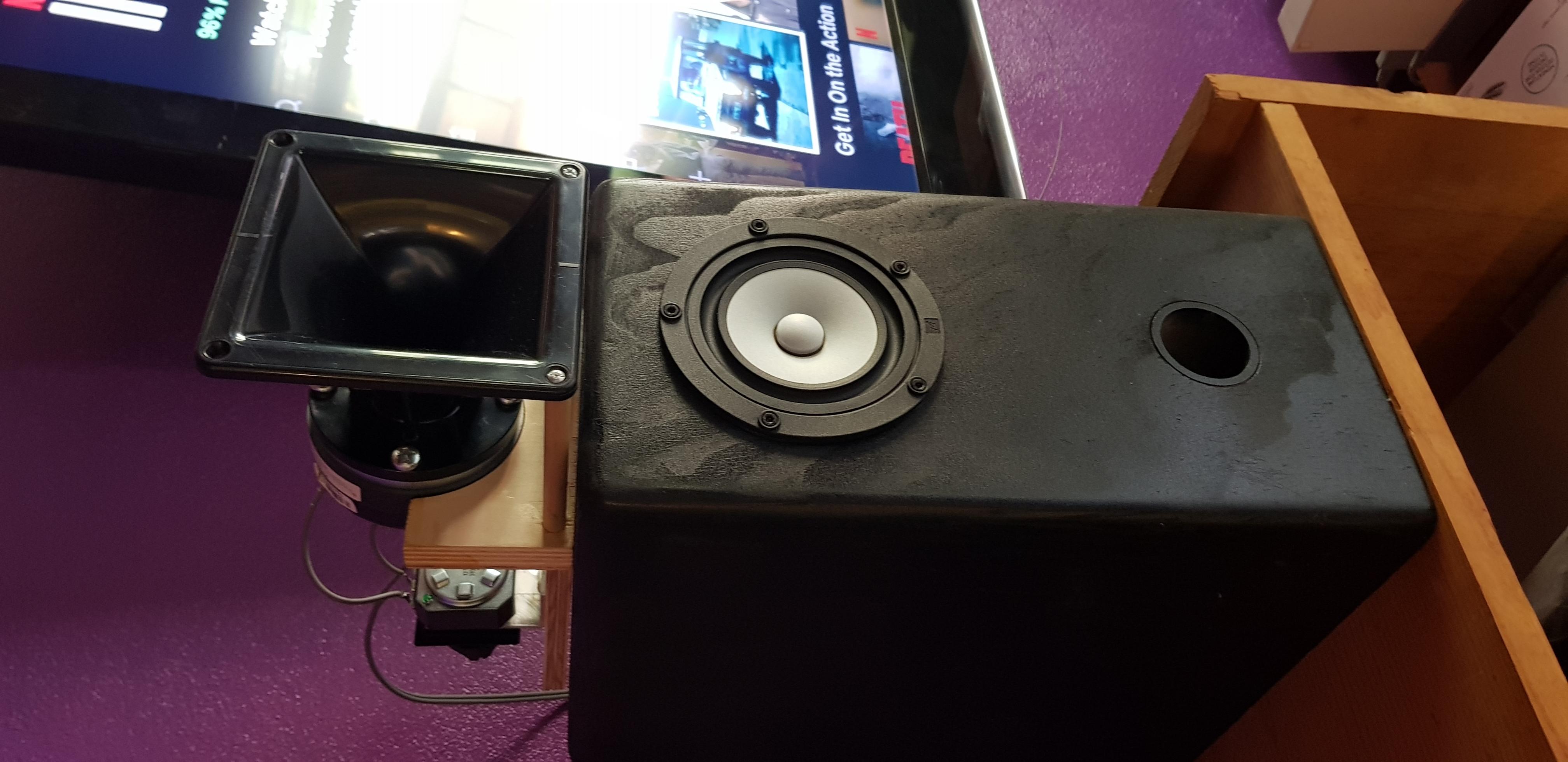

Dave, where were we re the P7PHD? I have had the second set on break-in probably exceeding 500 hours now. Anyway, there is TONS of high treble, even to my mid 60's ears. I think my second pair has more top end than my first pair. Probably slight differences in production runs as I purchased these several months apart; possibly a year apart between orders???
I still use the Fostex T90A above 10 KHz but "I" NEED it; others with better HF hearing most likely will be completely satisfied! ANYONE afraid of trying the P7PHD because they think the top octave may be too weak; I say; GO FOR IT! I don't find it weak at all. BUT, if you can still hear "FLAT" above 15 KHz, maybe try the metal cone version instead!??

My opinion, is that it is dependent upon what you are listening that will determine whether or not additional high frequency presence is required. They do sound great without tweeters but for me sound better with tweeters most of the time because of what I listen to and of course my hearing which like the rest of me has not seemed to improve with age🙂
e.g. without the tweeters I can still hear the high frequencies but they are definitely lower in output than the rest of the output - as designed.
I think with old recordings and or Youtube 😉they are fine sans tweeter.
Fun and jokes aside they are fine without tweeters but better with for me.
