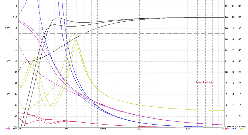

3000 cubic inches (1.74 cubic feet, 48.2 liters) gives some really interesting modeling.
Tuning to 32hz gives us 32hz as a -3dB, and -6db of 27hz. Port length is 1.5" diameter by 1.6" long.
Tuning to 23hz gives us a -9dB of 20hz with a -3dB of 70hz. Port length is 1.5" diameter by 4" long.
A gaping 1.5" hole in an .75" thick enclosure tunes it to 38hz, with a -3dB of 34hz.
It should be fun to play with!
With all designs, Xmax is protected down to 1hz up to 3 Watts. Should be great for my SET amp!

Those alignments all look pretty ugly. And the lower you tune the worse the impedance peak becomes, tha will affect the performanc eof a highish output SET amplifier.
I have choosen 30 litre for the mniOnken for these. miniOnkens tend to be smaller than typical BR (due to the highR vents), but in this case, maybe not.
30 litres @ 40 Hz looks OK, if one has some room gain up higher (often the case in UK homes).

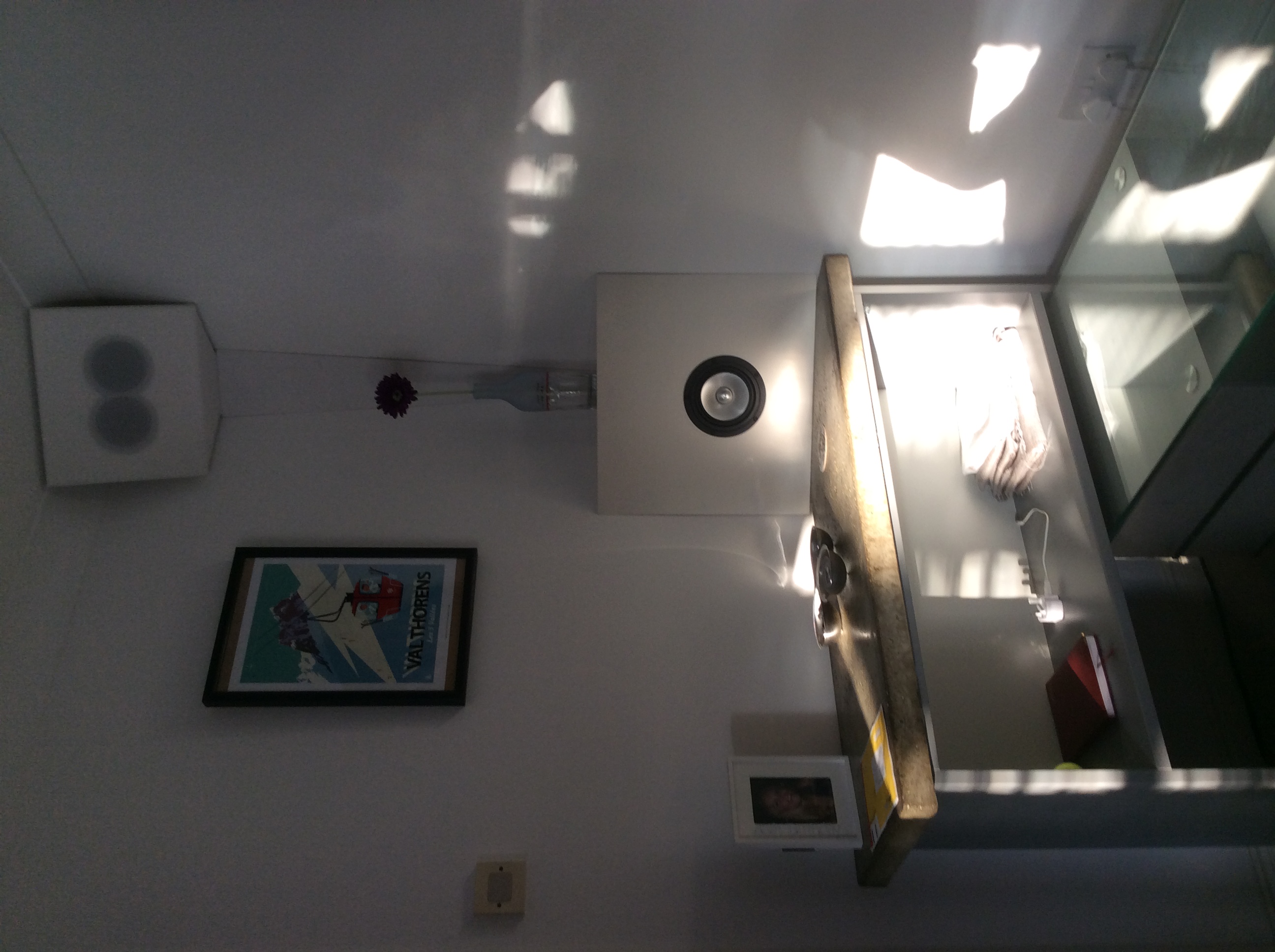

These are what i will be bringing upstairs to use once i get my “B4” active XO from the diyAudio store. A WAW where the wide baffle allows me to XO at 180 Hz. Chris’ room. The A7.3eN wll be replaced by the A7mSeN.

WinISD is giving me me ~20L @ 43Hz for a SSB4 Alignment, which is is supposed to have the best impulse characteristic. Let me know how it looks in your sim program.
Nice equal twin peaks on the impedance chart too. -6dB is 39hz. That's the best alignment I can find for ported sound quality.
I couldn’t say, i pay no attention to “official” alignments since modern modelers do not put alignments into cubby holes.
The curves look reasonable for a BR with a traditional curcular vent. For a highR vent i would raise the tunign about 5 Hz. Thanx that gives me another minOnken option.

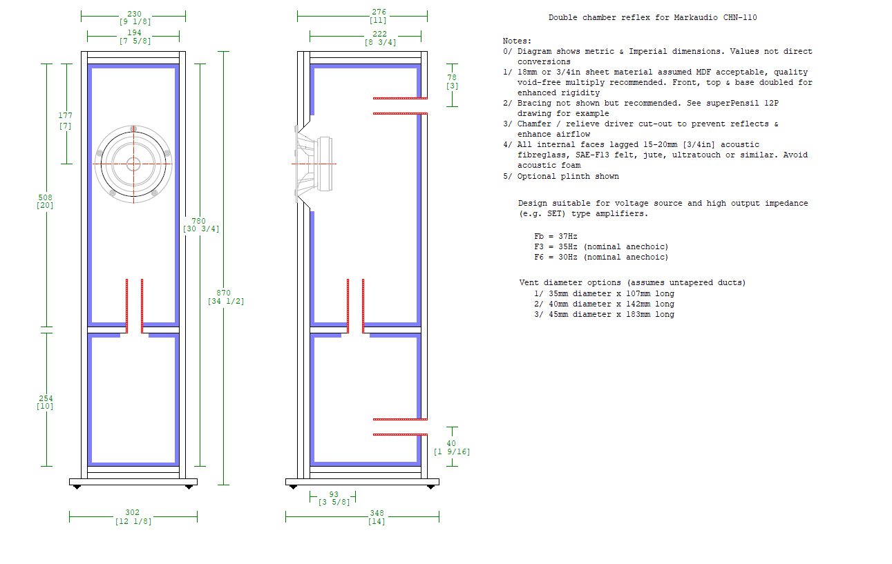

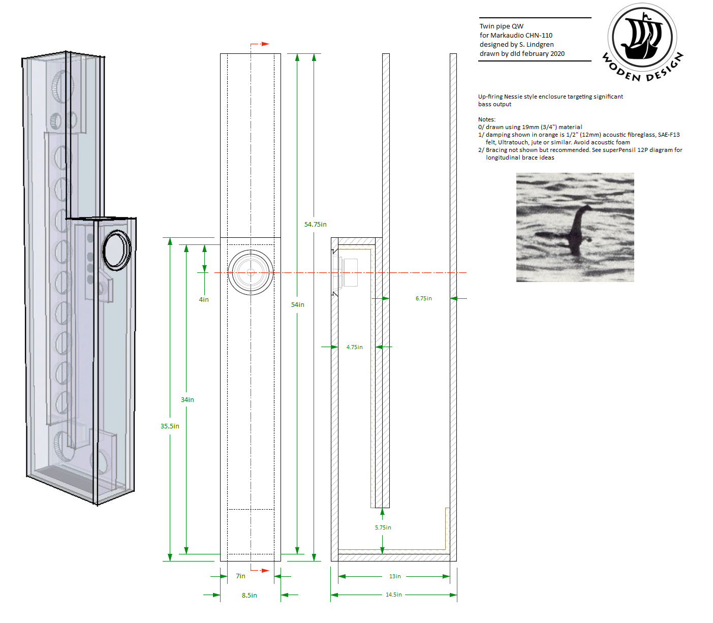

I've done a bunch of boxes for the CHN. A few (in very rough sketch form) are on Madisound: Markaudio CHN110-Silver 6.75" Full Range -Dave's done proper drawings of them which unfortunately were not released. There is also a DCR, a pensil, and a Nessie type twin pipe (the latter for those who like that sort of thing). So I'll do it here. And elsewhere.
