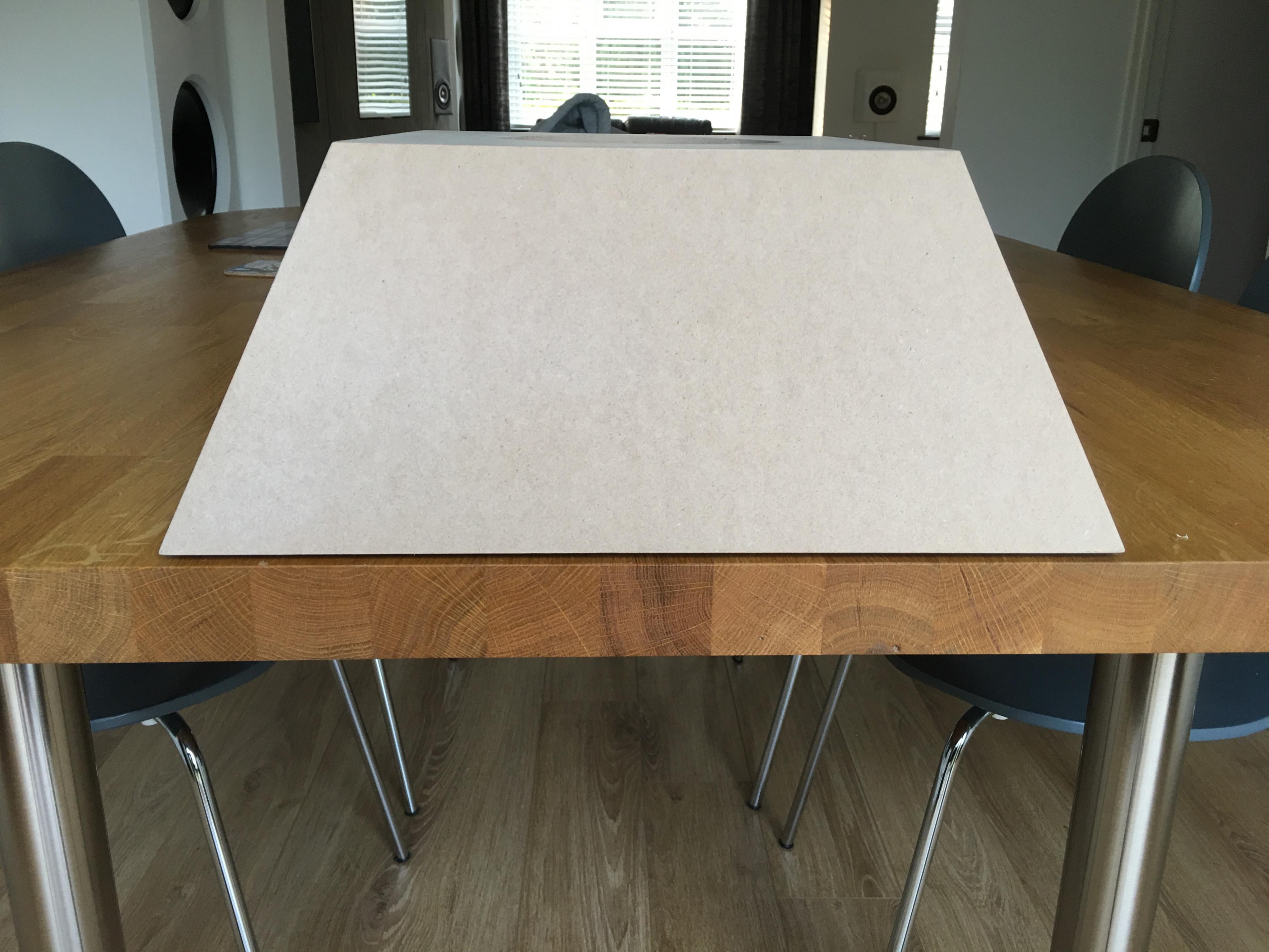

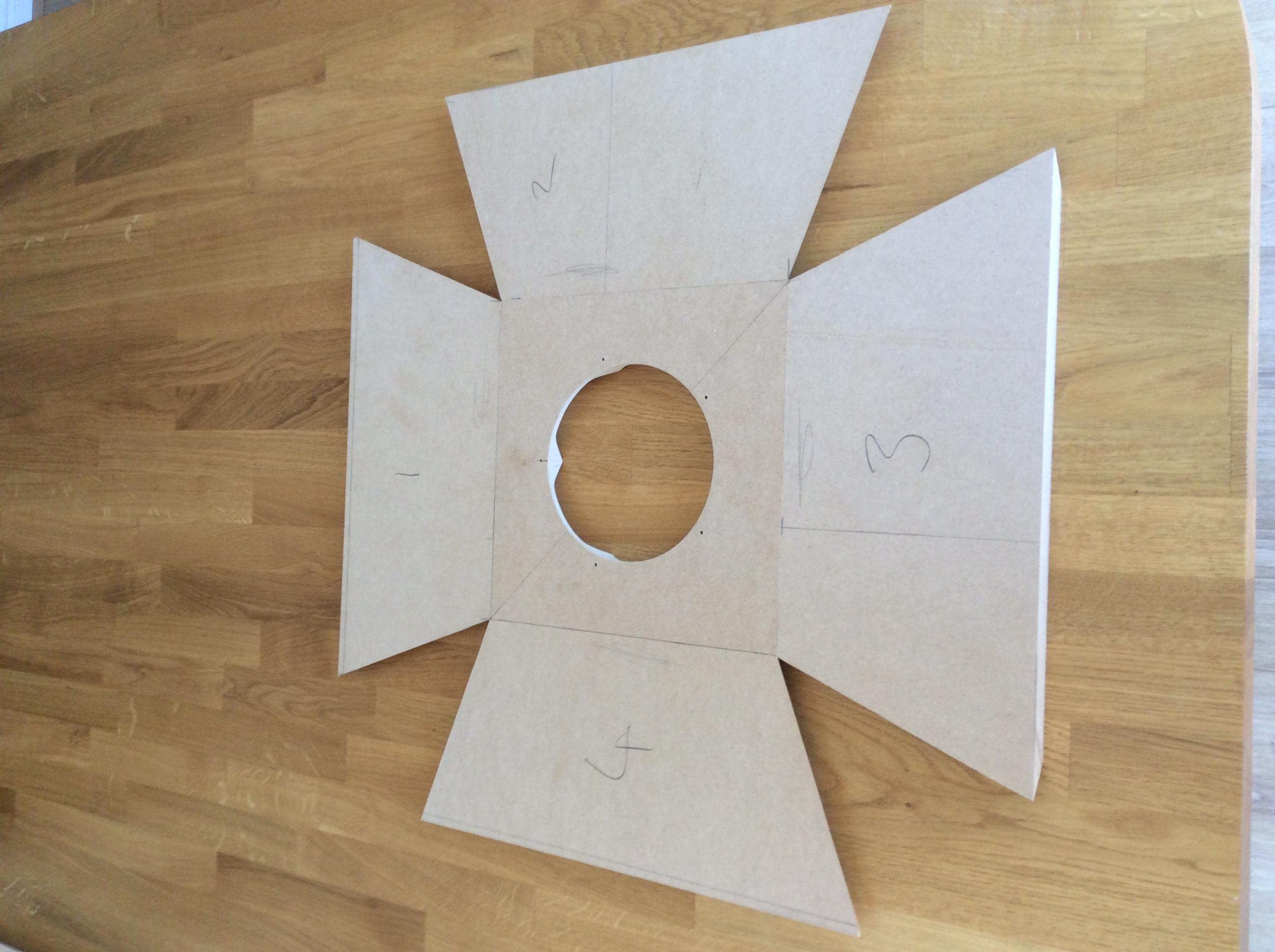

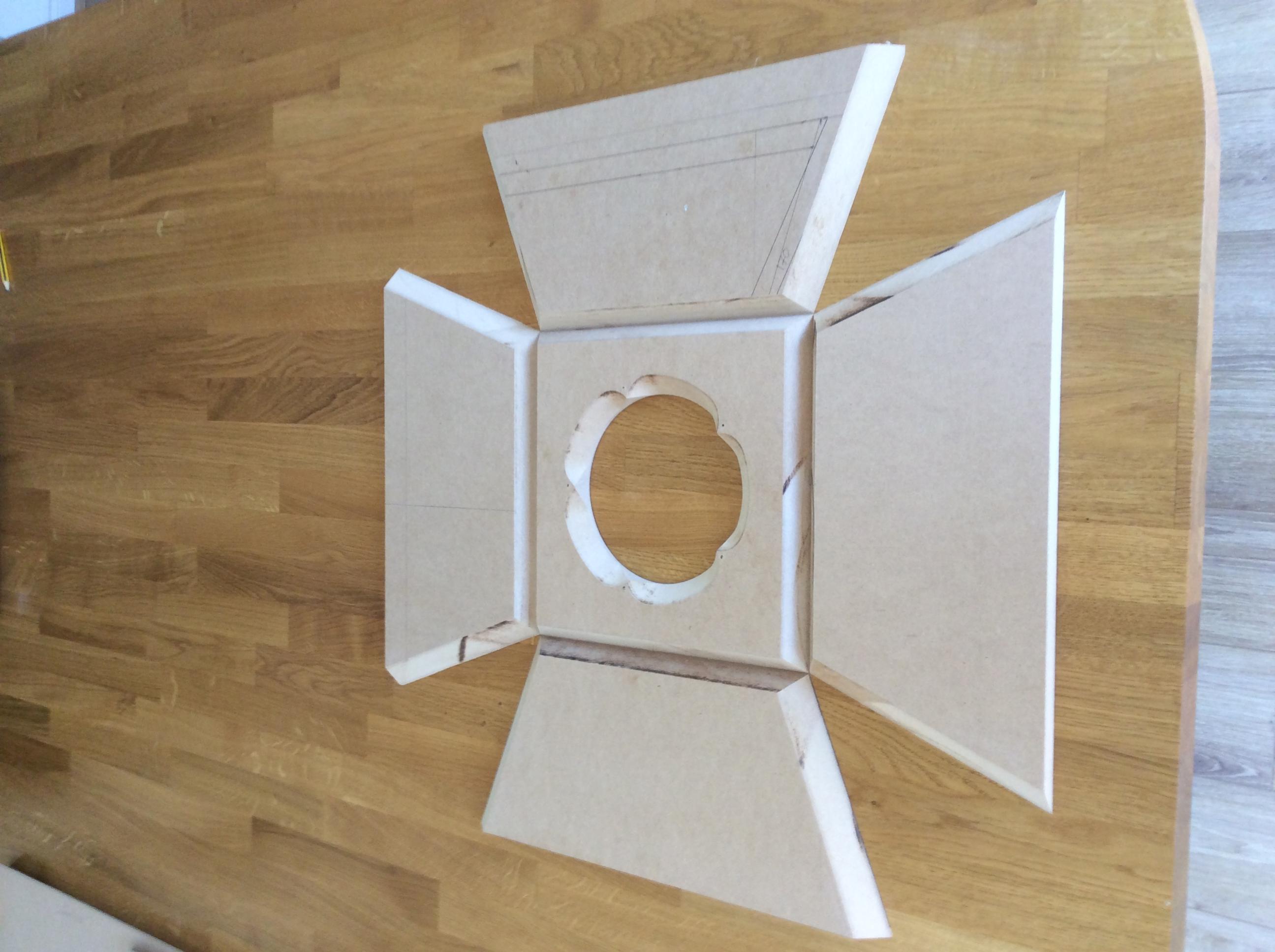

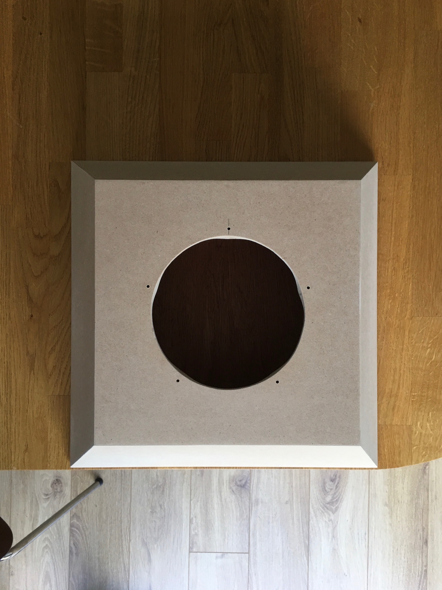

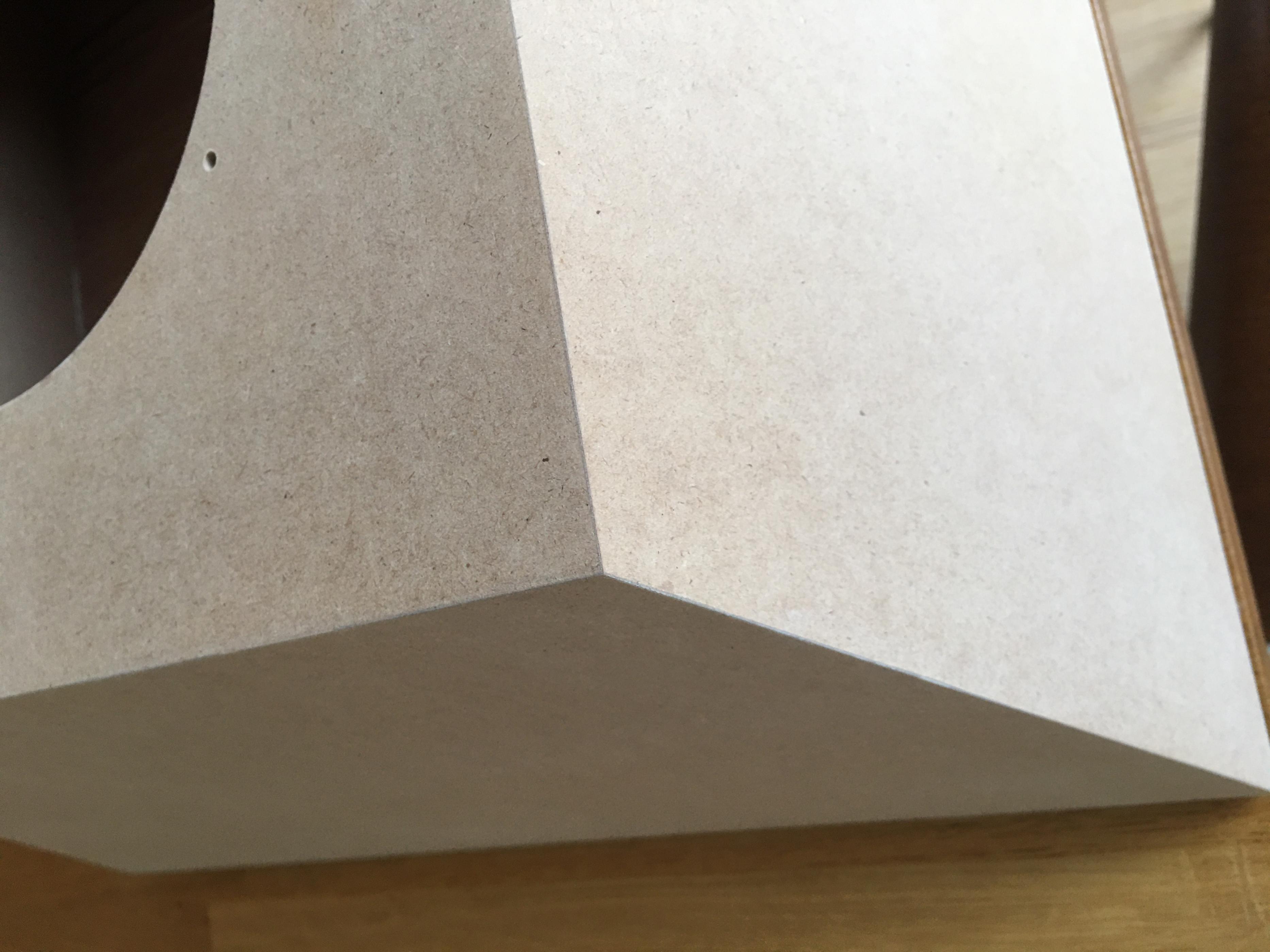

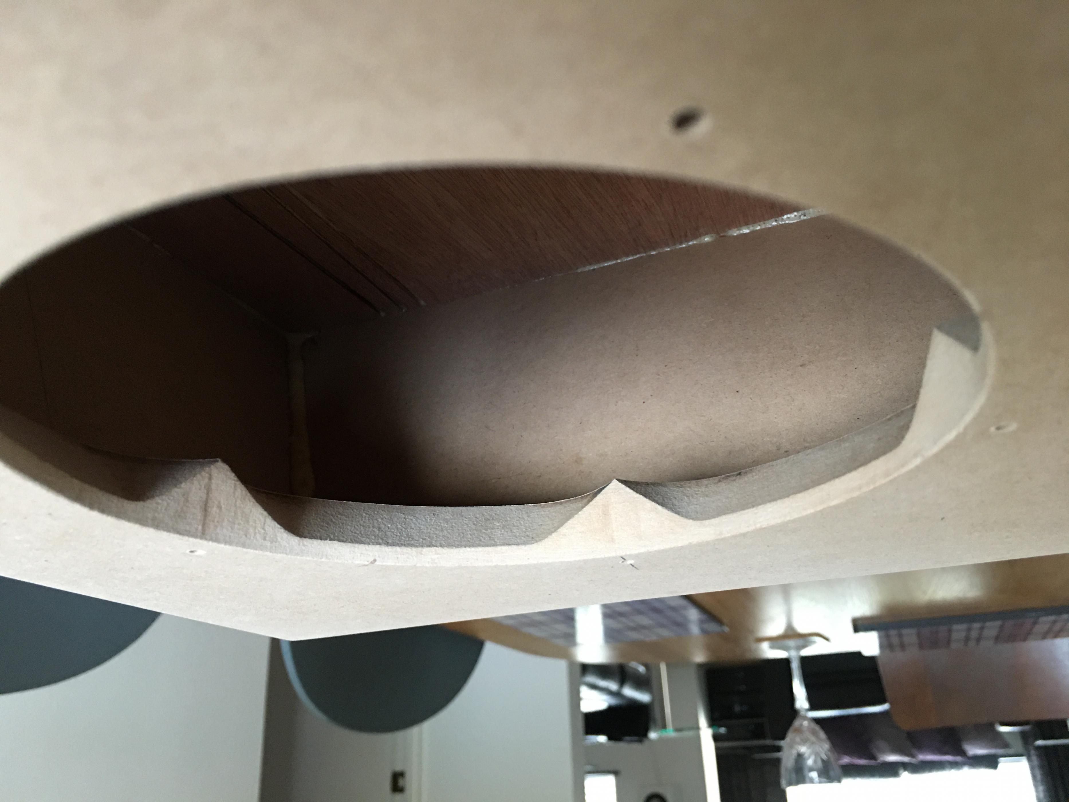

Mk2 Pluvia11 side surrounds
With spare time on my hands due to the current lockdown situation, I’ve started making a Mk2 model of my Pluvia11 side surrounds.

Hi Dave, it’s 18mm mdf with 18mm ply back panels, I didn’t want to purchase any new materials as both myself & Mrs Shep haven’t had any income for over a month now, so I’ve just used off cuts I had laying around.

Utilize whatever you have in hand - Smart thing to do Jason!
Have fun building and hope the income situation improves soon.
