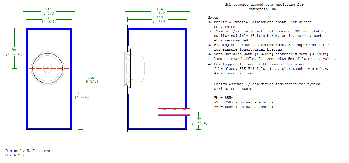

It would be great to get some freely available plans available, the only ones linked (on the MA site) are to the FH lite. Are there many around?
What for, the CHN-50? They do exist; here are a couple I did a year ago: https://www.diyaudio.com/forums/ful...-fostex-tb-dayton-seas-etc-2.html#post5770896 (although I urge people to look at alternative offerings by more competent designers). The attached is another, for use under the same non-commercial conditions as those listed on the linked thread.
One should be freely available, but the CHN drops into the A5.2/3 Mar-Kens.

Her teh free one: https://frugal-phile.com/boxlib/P10free/uMK52-0v9-plan-220415.pdf
Thanks Scott, Dave. I was pushing more for Stefan to add the free ones to the MA site, so everyone has access without digging through forums.
