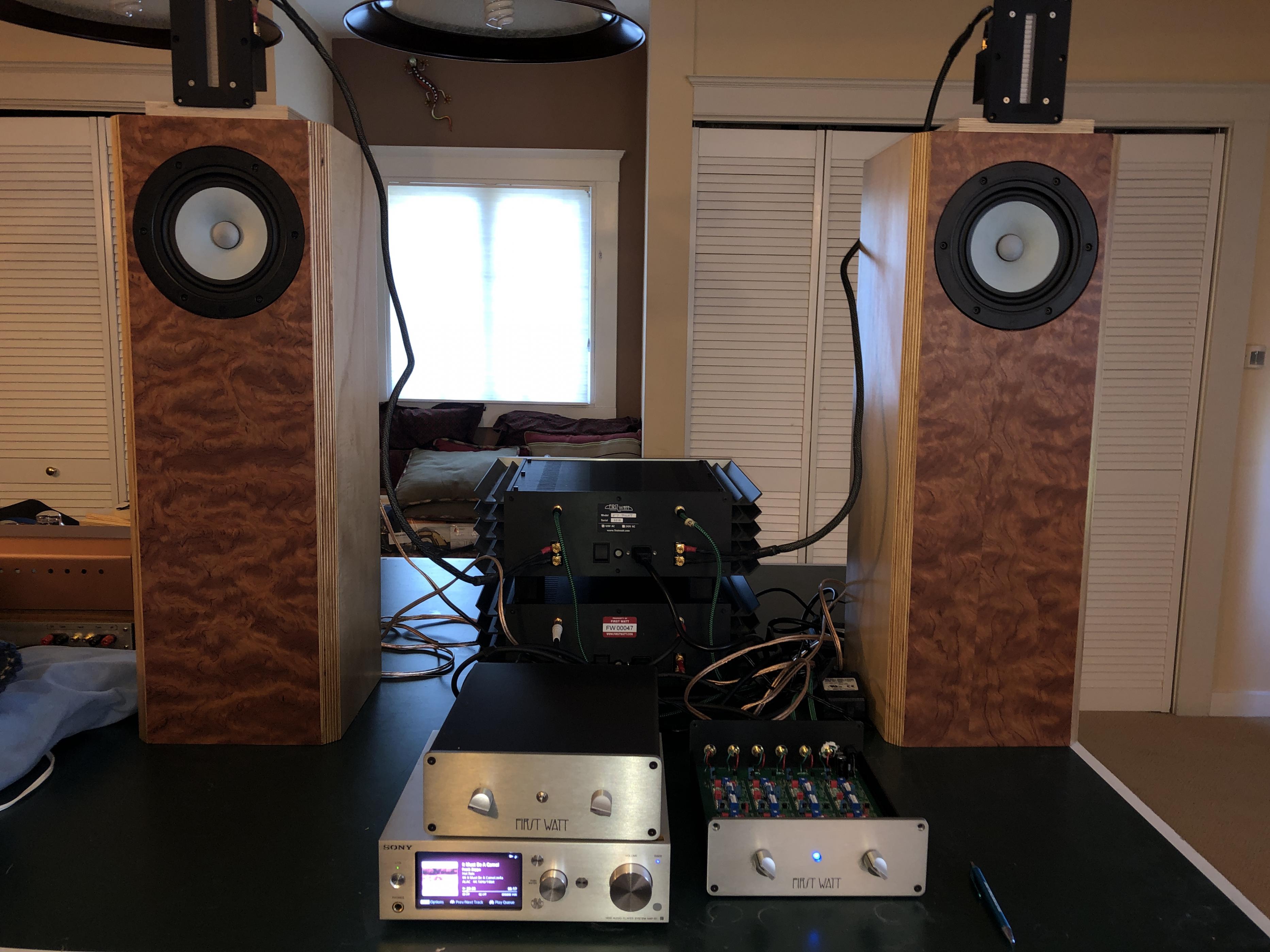

Here’s a little love, 12pw’s and a ribbon tweet, second order passive 8khz hi pass on ribbon...but we digress...
