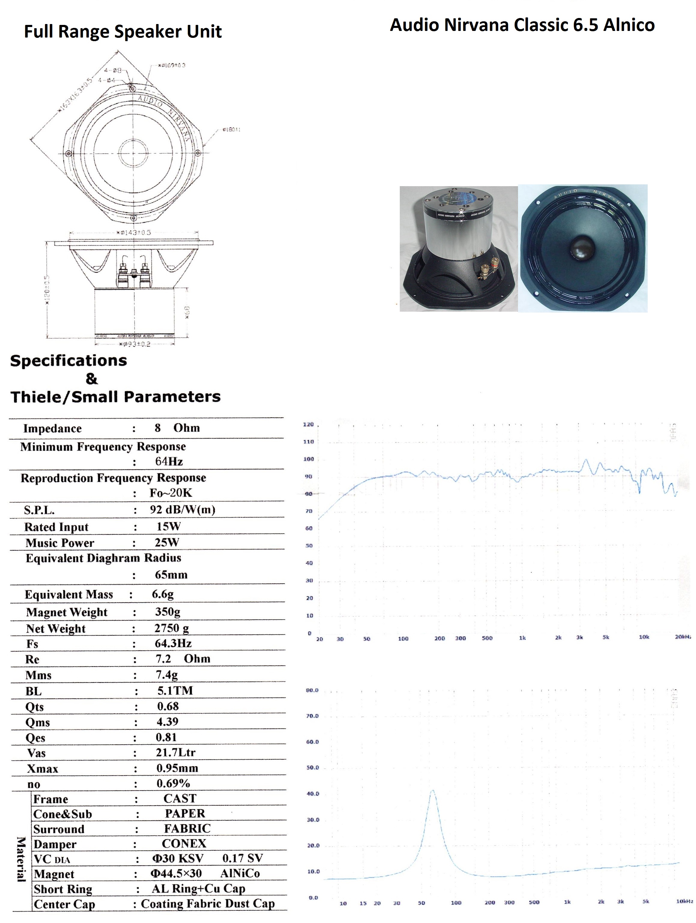

If I were to try one, based on specs I think it would be the Classic 6.5" Alnico https://www.commonsenseaudio.com/an6.5classicalnicospecs.jpg

About 20% larger than the 11MS, which would be roughly classed in the 5.75in bracket. The Alpair 12P is in the 6 1/2in size category however.
The AN have a higher efficiency, strong motor and lighter cones.
Well, as noted they're short-gap designs. That being said, a couple of points. Mms is not just the cone: it's the mass of all moving components, which means the cone, the front & rear suspensions and the voice coil. The AN drivers do not all have high motor strength: the AlNiCo versions are actually quite weak, and this is reflected in their high Qts and efficiency. Despite being about 20% larger than the Alpair 11MS, the 6.5 AlNiCo has a 1m/w rating almost exactly the same, and about 3dB lower than the Alpair 12P, which is in roughly its own 6.5in - 7in size bracket by Sd. That is with a short gap, short coil & 1mm point-to-point rated Xmax. In comparison, the 11MS has a 1-way Xmax rating of 8mm, or 16mm point-to-point. The 12P makes do with 10.8mm. You'd need to use the Super 6.5 Ferrite for the higher SPL, albeit with the same short throw and a low driver Q. As ever, YMMV.

I was thinking of the super ferrite. I will be missing low end, but probably fix that with a sub. I also noticed the very big difference with their alnico drivers. They say they are more smooth and go lower. But thats probably the weeker motor. Qts goes even more than dubble seems to me that smoother meens slower, less detailed.
