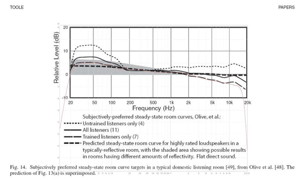

My ears follow the thin red line you see in the graph. Maybe it makes me special, or not. I don't really care.
Well, that dark-ish 10 dB skew across the range would be quite comfortable for me as well. And I believe the actual response from A7MS is quite close to that red line (while A7.3 is more horizontal). My graphs were nothing to do with absolute precision as I'm yet to figure out all the proper techniques, they only were intended for quick comparison between well-known A7.3 and newer A7MS which is still lacking comparative reviews as I thought relative precision is good enough for that. I was (desperately) trying to make that clear but... looks like it did not work well enough.

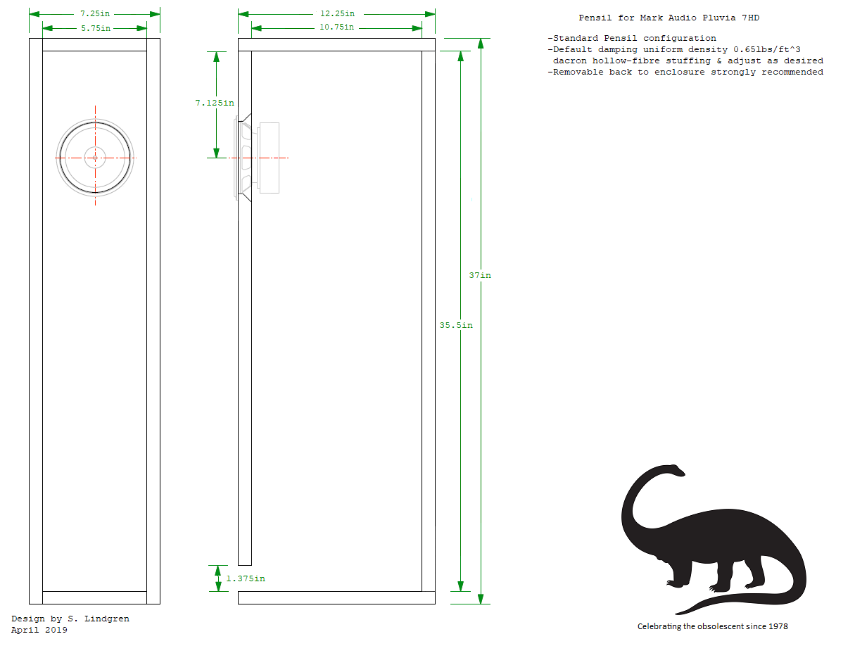

Does anyone know if the old box arrangements, Frugel Horn or Pensil's will work with the newer Pluvia 7HD?
They're fine in FH3; it was designed to be relatively flexible and accept drive units over a moderate range of tolerance. They will work in the previous pensil, but the 7HD has its own pensil design which would be a preferable option to the previous; with the exception of enclosures which have some tolerance deliberately built in at the design stage, it's better to avoid trying to use a drive unit in a box designed for another driver.
Sort of, they've got buried in my dumping ground thread; not sure if they've been drawn up properly. My sketches aren't exactly brilliant but the dimensions are correct. See post 48 in link below (should take you directly there).
