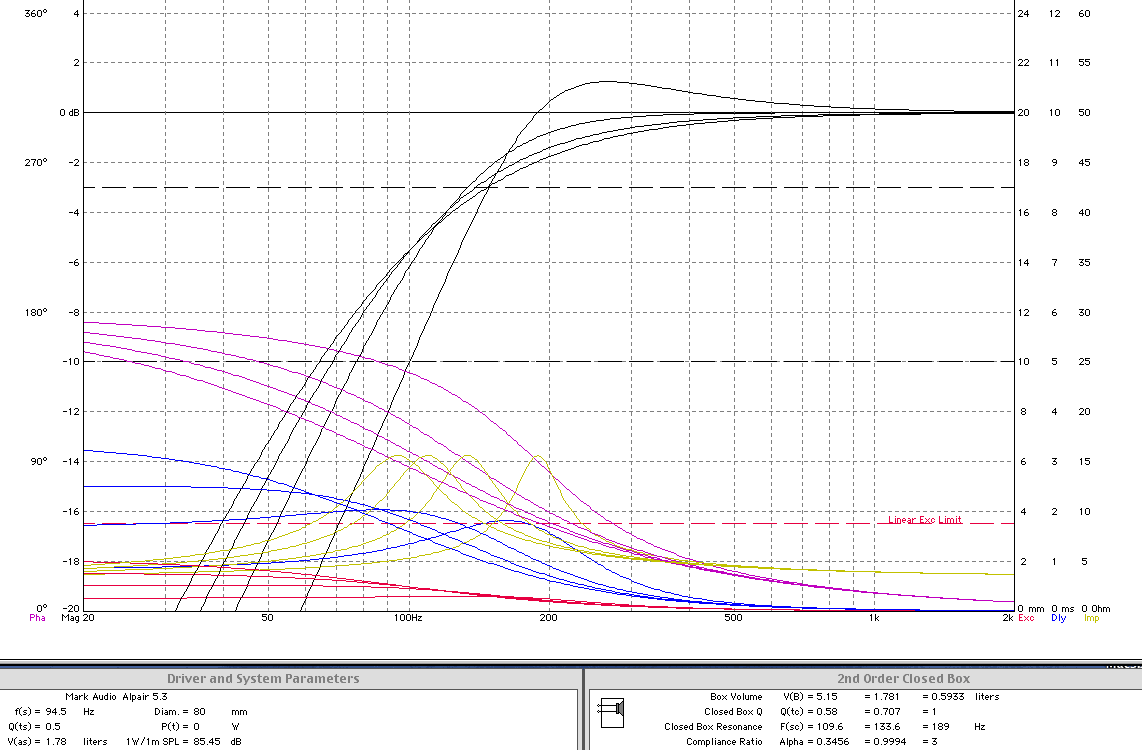

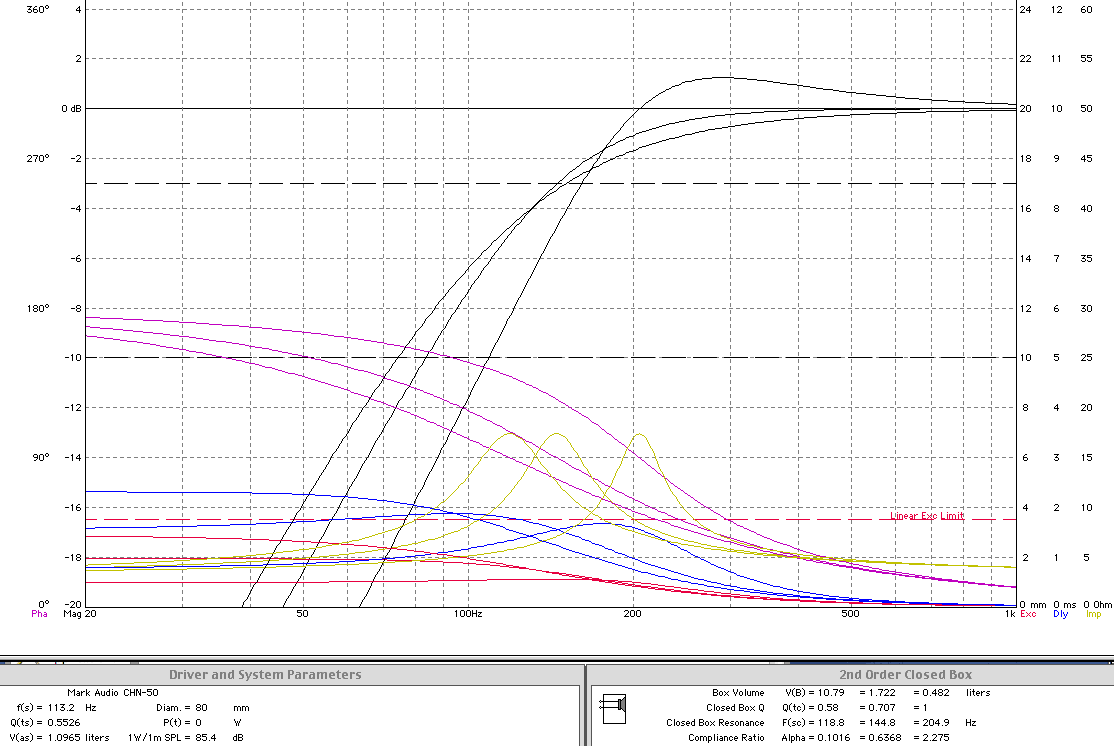

Hi all,
I have ordered a Pluvia 7HD metal coned, and also a CHN-50 to test.
Does anyone have optimum sealed cabinet sizes for these?
I have a very run in pair of the 7.3's to test against.
I now have two mics, ubs & Xlr. Will hopefully learn to take measurements.
7.2 HD - Sealed isn't too fussy, for max flat - .707 Q about 11 litre cabinet, but if that moved up and down a bit that's no problem really. Filling the space and making sure it is properly sealed is more important really. Should yield and f3 of 85 Hz
5.3 Alpair sealed size is a little more critical to keep it flat-ish - as the box is so small, optimal size would only be about a litre from a calculation which may be impractical, but even making it 10 litres doesn't really effect group delay adversely. The larger box will lift the f6 a little but both would have similar f3 at around 140Hz. Probably not low enough for sealed use then and using a passive XO to cross to a woofer WAW style would mean moving the crossover point up to a good octave (minimum) above Fb - you could get away with 300 Hz in the 10 litre box and 500 Hz in the 1 litre. I'd suggest that most boxes for these will be built with the bass hump tuning marketing depts like to give an impression of slam and then nothing below. For example a 10 litre ported box tuned at 65 Hz (4.7CM dia port by 9CM length) gives flat down to 100Hz then lifts 4 dB or so to 65Hz and then drops quickly to give an f3 of 55 Hz. All a bit one note but that is most like these small little bluetooth speakers/ home assistants.
Thanks Stefan, really helpful.
Perhaps my Alpair 7 cabinets (approx 11l) can be recycled!
My thoughts for the 5.3's are to get them in a small a box as possible, with the idea of them being in cafe's and restaurants, always with a sub to handle a bit of low end.
But it would be great to hear them in an optimum box, for comparison.

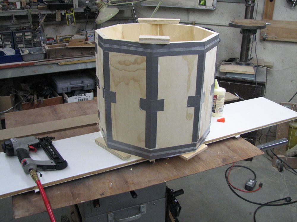

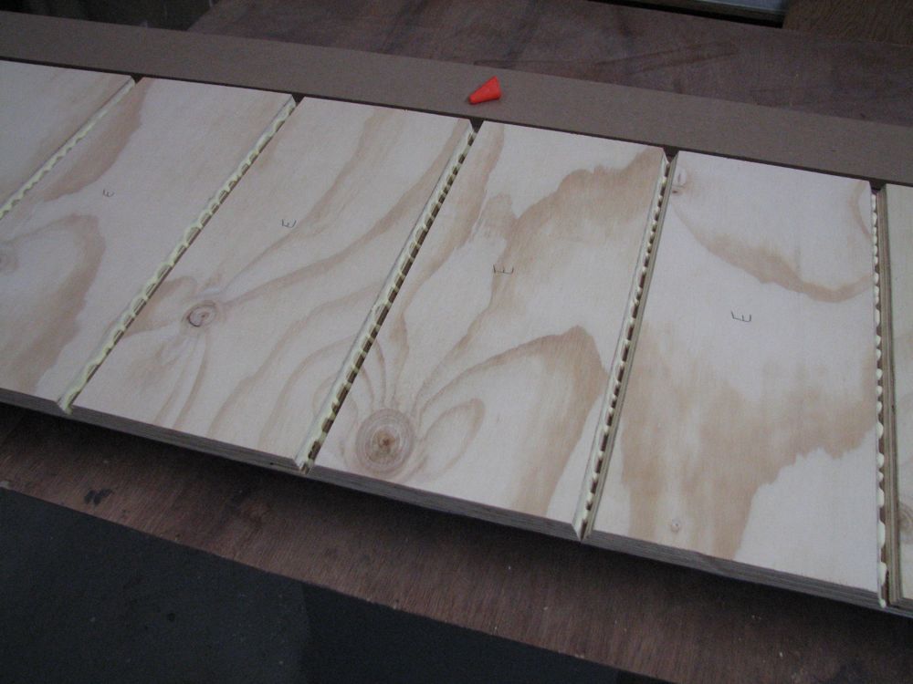

*Bugger my cabs are 8L sealed.
I guess I will have to make some more cabs, and see if my fancy new jig works...
I haven’t done the P7HD yet.
dave

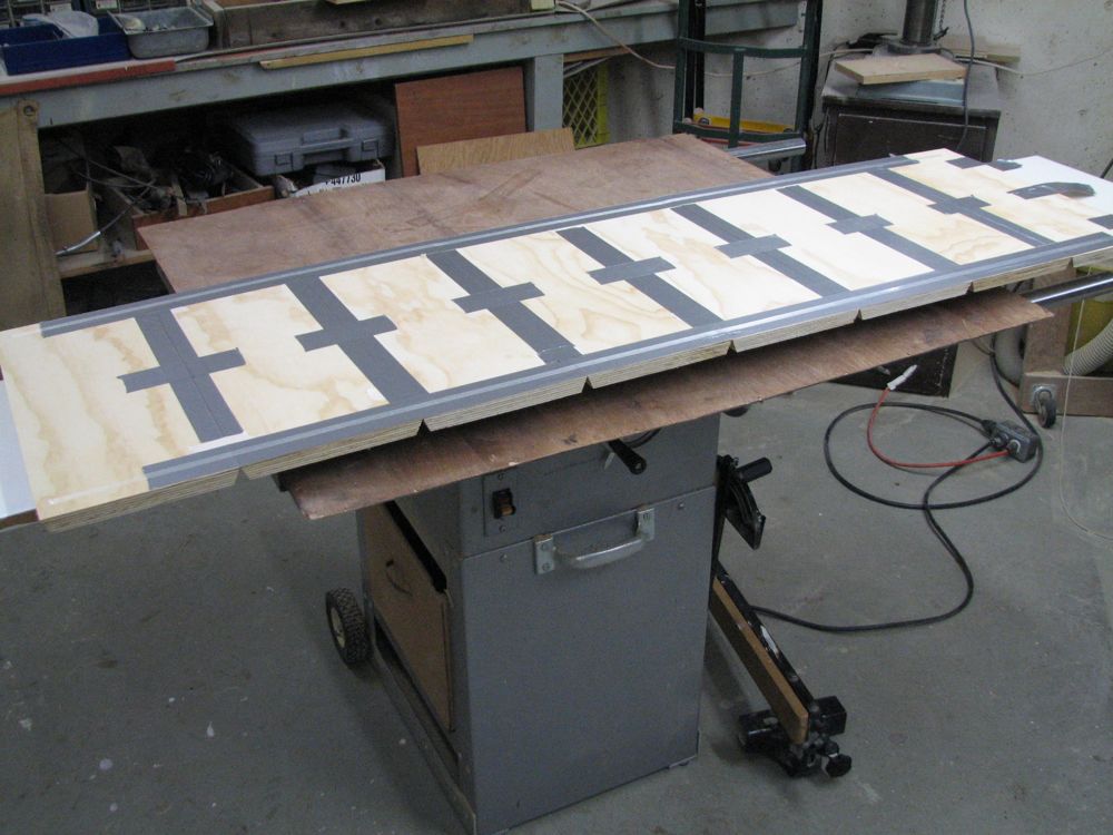

Can be done with a tablesaw, duct tape and fiberglass tape. Not quite a mitre fold as it's 8 pieces. It's old school but it works like a charm.Is you CNC accurate enough to be able to do mitre fold boxes?

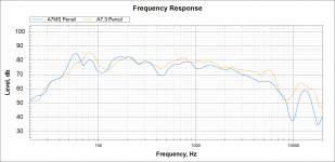

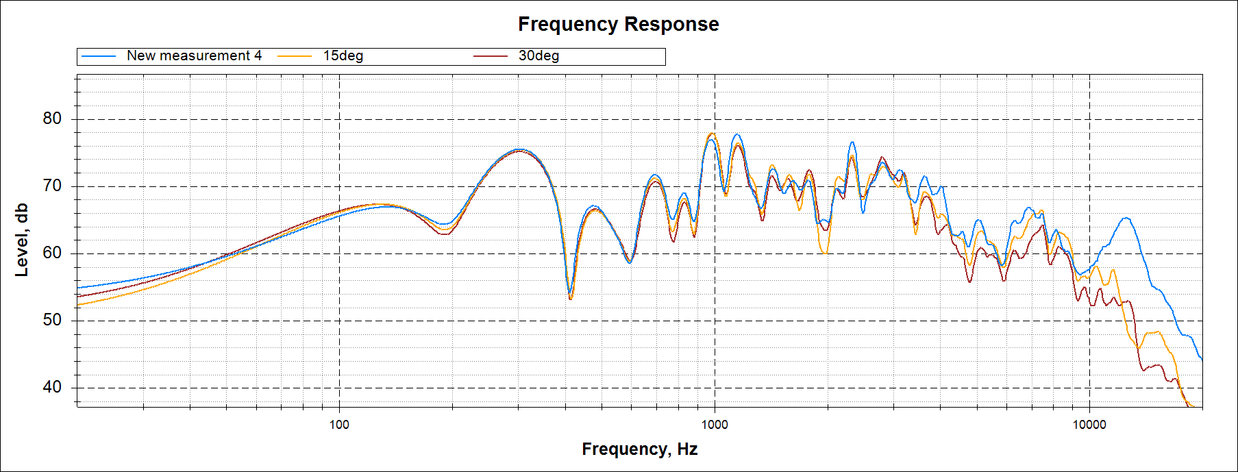

I've managed to take some quick 0-15-30deg measurements of 7MS pensils. Please take them with grain of salt as rig itself (iMM-6 + freeMLS) is quite basic (as well as my measurement expertise), so it's rather some relative data to give you guys general idea on how its off-axis performance could look like - for the lack of official data - than precise measurements of any sort. 1/12 octave smoothing has been used.
It was in the center of my media room (not heavily damped, just thick carpet), at 1m from driver center

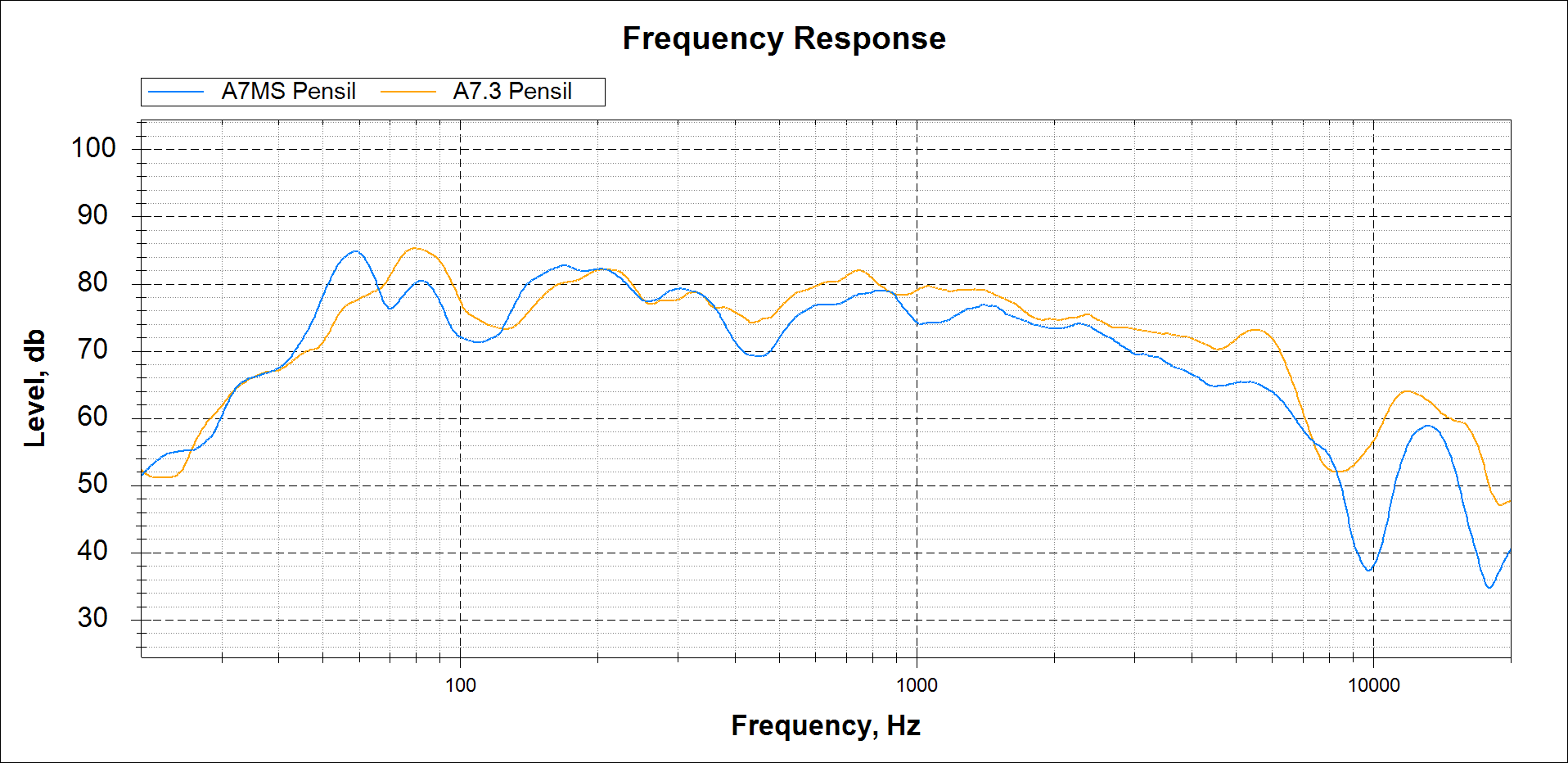

I decided to make some comparative measurements at my listening point. Basically it confirms my subjective impressions. It's completely unscientific approach but also gives an idea of A7MS vs benchmark A7.3. 1/3 octave smoothing is applied (its imprecise anyway so I've maid it easier to read)
Some people here could be well aware of this, but just in case - please keep in mind that high freq roll-off is natural thing happening at the distance as higher frequencies are getting attenuated more by the air. Recordings are mastered to accommodate for this and headphones are tuned to match this as well, so his response could be directly compared to headphone of your taste but not to the raw speaker data.

Thanks for the measurements!I've managed to take some quick 0-15-30deg measurements of 7MS pensils. Please take them with grain of salt as rig itself (iMM-6 + freeMLS) is quite basic (as well as my measurement expertise), so it's rather some relative data to give you guys general idea on how its off-axis performance could look like - for the lack of official data - than precise measurements of any sort. 1/12 octave smoothing has been used.
Is it possible to gate the signal in freeMLS? It would be nice to see the response without reflections. And if it's not too much to ask for I'd also like to see 45 and 60 degrees off-axis as well.

High frequency attenuation is not usually noticable in a home environment. How large is your room? And the dips around 10 kHz seem weird.I decided to make some comparative measurements at my listening point. Basically it confirms my subjective impressions. It's completely unscientific approach but also gives an idea of A7MS vs benchmark A7.3. 1/3 octave smoothing is applied (its imprecise anyway so I've maid it easier to read)

That driver needs a tweeter.
Unusable past 2.5kHz.
Not true. That's just what I was trying to explain. Look at your headphone response and add tweeters there as well.
First, why would I want to simulate my headphones while listening to my speakers?
Most mixing apps do the exact opposite, simulate a speaker setup when listening with headphones.
And the only speaker setup I've heard (so far) that sort of emulates headphones are line arrays.
Second, my headphones are EQed flat-ish, with a gentle down curve of 5dBs between 300Hz to 15kHz (can't hear past that anyway).
But if you like the Beats headphone sound, then it's your preference, and as long as you are happy, then it's all good.
Enjoy your Pensils.

My current favorites are HD58x from Massdrop/Sennheiser if it makes any sense to you. Yes I can't bear extremely sharp sound of say DT880 ("Beyer Peak") which some people consider "detailed" and "airy" - to me they are just piercing (most of these guys admitting though they can't listen them for more than an hour). But I honestly can't imagine any person who can stand with truly linear response from headphones, you must have really special hearing. And that makes your ultimative conclusions a bit confusing for average person.
I'm preferring A7MS over A7.3 finding latter a bit unnatural due to excess of highs. That alone makes them usable for at least one person in the world so your definition of them being unusable is basically not valid. Also I haven't heard any multiway speakers which I could describe as natural sounding after going full-range for a first time 10 years ago. And yes I do remember the era of people V-shaping their boomboxes' 10-band equalizers "for better sound". With my gear, I do not eq anything, why do I need to distort the sound which is perfect to my ears as is? Enjoy your EQs and tweeters.
