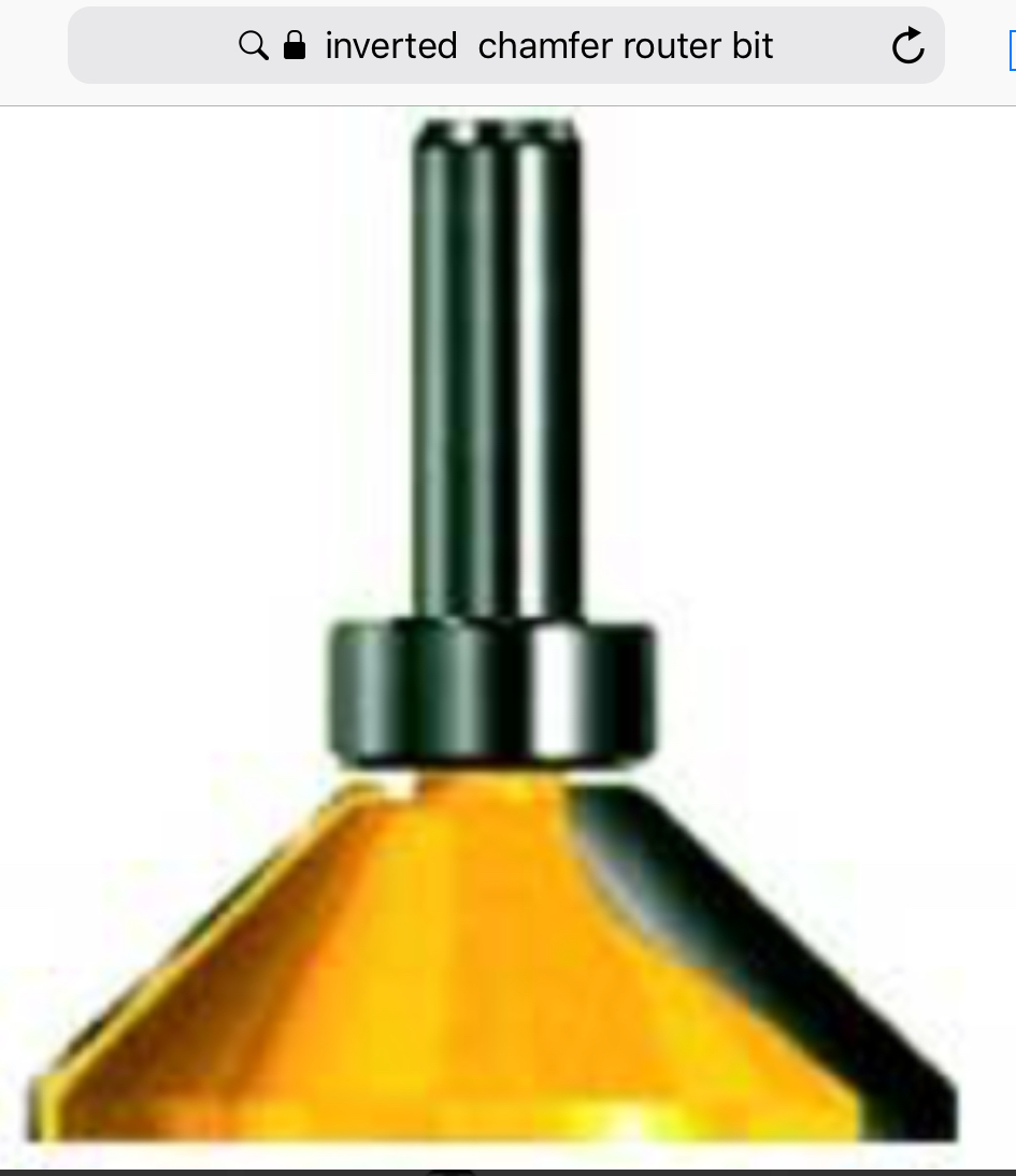

I didn’t make the cutouts until after I’d assembled the cabinets so I’ll have to source some kind of “reverse” chamfer cutter.

...so I’ll have to source some kind of “reverse” chamfer cutter.
A big a$$ rasp (with a round side) is the easiest way to do this. It doesn’t have to be pretty.

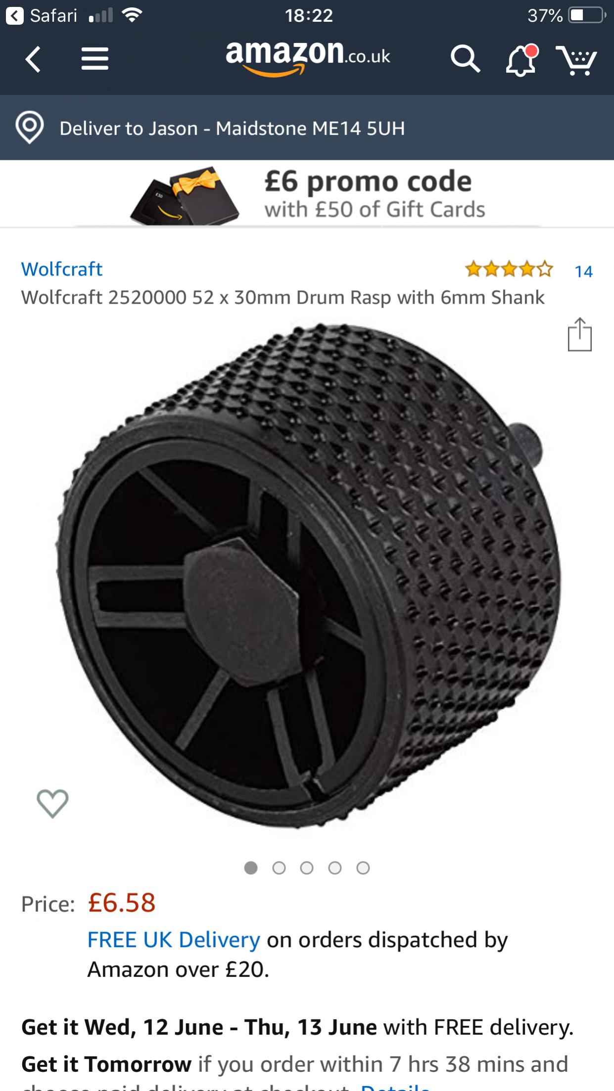

Googling “rasp” turned up this drum rasp which would also be handy for easing out, when you don’t have exactly the perfect size hole saw.

Cheers Dave, the only problem with that is, I can’t see the “on” switch or where the battery/power cable plugs in, surely your not suggesting I remove the material manually are you? 😉😀
The rasp is a lot less expensive than the bit you pictured and with many more uses. It takes about 10 min to do a pair of driver holes… more if you sand it after to make it prettier (but no more effective — there is an argument for an advatage to leave it rough,
