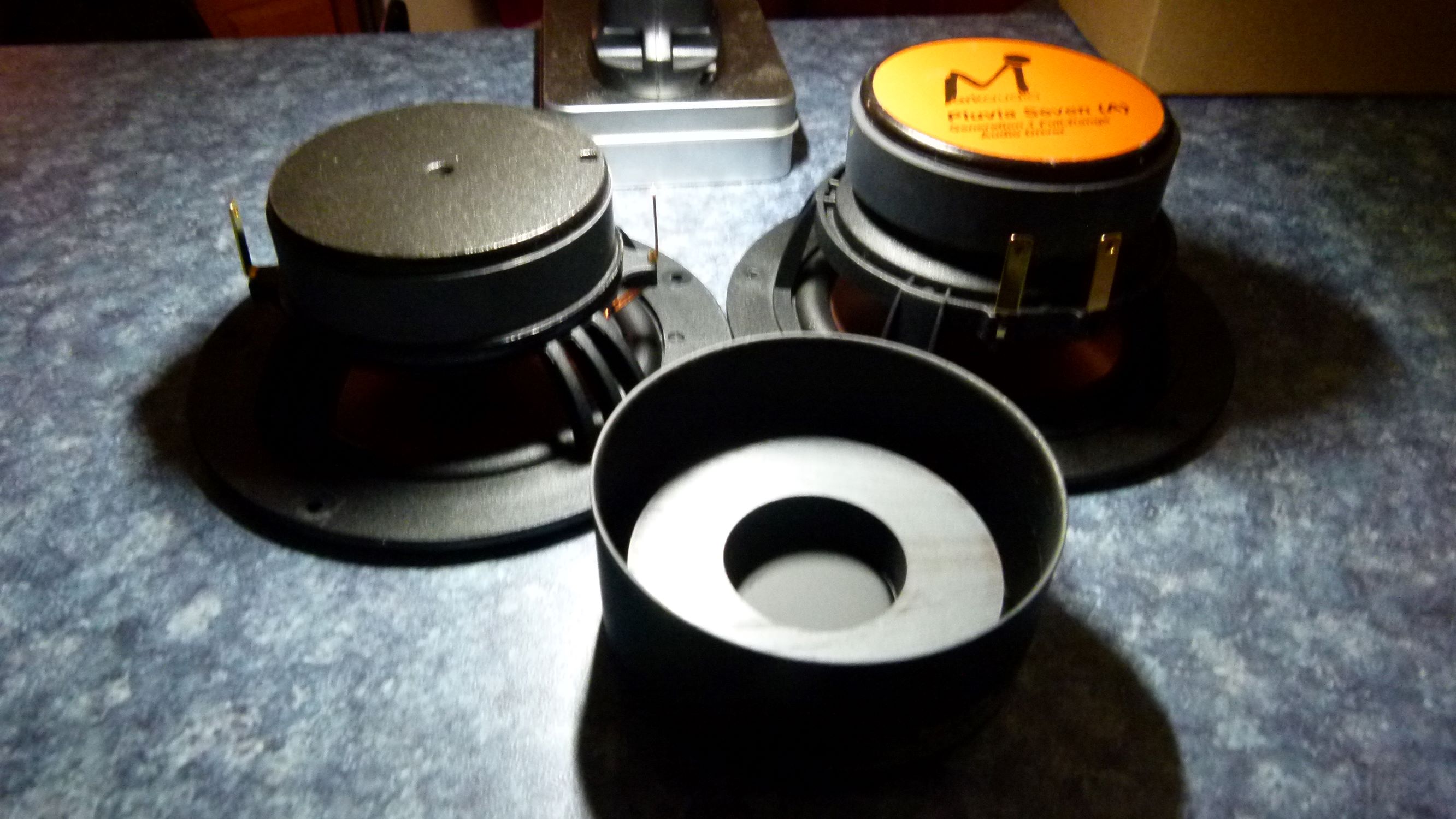

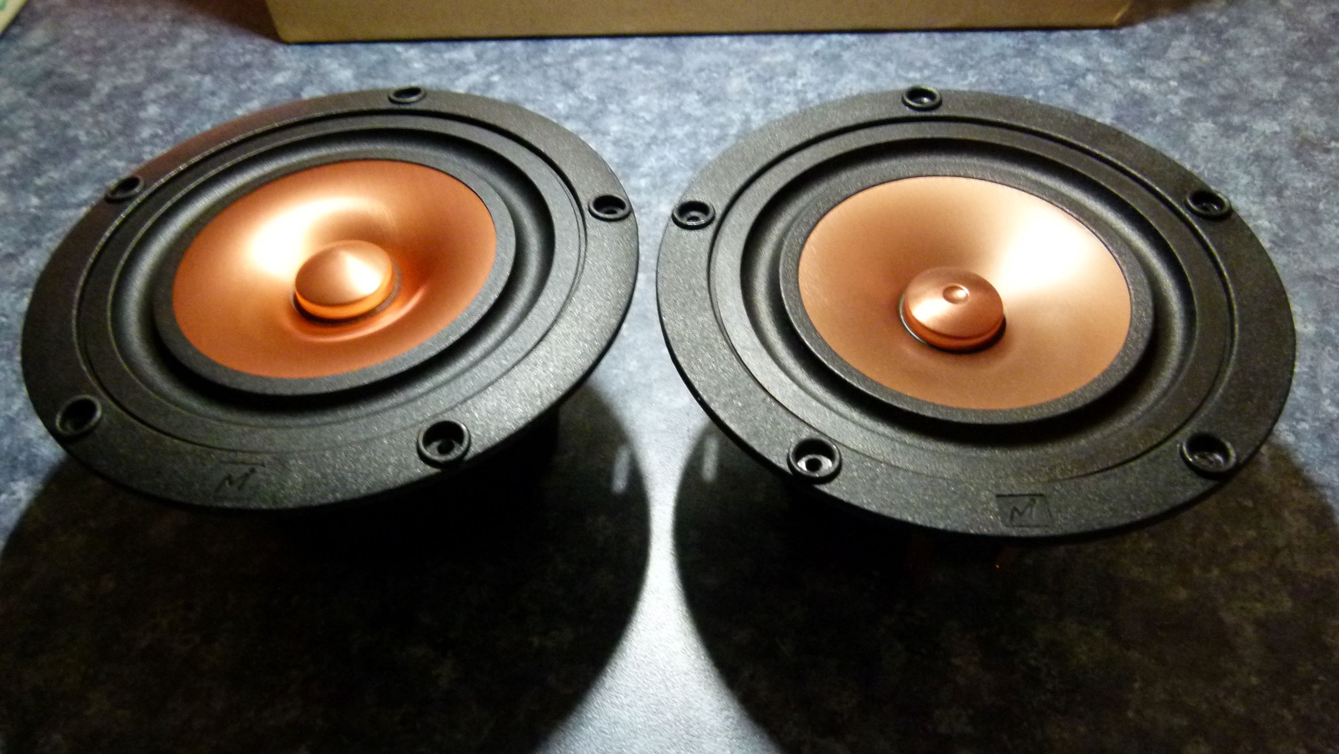

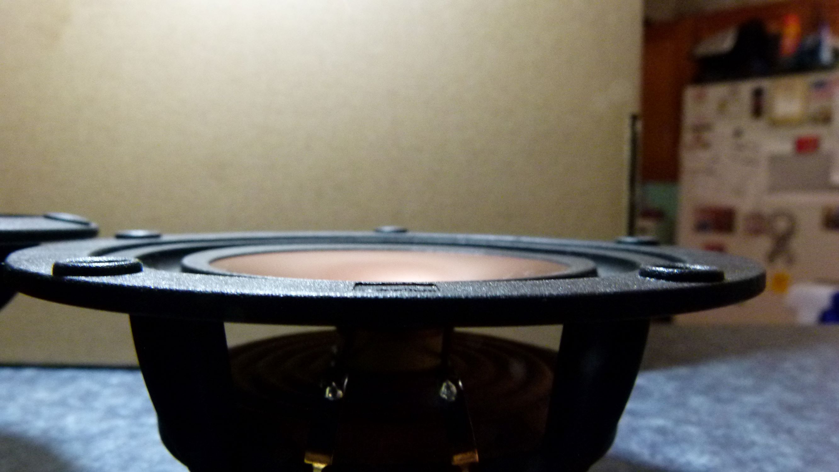

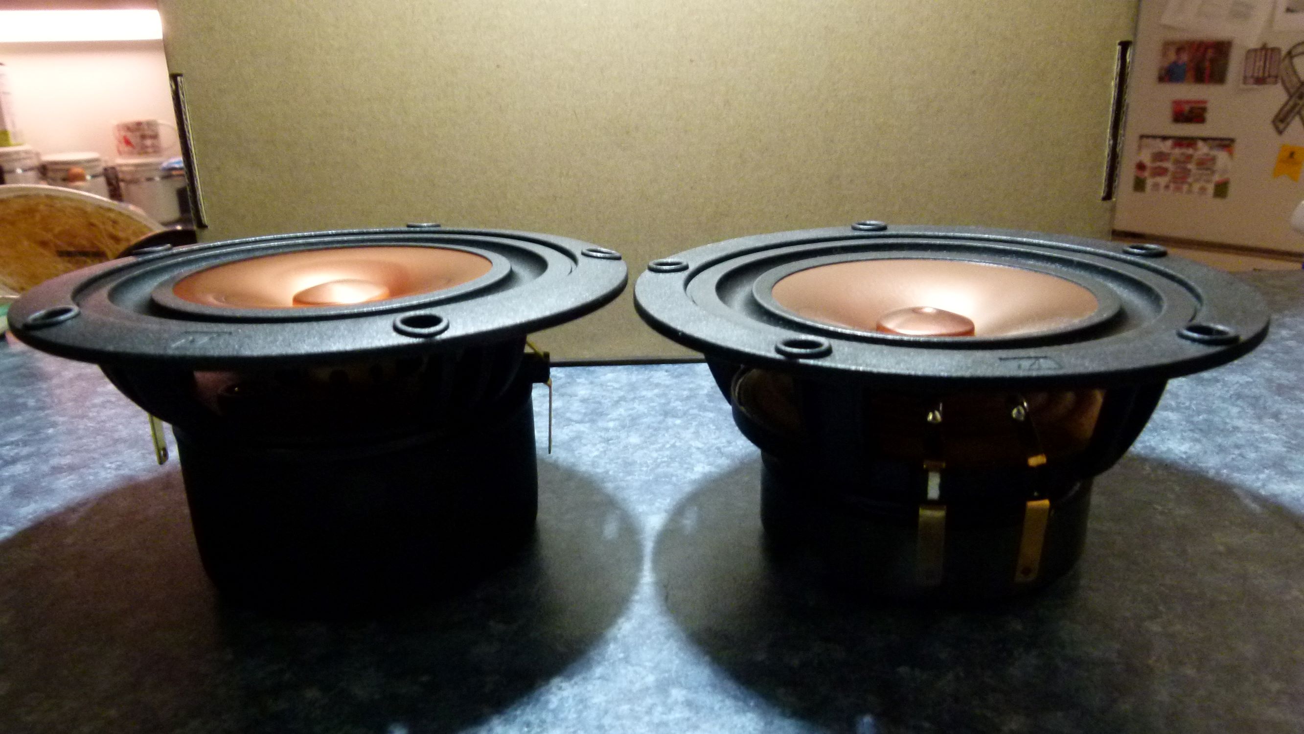

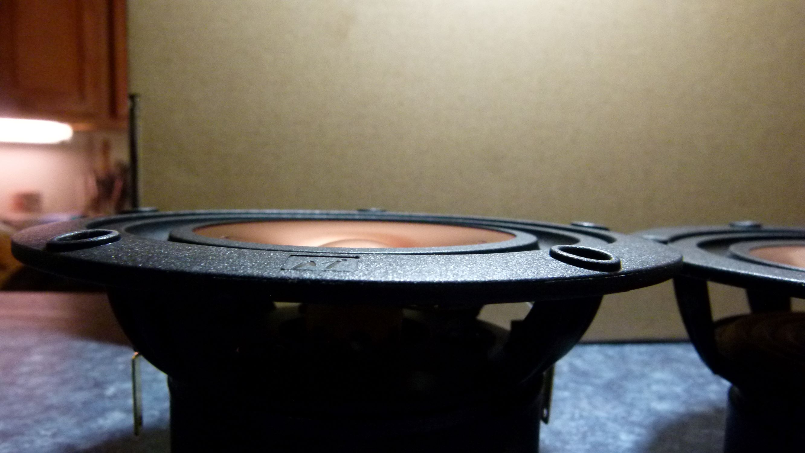

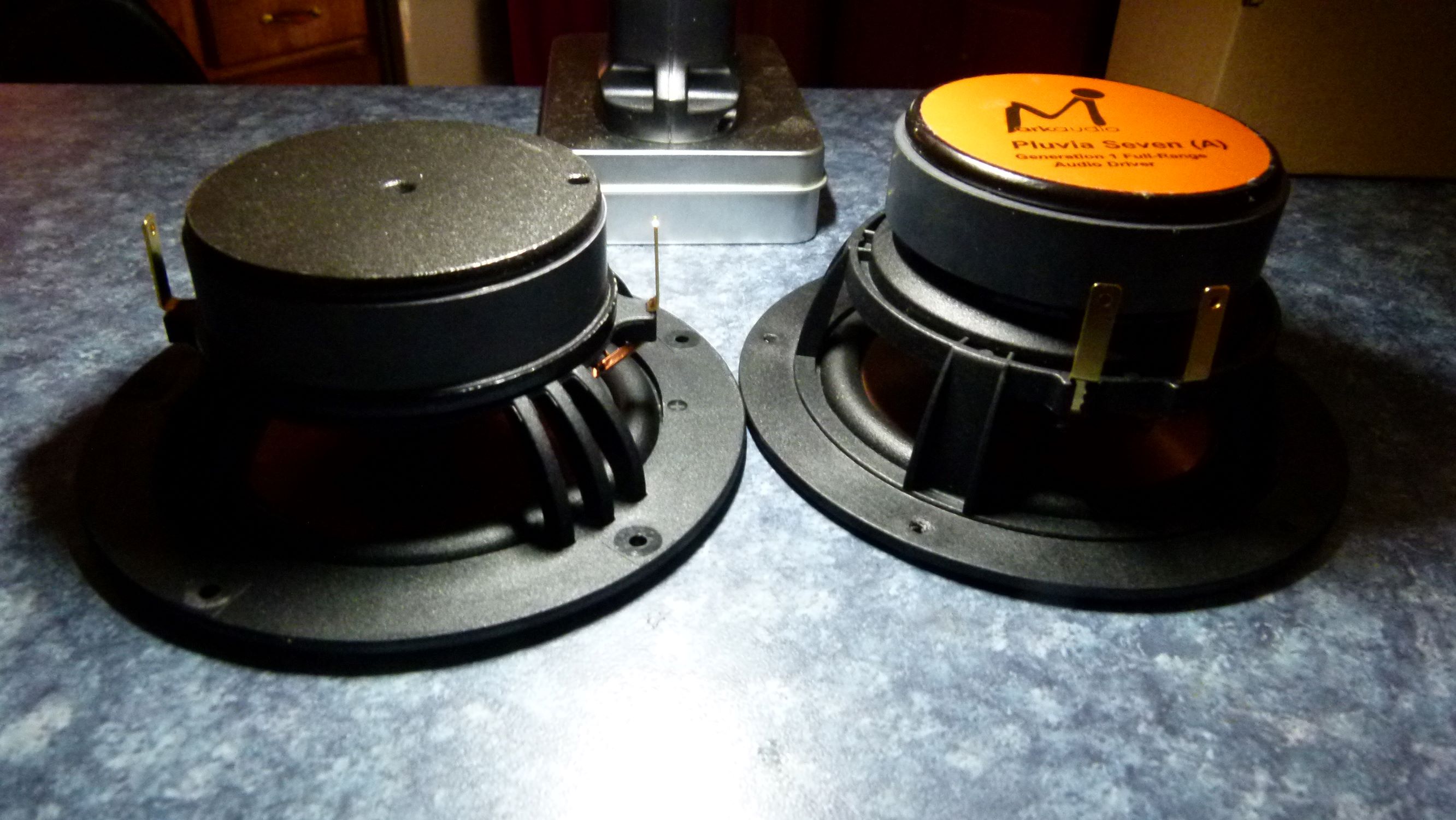

The basket is more shallow on the 7MS. The cone is more rounded on the 7MS, it's not just a straight conical shape like the P7, definitely more curvature. The dustcap is a tad longer, maybe by 1 mm on the 7MS and much closer to the top of the driver and obviously no dimple on the 7MS. Also, the actual 7MS color is a brighter shade of 'gold'. The light reflecting off of it really shows the shape of the cone nicely.
The 7MS is about .5LB heavier due to an extra magnet. Originally I had thought it was a longer magnet, but when I was taking these pics I noticed the rear cover wasn't properly aligned so I tried to mess with it and was surprised it came right off. Putting it back on and properly aligning it was no problem. It probably got shifted during shipping. No big deal. So here are some pics!

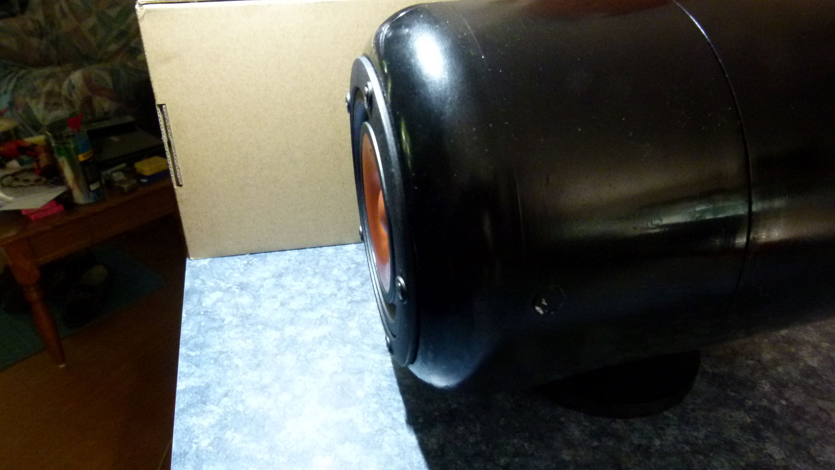

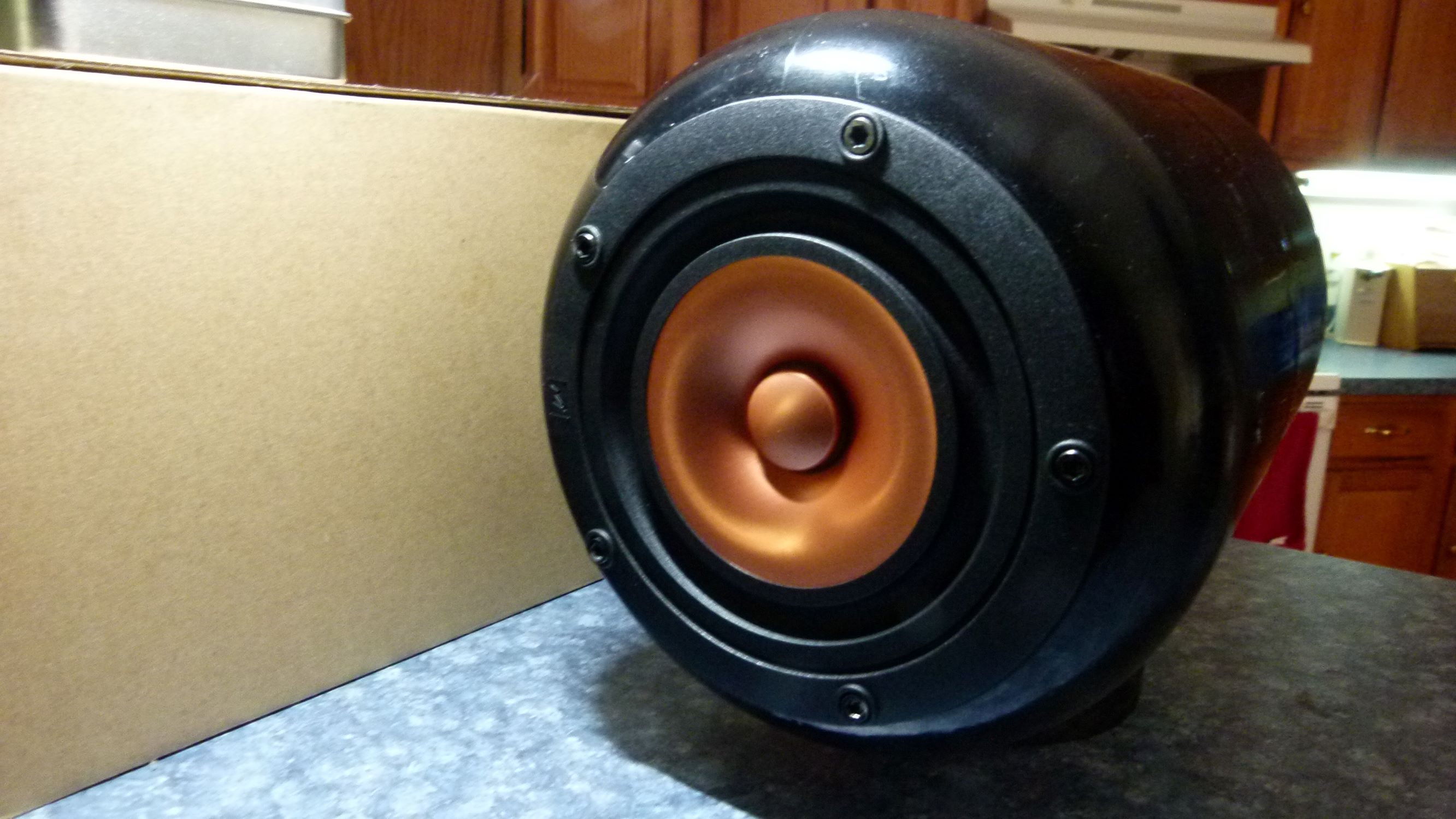

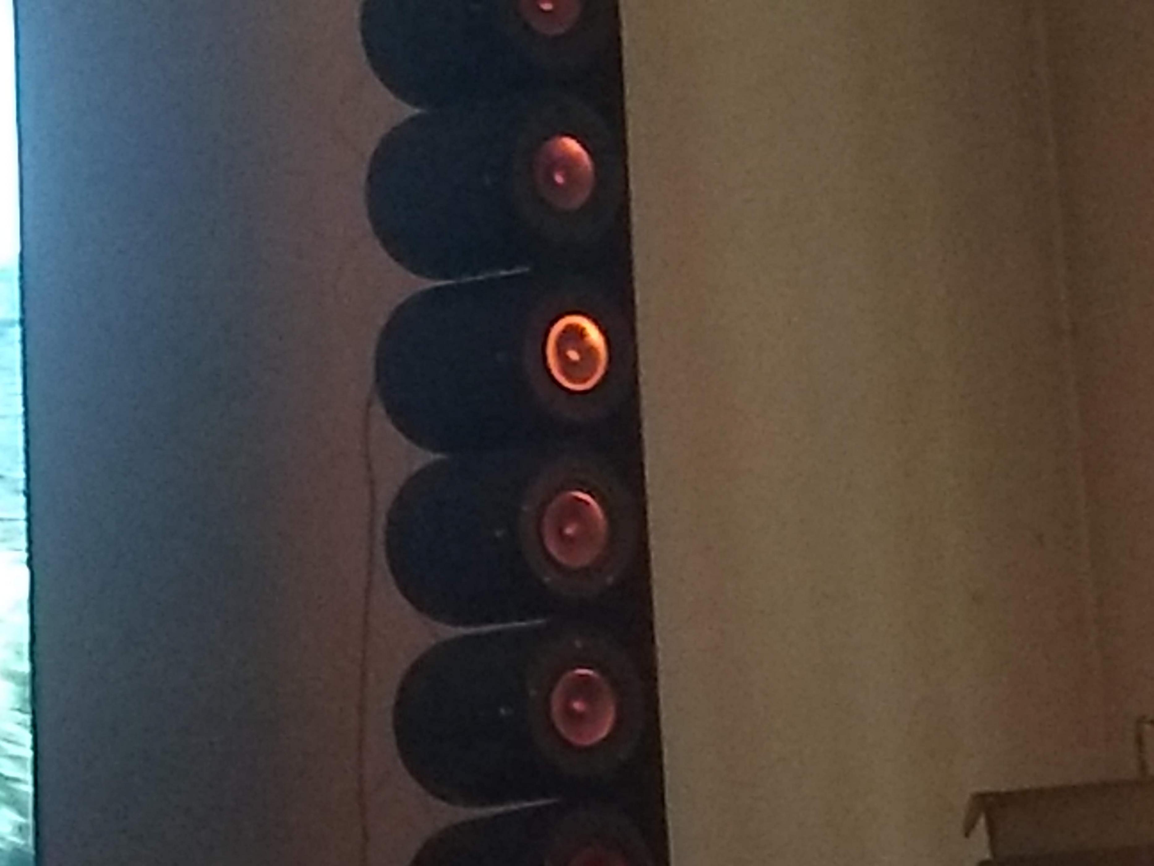

Here is my current setup using P7's...
Some of the more critical tests I'd like to do on the P7 and 7MS are the off-axis tests using white noise. This is especially true because I know for a fact the off-axis of the P7 is very impressive, so the 7MS should be even better. Why the data sheet does not spec off-axis response, for any Markaudio driver, is beyond me. Another test I must do is to compare the 7MS with and without the additional magnet supplied. Expect many pics in the new thread!
Visual: P7's vs 1x 7MS at dusk.
