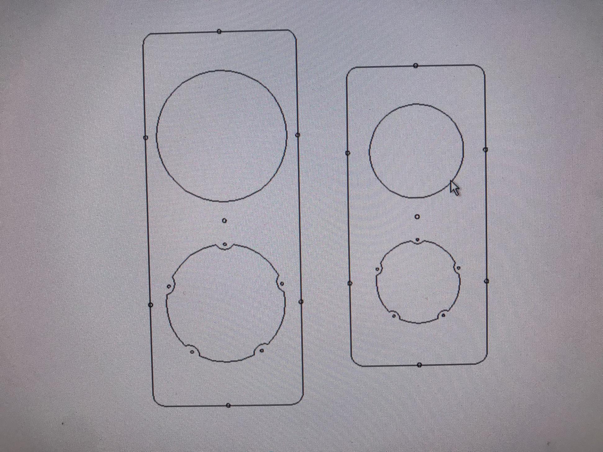

I have been swaying away from CNCing cabinets mainly due to the cost and the pain of logistics. So I am CNCing some jigs instead.
So for me and if anyone else wants some I have made a really simple jig for routing the new rebate and cut through for the ms series. This allows for our super open back design with much less material that a simple hole to disturb the rear sound wave. Pilots holes for the driver in there too.
One for 7ms & 11ms. The small holes on the outside will be cut half way through when the shape is cut out, which should provide a nice easy way of centering the jig to pencil lines on the baffle, and to re-centre the jig for the second cut.
From 12mm Birch ply.
£25 + shipping. I should have a few in the next week/two.
Dm if anyone is interested.

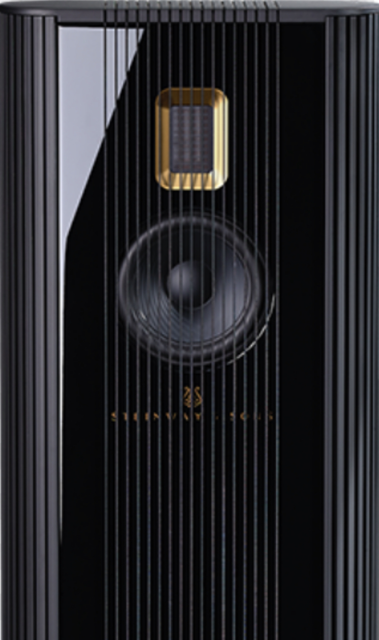

Ha ha, yes, I do get that & it would be lovely to go with the A11ms all around for aesthetic & sonic reasons, I will probably make grills for them eventually though, I like the piano string effect used by Steinway Lyngdorf.
Yeah, it's nice to see the drivers. Markaudio Sota's designer Andrea Ponti did similar with very sheer material for the Viotti series
Ooh, I like that look too, I think the metal MA cones look cool (especially the curvy MS cones) & it would be a shame to completely cover them.

...for routing the new rebate and cut through for the ms series...

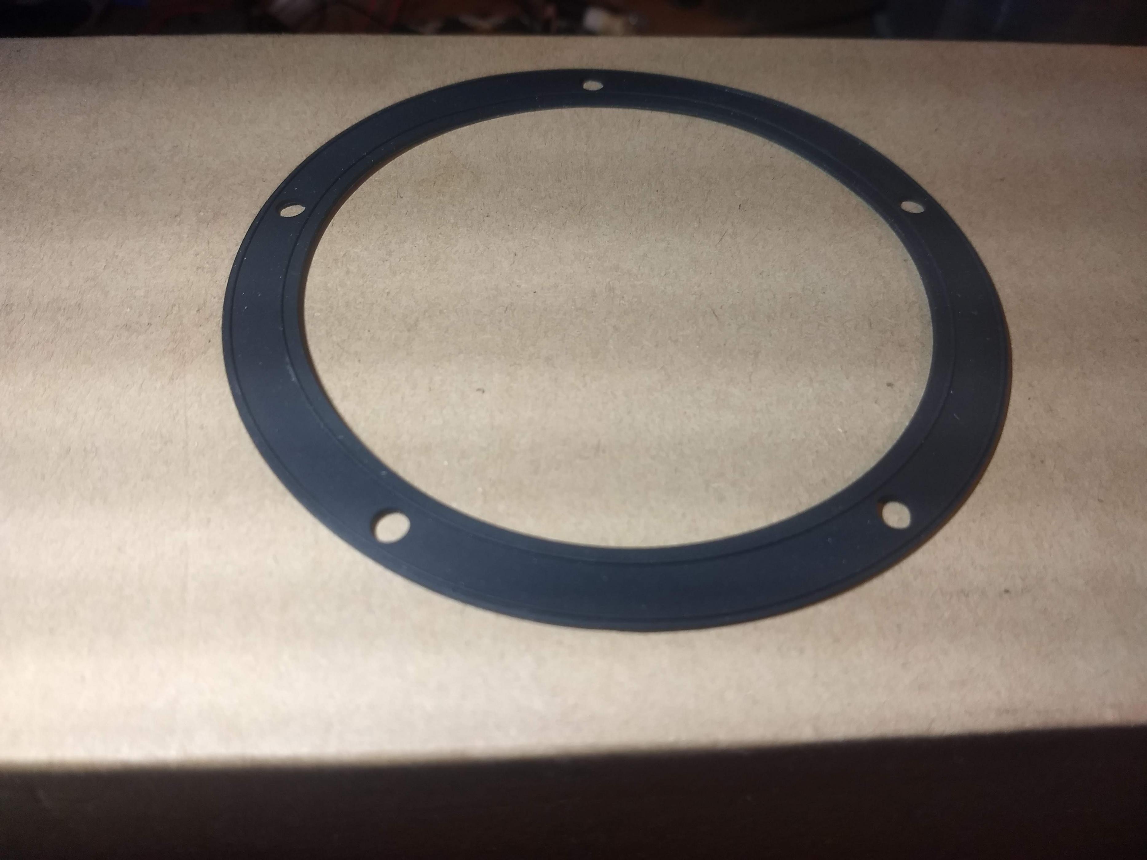

Is the shelf for holding the driver wide enuff so that both of the ribs in the super gasket are supported?

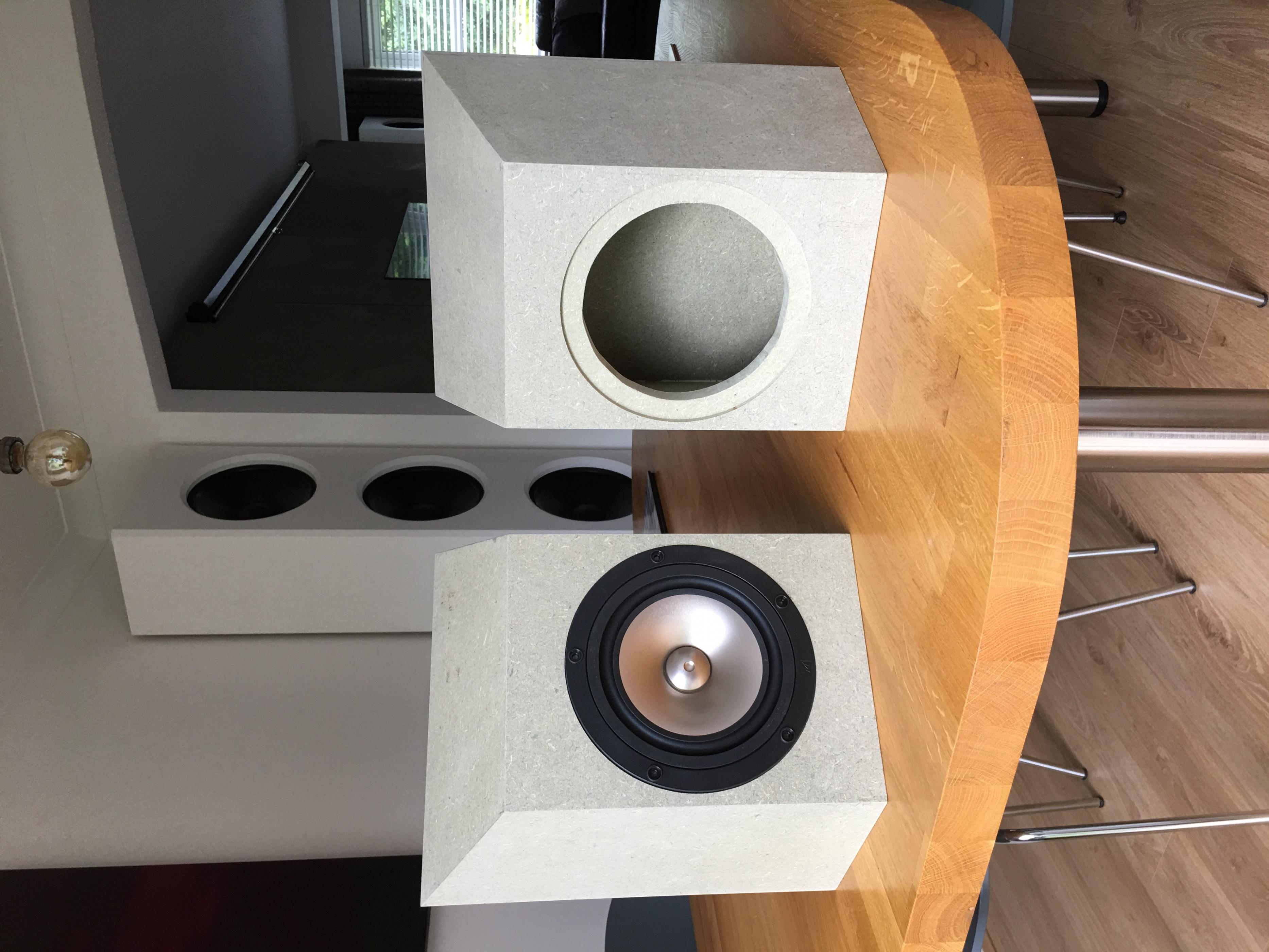

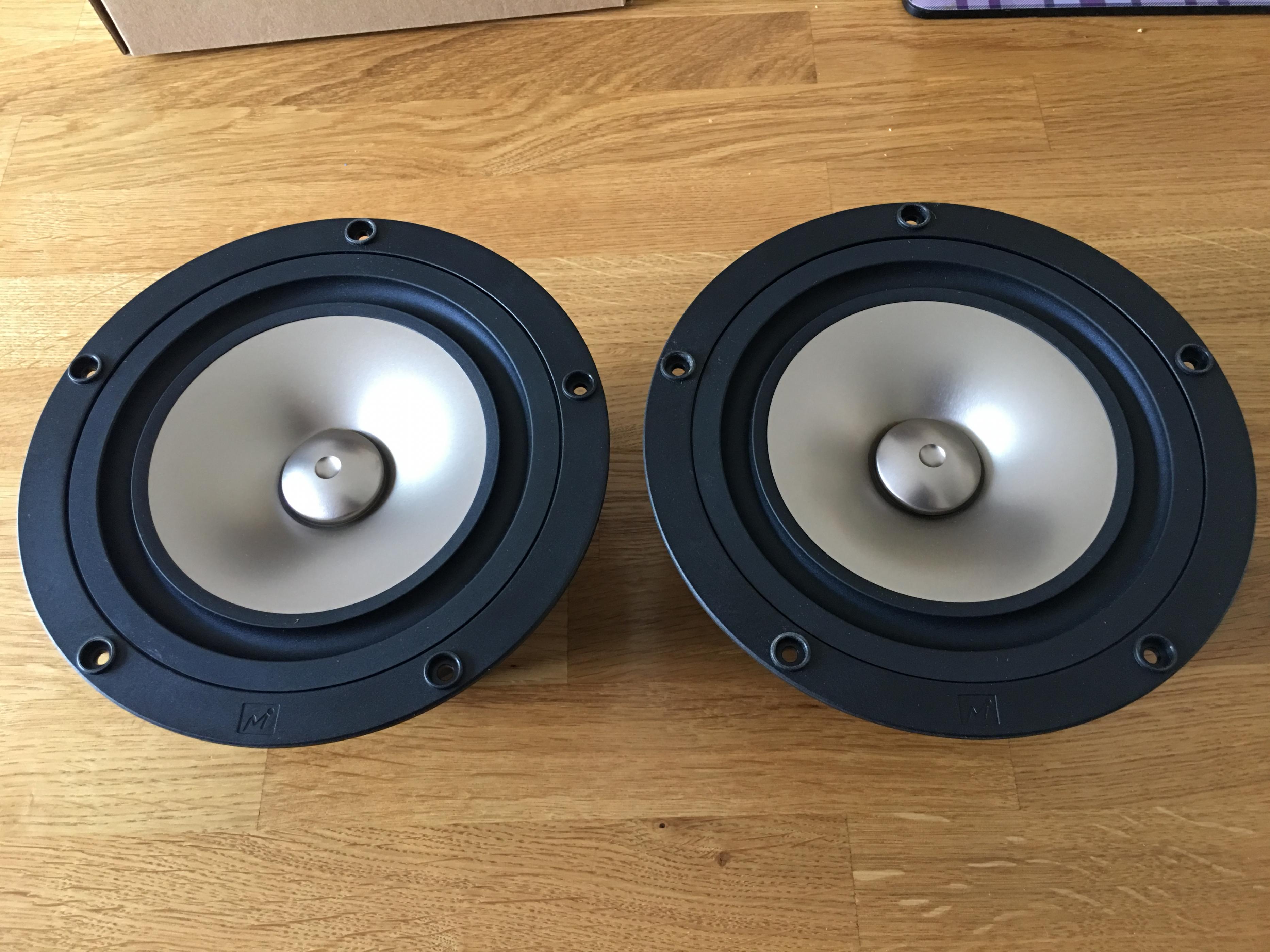

After thinking long & hard which route to take for my surround speakers, I ended up going for the Pluvia 11 & when funds allow, I’ll demote them from side surround to back surround duty & go with another pair of A11MS for sides.
Arrived in perfect condition, big thanks to KJFaudio & all who shared their very valuable experience/expertise
Jason,
Nice looking drivers those. 🙂 Tell us more once you've got them up and running. And any build pics are welcome too. Have fun!
@dave, I'm not sure, it was our approach with the 7.3's, which had a ring, is the gasket on the new series different? Being CNC'd later, but they are just extra's on another project so not the end of the world if they need to be re-made.
I haven’t looked at the gaskets on the new MS drivers, but all the old (larger) Alpairs had a sealing gasket with 2 rings of bump (like the seal that failed on the Space Shuttle booster). Both need to be loaded against the mounting shelf.
dave
dave
They've the same features as Dave describes, at least on the 7MS which I took a pic of.I haven’t looked at the gaskets on the new MS drivers, but all the old (larger) Alpairs had a sealing gasket with 2 rings of bump (like the seal that failed on the Space Shuttle booster). Both need to be loaded against the mounting shelf.

Project Pluvia 11 side surrounds ready for paint 🙂
Don't forget to chamfer the insides of the driver mounting holes. 🙂
