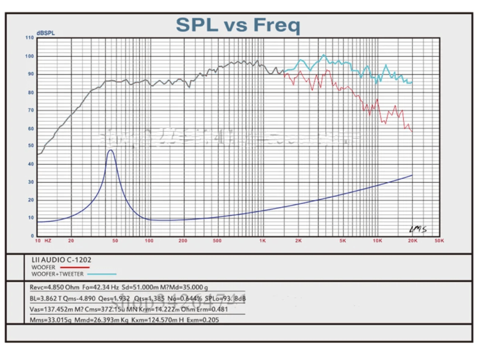

A +10bB rise from 200Hz to 700Hz? That would hurt my ears so much.... We haven't even started dealing with baffle step!
I've seen school PA systems look better than that! 🙂
So, basically, if one had to tame that with EQ, it would become a sub- 80dB driver. Yikes.
And sure, running the tweeter without any kind of cap (or complete XO between the tweet and woofer) is a great way to sell more coaxial drivers!
Once you blow the tweet, you need to get another one! Great marketing strategy! 🙂
Every company I know shows impedance curves for the woofer and the tweeter in a coax. Strangely, not Lii....
There's a 90 day warranty from AliExpress, so I doubt they intend for the tweeter to blow in an effort to sell more units...
Well, it's either the tweeter will blow, or the distortion will be off the charts.
Can't break the laws of physics.

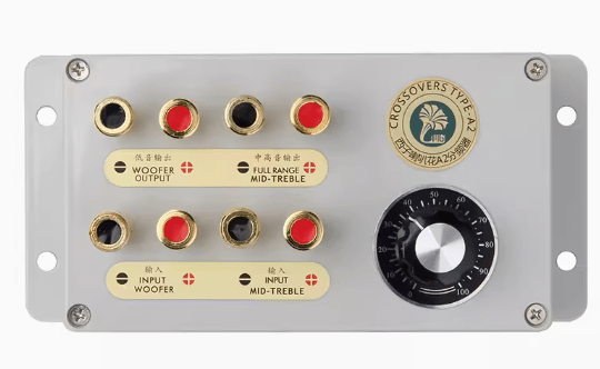

I don't know the C1202, but i know Lii Audio sells a crossover box with a pot to adjust by listening the speaker (after the baffle is built). I don't think this driver with separate terminals can be used without crossover.

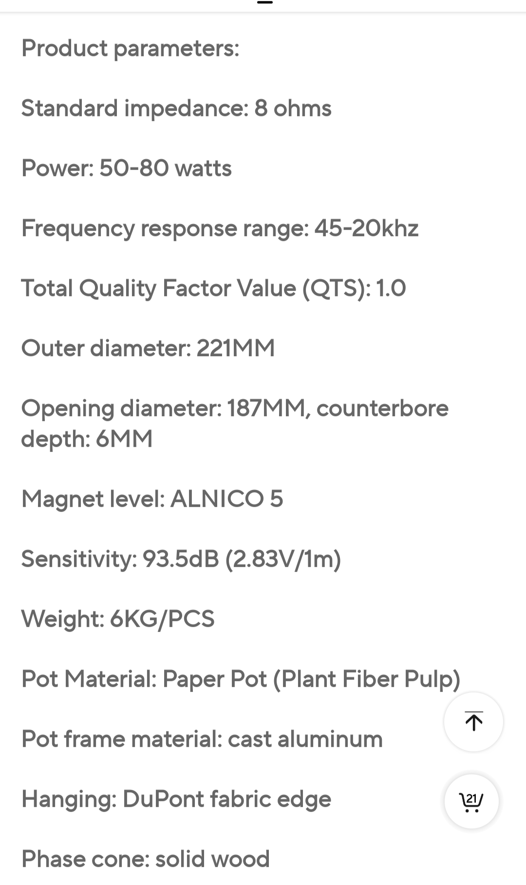

This vendor claims it's expressly designed to operate without an external crossover: https://www.aliexpress.com/item/1005004493146259.html
From that link, I see:

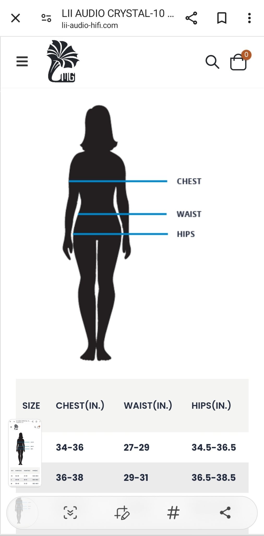

The Description part is just a bunch of words put together to sound cool, but really doesn't offer anything. Guess they didn't bother getting someone to do a better translation.
In the Instructions, they mention they have a "built-in simple splitter processing." So, they put a simple cap in there for the tweeter.
They also mention not to listen too loud, or as they eloquently put out: " Try not to be too loud when listening to the audition, because the short circuit of the low frequency will cancel out the sound a lot, and it is easy to overload if the sound is too loud."
So, as I get it, the first sentence says the bass will be lacking (obvious from the response graph), and the second one says it will distort quite badly.
For the price they ask, I would expect a lot better.

That has two inputs, so it looks like it would be used for a biamped system, with passive filters on each driver. My guess would be the tweeter of the C1202 has a capacitor on it and comes in where the woofer begins to roll off.I don't know the C1202, but i know Lii Audio sells a crossover box with a pot to adjust by listening the speaker (after the baffle is built). I don't think this driver with separate terminals can be used without crossover.
I would say chinese are on par with japanese when it comes to translation...And I don't know any good translator software for chinese
This website is like a trial i guess, a default template to edit. In china nobody use website (only apps) so i guess it was outsourcing.
For now i would recommand using aliexpress. I figure out at least for France that the shipping improved quite a lot, before you were waiting 1 month and wondering if it will arrive one day...
If one is a business, why would they rely on software translators to populate their website with English content? At the price they charge, I think they can afford a real translator. Google Translate is cute when you come across a page you want to read in your language, but a business selling expensive toys?I would say chinese are on par with japanese when it comes to translation...And I don't know any good translator software for chinese
It gives me the impression that if they go, "oh this translation seems good enough", then I would feel they might apply the same attitude towards their driver productions, "oh, it looks good enough."
