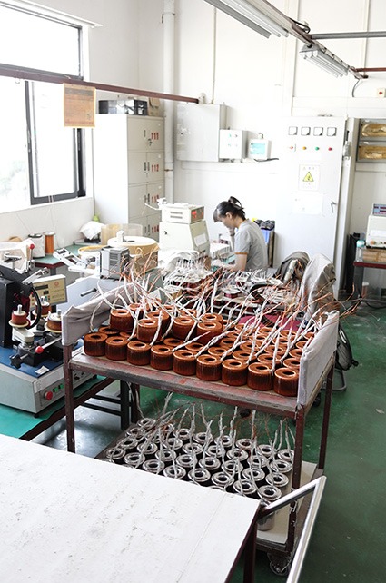

I am not sure I can visit Lii Audio factory on my next trip, he rightfully seems not so confident to show it to strangers, even if i sign an NDA, an NDA is useless if you don't have the power to use it with big cash.
Here is a picture of Line Magnetic that i visited on the same trip. The transformers are all in house. The place was clean, the employees well treated as I met with gentle team which is not always the case when you meet suppliers (i am talking global not just china).
Just to say this is good chinese manufacturing, not what some call chifi.

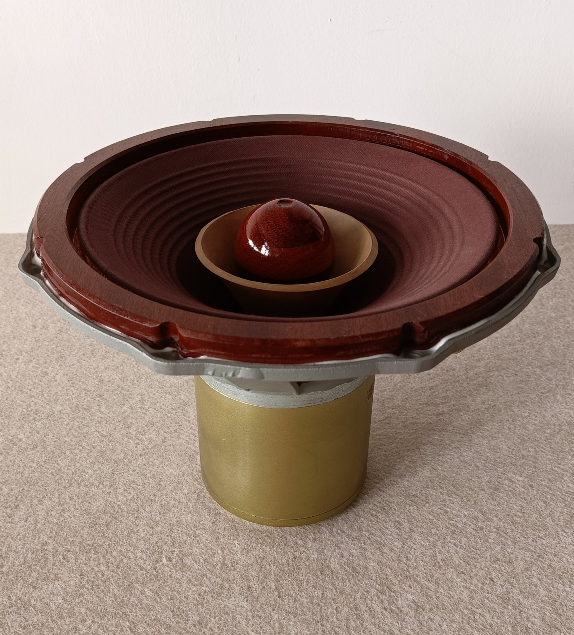

I got introduced to Lii Audio in 2019 (as it then was) through Caintuck Audio when Caintuck first offered the F15 in its baffles. I think at that time Lii Audio was still the main supplier of those drivers that Caintuck was using. I got a pair and was very happy with them (although I ended up selling them).
In 2021, I wanted to upgrade and saw on Taobao that Lii Audio was selling these beautiful 12 inch ALNICO drivers and I snatched them up. According to Lii Audio, these were custom made for a customer and they had a pair leftover, so there are only, like, two pairs in existence. The build quality is phenomenal and the sound is magnificent, I have them in huge cabinets and they are my reference. I recently added a pair of tweeters (also from Lii Audio) and they are perfect now.

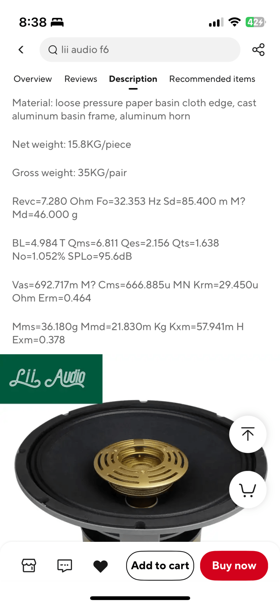

All that said, Vas for the H1502 is listed as "692.717 m M?", and Sd is an equally confusing "85.4 mM?". Not very helpful in figuring out if this is a fools errand for my 170L enclosure.

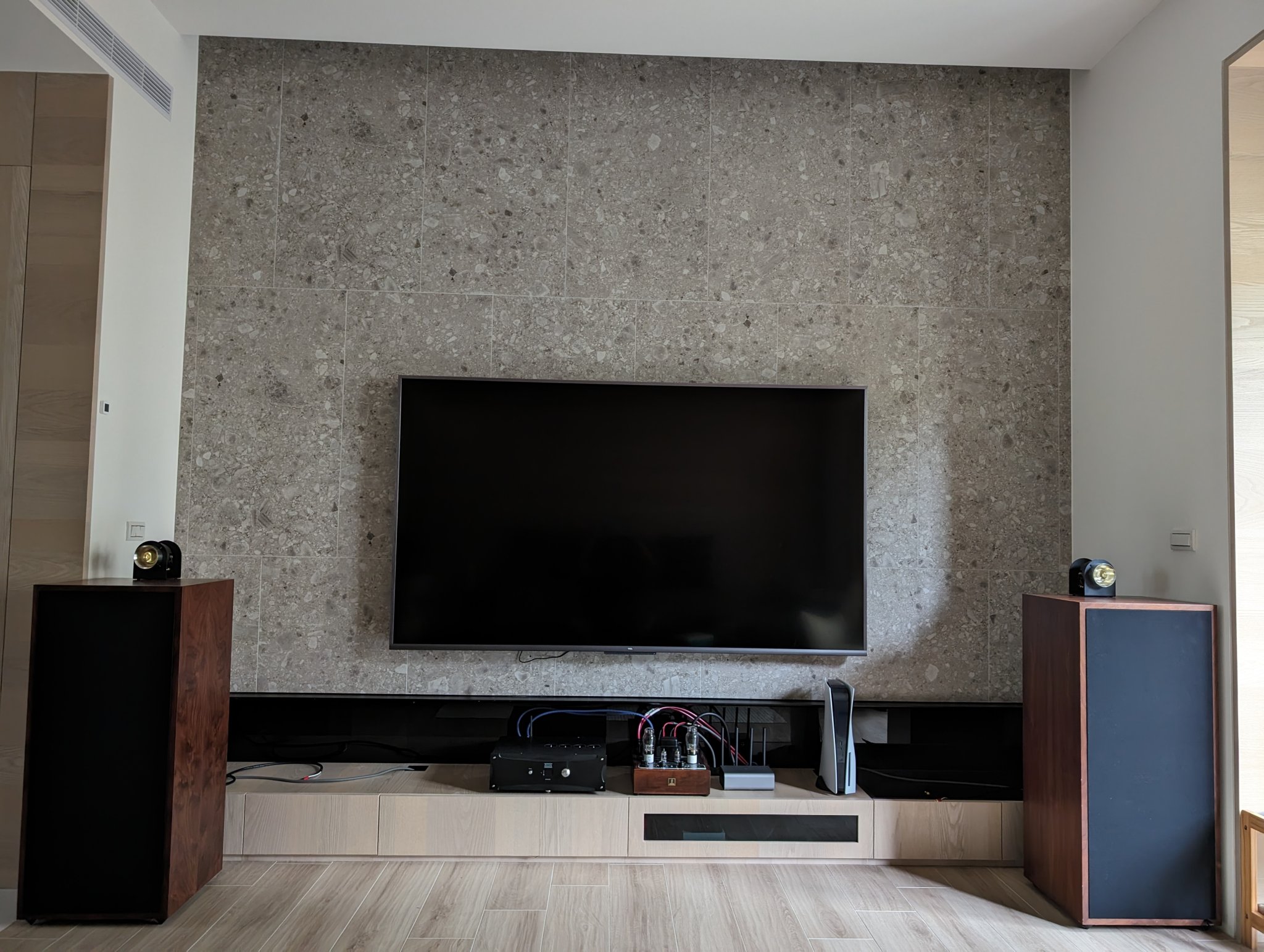

@Phloored Thanks! Yes they are about 20 pounds a piece. I used the tweeter that Lii Audio sells and they integrate quite nicely. I've attached a few photos of the drivers in their cabinets. I used the drawing specs that Lii Audio gave me, I downsized it a little though. I am glad I did because or else they would have been way too big for my listening space.@benzxc,

It seems these drivers have very high compliance (if I'm using that term correctly.. I'm learning!)

What a snag! Your listening / entertainment space with these in those cabs looks great. How fun it would be to stop by for a listen -The build quality is phenomenal and the sound is magnificent, I have them in huge cabinets and they are my reference.

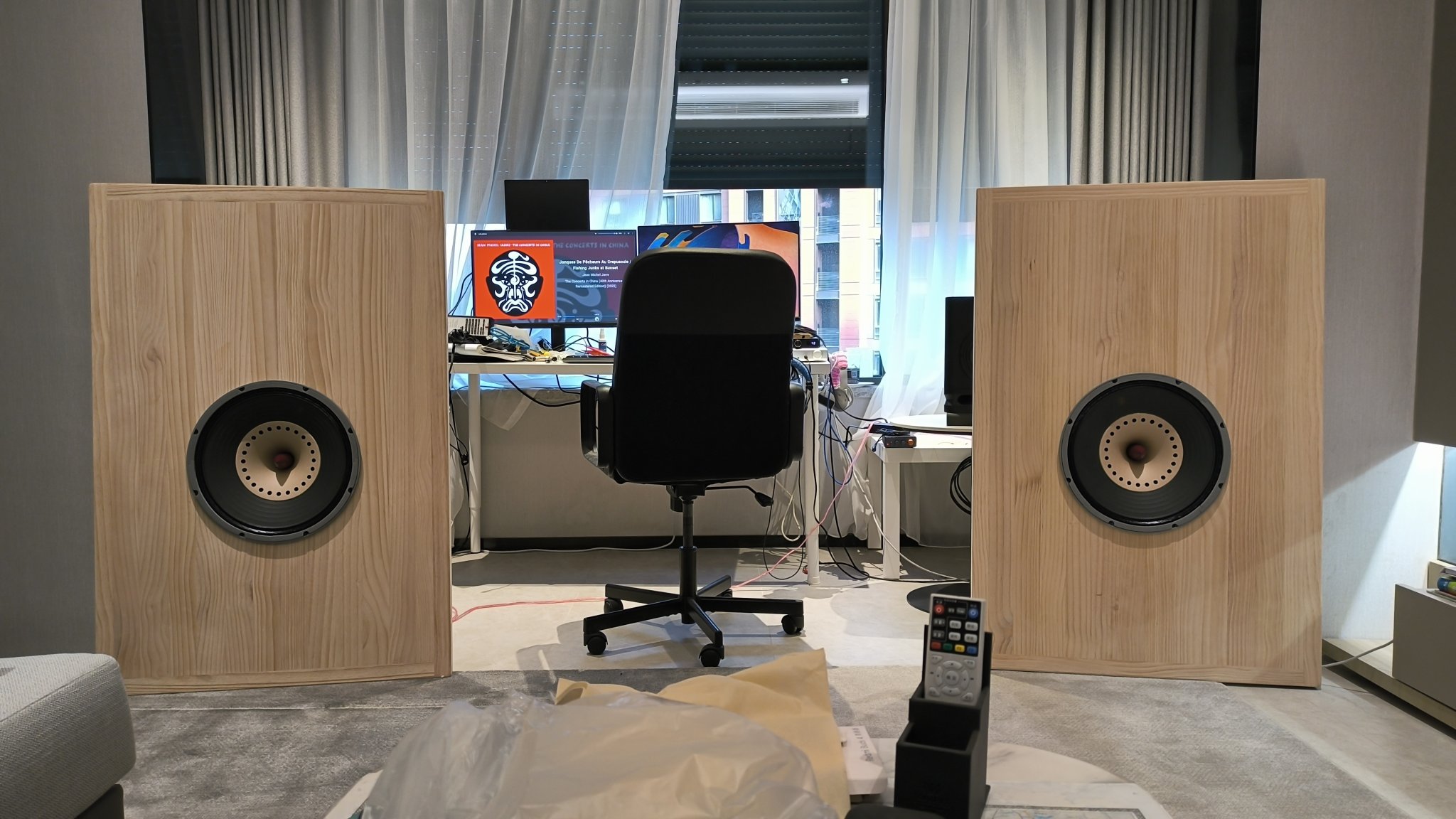

Thanks! Yes! I had the help of an experienced craftsmen or else I would not have been able to do it!"Another photo - for some reason I am unable to upload this photo. Too large?"
That looks really nice. Did you use machine screws and threaded inserts to mount that bad boy?
