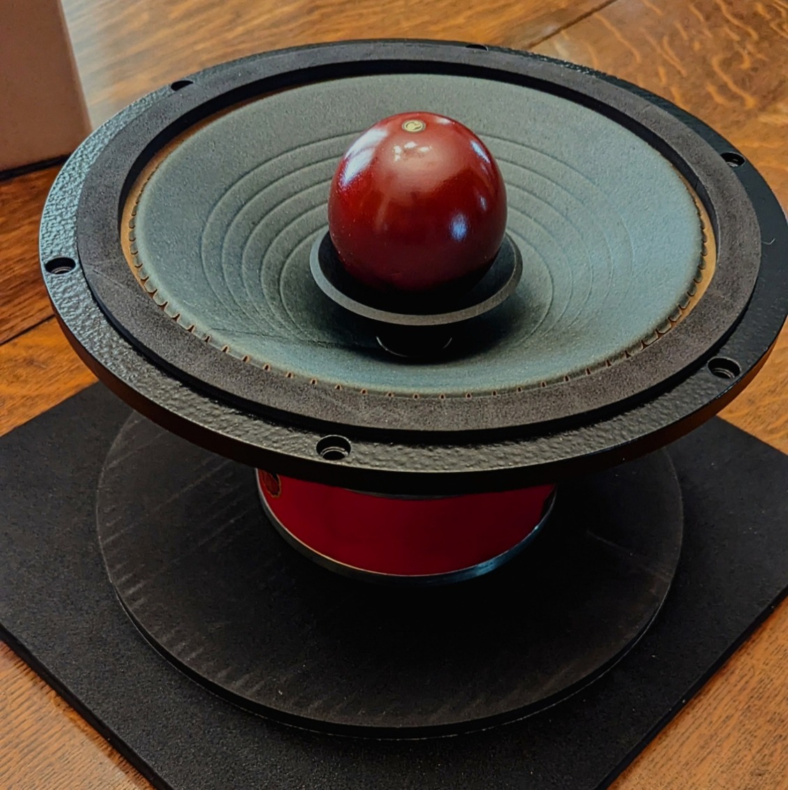

Well, my Music-10's just arrived. Installed one in a baffle, as I am somewhat interested in seeing how they compare to the Fast10 drivers, (old stock actual Lii Audio, not Lii Song). But so far, I am impressed with the look, and the raw driver sound.

Looks cool. These things are beasts! Massive magnets. My music-8's are sounding really nice after over a hundred hours. They do change. I'm contemplating the cabinet build with the folded horn.Well, my Music-10's just arrived. Installed one in a baffle, as I am somewhat interested in seeing how they compare to the Fast10 drivers, (old stock actual Lii Audio, not Lii Song). But so far, I am impressed with the look, and the raw driver sound.View attachment 1310226

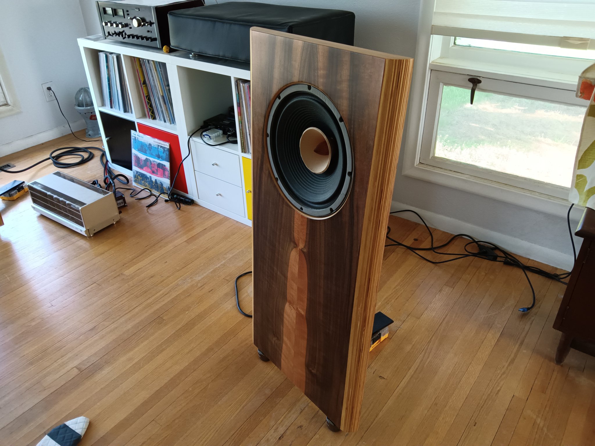

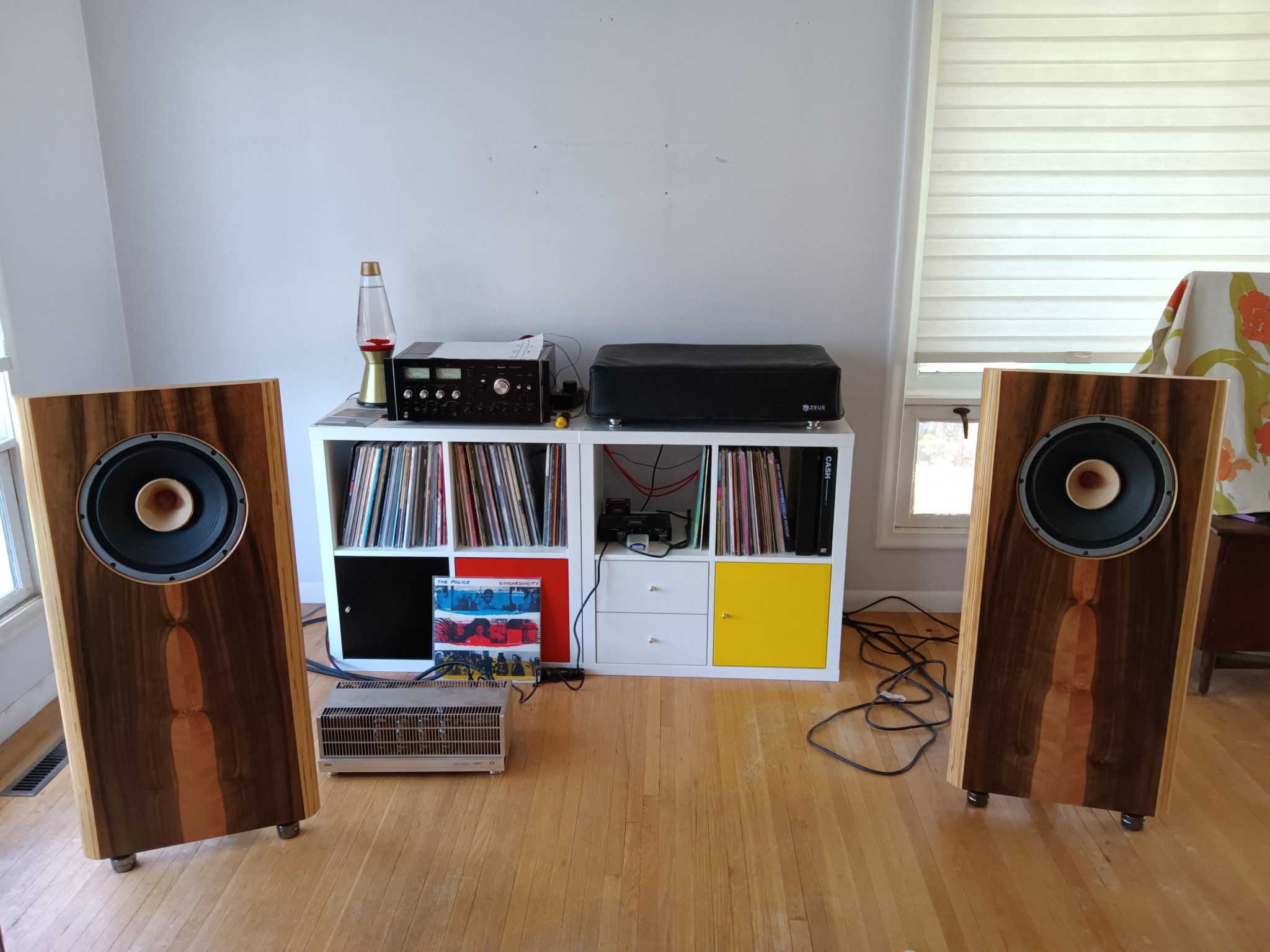

Thanks! One of the simplest woodworking projects I've done, but came out super pretty. The baltic birch is 1.5" thick - two 0.75" pieces laminated together plus the 1/32" thickness of the front veneer. Modelled them up in sketchup first. There is a 5 degree rake at the bottom and top and the center of the phase plug is designed to be exactly ear level at 10 feet away with the Isoacoustics Gaia II feet installed. It's not American walnut, but Queensland walnut. There are some really nice flitches on ebay right now for pretty cheap. I will probably pick some more up before the price goes up and supply goes down. I have 6 full extra slices of this flitch right now and 6 other halves.

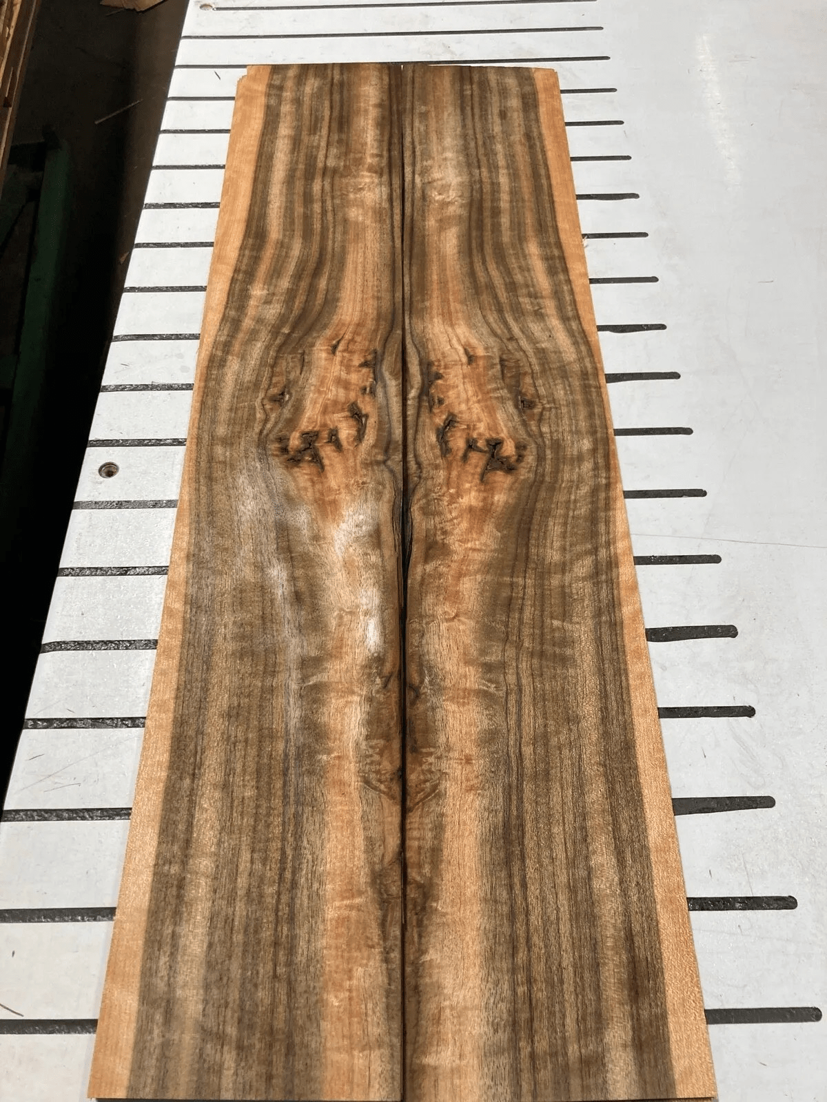

This one (below on ebay right now) is too short for something like this design, but man is it pretty... and almost all of the pieces are fairly well figured.

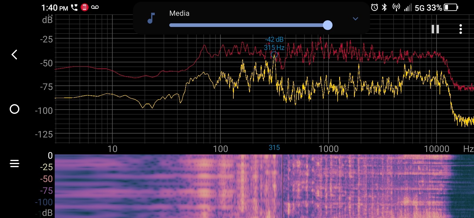

I just added my filter to cut the upper frequencies by 6 or 8 db and the speakers have much improved bass and are pretty nearly flat now. You can see how everything above about 12k is super rolled off though. I like the point source OB sound though, and love these baffles, so I pulled the trigger on the C1202's. Need to figure out a simple crossover now. I will ask the manufacturer how these work in parallel, but expecting him to say a xover is necessary. They do not give the full FR graph of the tweeter on their website. But, in must music, the F-12's are definitely much improved with my simple filter... (this still has the bass level increased on my preamp though... upper (red line) is the max music spl - sounds really good in the room - just lacks that upper sparkle with cymbal crashes.

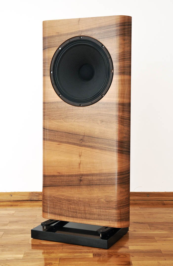

No. I was modelling on this design, and the monolith concept was super important to me - and I hate the look of the 'betsy' baffles, so the shape was an important design consideration. Remember those monoliths from 2001 A Space Odyssey? I thought that would be a good name for these baffles...
I wouldn't say that with EQ, the bass was lacking before installing the filters (a 1.0mH coil and a 10 Ohm 10w resistor) - the mids and what there are of highs were just too exaggerated. The filter does a pretty good job taming them down somewhat. I need to run a frequency sweep at some point and that will give me a better idea, but listening to music - they do sound very nice.

Nice. I also use Spectroid.Thanks! One of the simplest woodworking projects I've done, but came out super pretty. The baltic birch is 1.5" thick - two 0.75" pieces laminated together plus the 1/32" thickness of the front veneer. Modelled them up in sketchup first. There is a 5 degree rake at the bottom and top and the center of the phase plug is designed to be exactly ear level at 10 feet away with the Isoacoustics Gaia II feet installed. It's not American walnut, but Queensland walnut. There are some really nice flitches on ebay right now for pretty cheap. I will probably pick some more up before the price goes up and supply goes down. I have 6 full extra slices of this flitch right now and 6 other halves.
