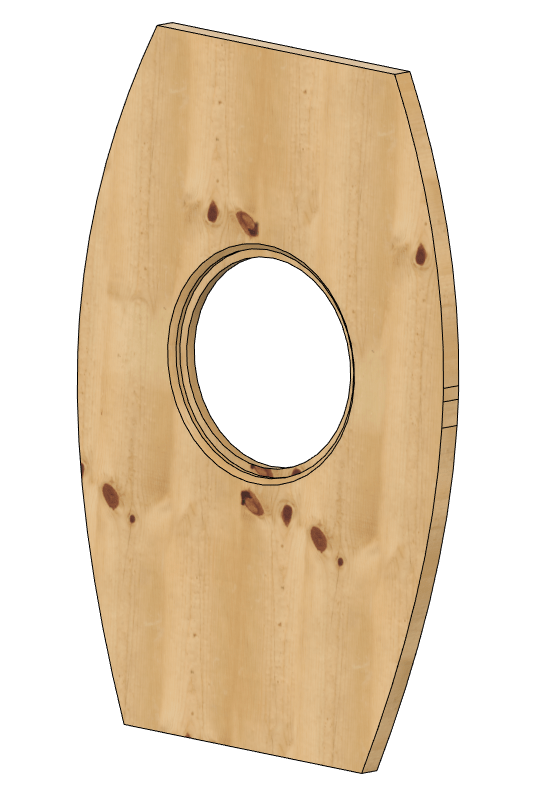

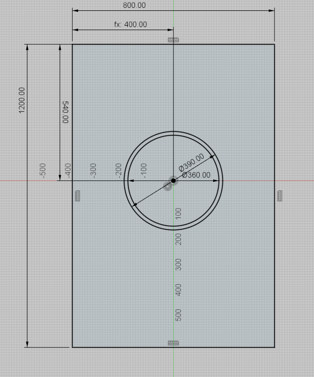

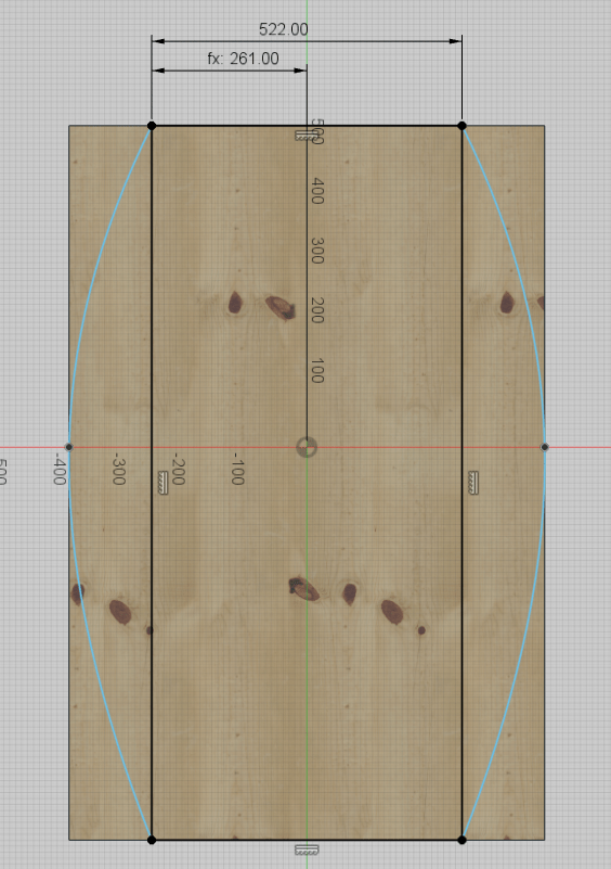

Here is the wood panel, thick is 40 and weight +/- 25kg
We plan to cut it with these dimensions:
It will be something like that :
We also designed a cheap system for the feet in order to set the vertical angle easily. I will post the Fusion 360 schematics later (coffee time and then job is waiting).

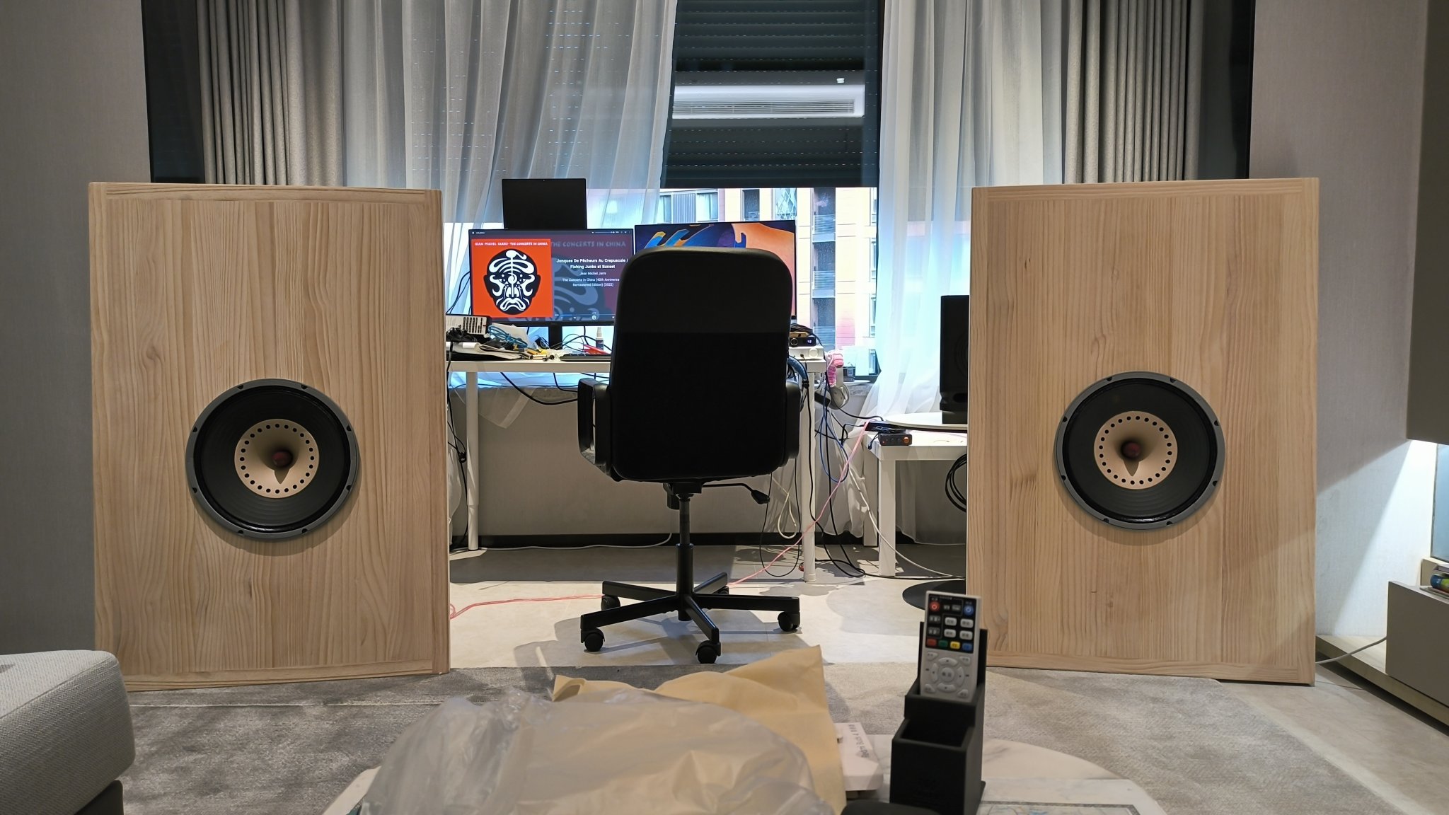

Thanks @renaudagnes for sharing the plot and your cool baffle design with all. Looks really solid! The low frequency suck out makes sense too, thanks for working that out and explaining. I've been traveling and checked out on this conversation for a while. Your plot has got me thinking how I might play around with this in my system. I have a miniDSP on the sub only at this point (and was trying to keep that out of the path for the mains) but I have two free channels to play with and could use those to parametrically EQ the Fast 15's as well as the subs in my distributed bass array and check the results with my Omnimic. I still have not ordered or considered a design for the baffles yet but have some great ideas from you and the others now. Again, thanks for sharing the work you have put in!
