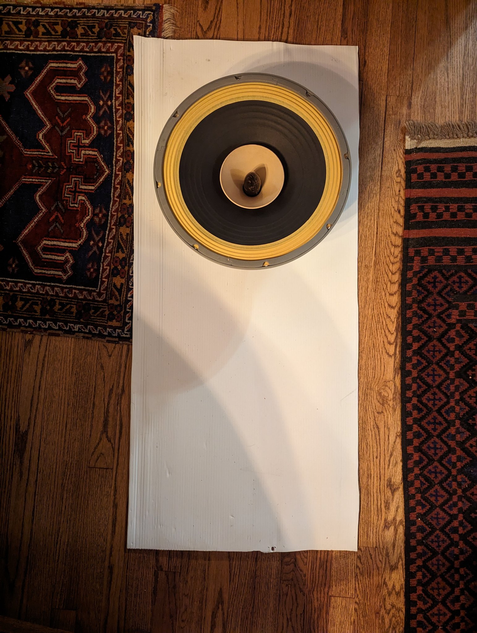

Does anybody think that the shape of the baffle matters? Is it better for bass if the bottom that supports the baffle is a solid, full piece of wood? This may not be a good idea, but I'm considering making baffles sized similar to the football shaped or square Caintuck audio baffles, using a larger board for the base of them, and screwing that to them on the sand filled stands I use for my regular speakers, about 24" high. Again, this would be used with a swarm sub. What are the up and downsides of this? This is largely because of real world considerations-keeping the drivers off the floor to safeguard them from my dogs!
Well, yes. Any speaker driver needs something to push against and mass / weight about the periphery of the frame is suitable. You can also add that to the magnet structure, by bringing it in solid mechanical contact with a large mass of some kind, if it's not possible to provide that at the frame (bolt pattern).Is it better for bass if the bottom that supports the baffle is a solid, full piece of wood?
Number two is the wrap distance from the front of the cone to the back. Ideally that's infinite (like the mass...) but practical trade offs must be made in realizable speaker designs. The so called "H frame" is one design that bests a plain flat baffle, by folding it into a more compact form. But it presents its own problems, one of which is you have to cross well below the cavity resonance created by the "H" ends.
Each and every design has its own problem set. Some are solved more easily than others. Some are solved simply with enough money, others with a different sort of cost; application of inginuity, skill, time and effort.

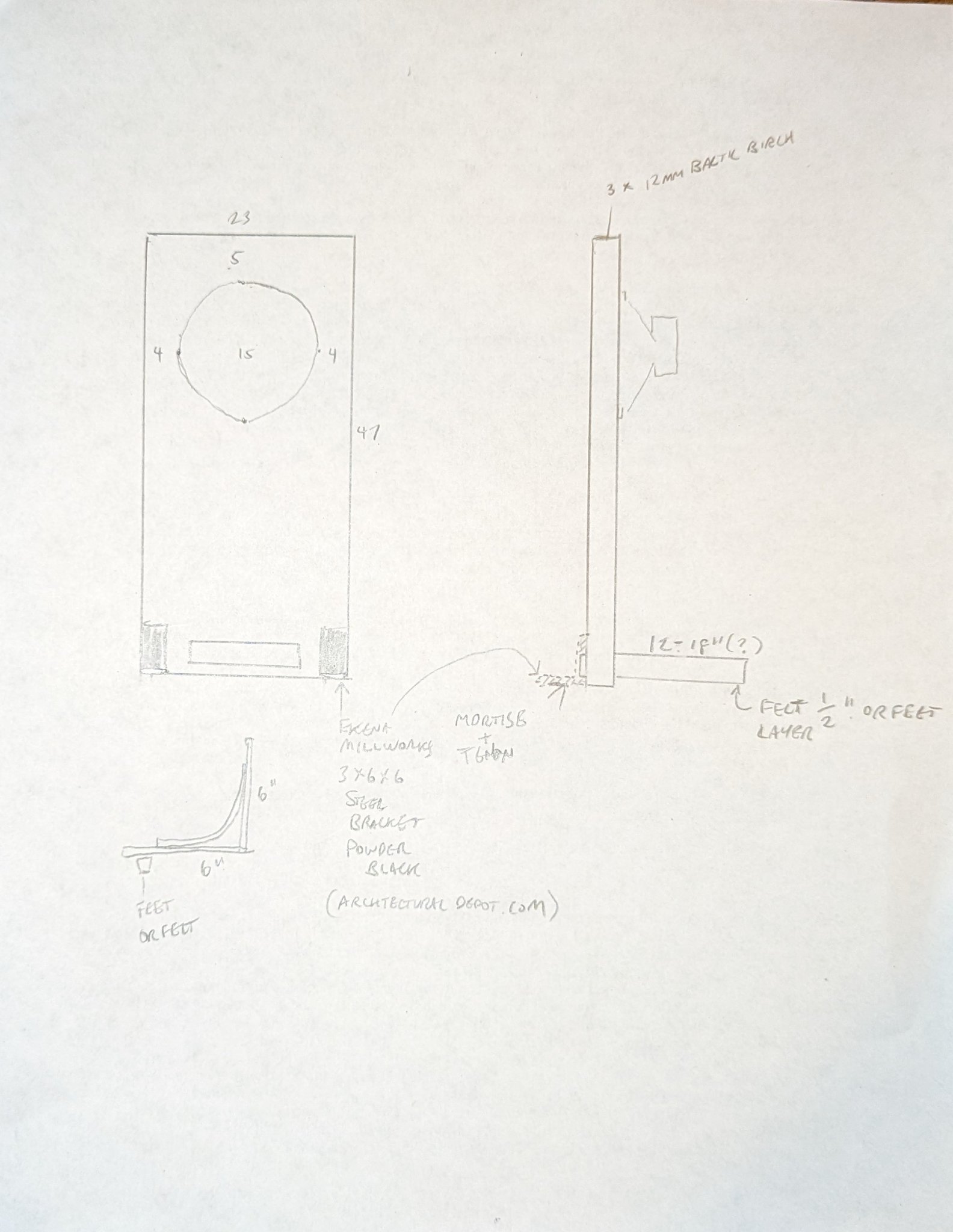

Hello, people that were (and maybe still are) paying attention to this thread. I got my Fast 15s today and am plotting my strategy. Plan is to create a tower style baffle up to 47" high made of three sheets of Baltic birch stacked. Foot configuration TBD.
This is my tentative plan but I haven't started yet. Listening to the speakers on the floor for a while convinced me that having the speakers at ear level and perpendicular to the ground is essential in my room to get the best imaging-the sweet spot is very narrow. I have the swarm sub to fill in the bass holes without making that obvious (hopefully). So far I am happy with the quickness and tone but they definitely need break in and sound like crap with some songs!

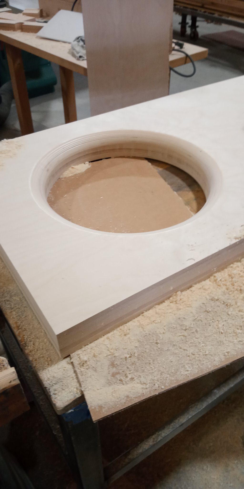

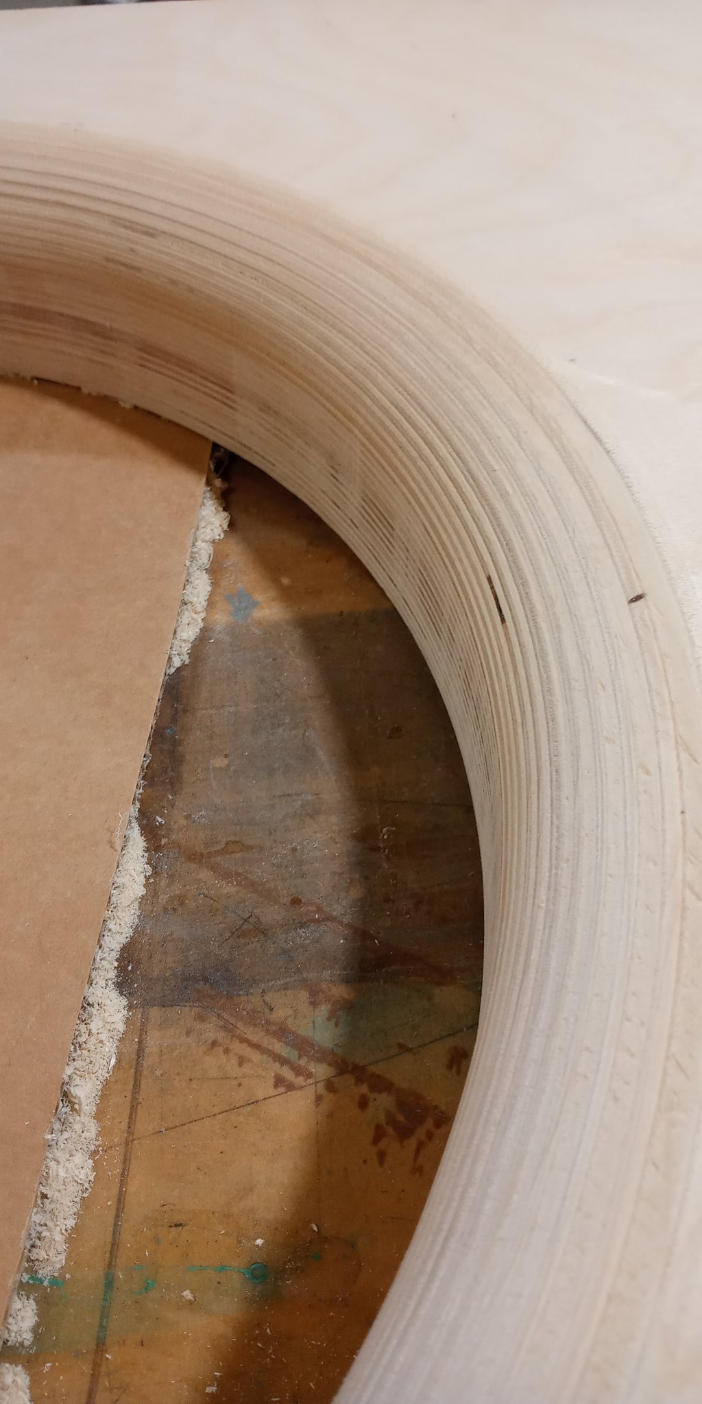

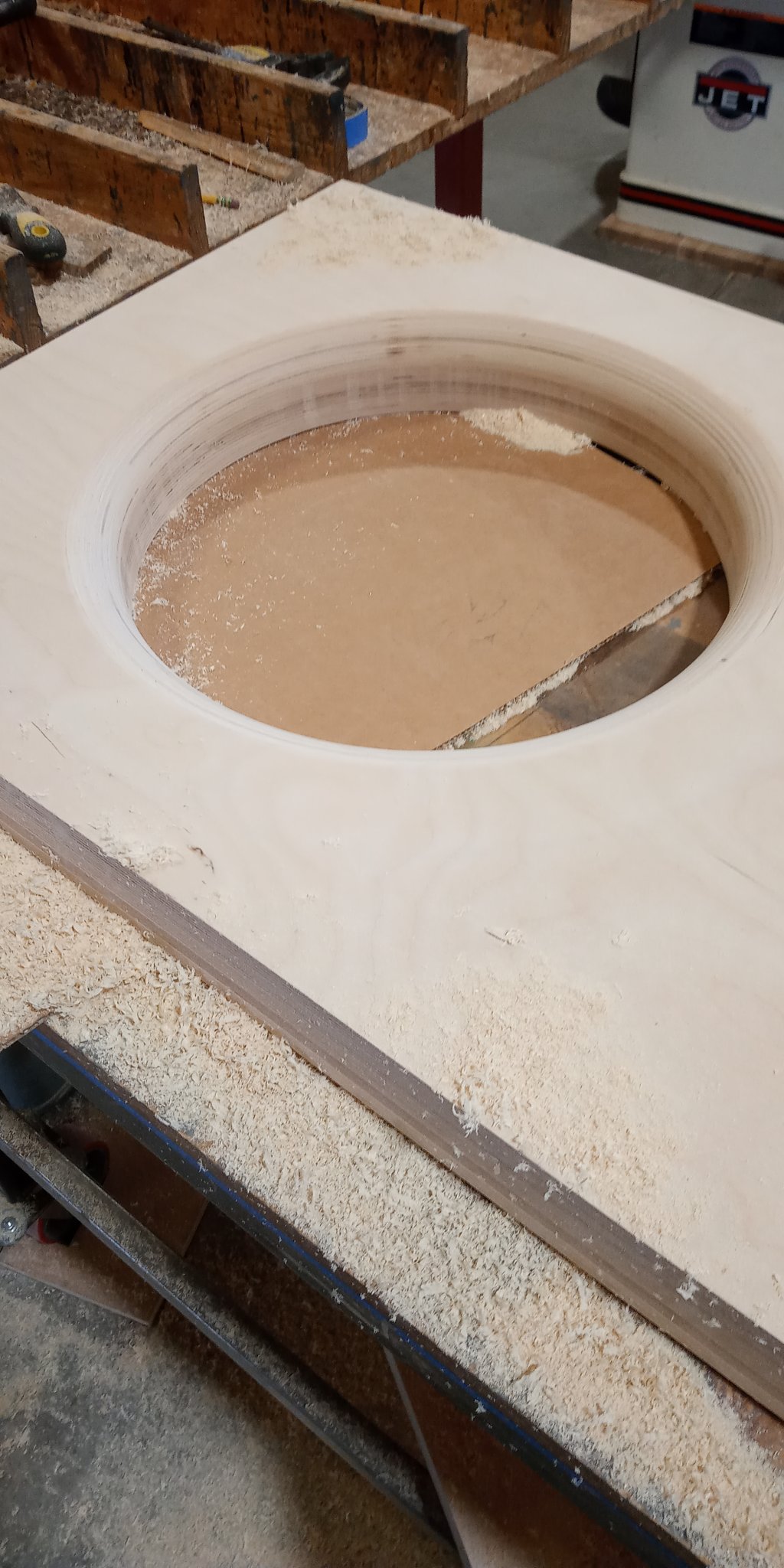

Hello, hello, hello, is there anybody in there? Sorry, bad audiophile music joke but I'm not sure if anybody is still following this thread. I have had some thick baffles made from five sheets of 1/2"stacked BB--I did not have the scale of tools to tackle this. The cutout for the speaker has a rounded edge that has a 3/4" perpendiculat profile on the back side and is rounded on the front--it was the best they could do with the bits and equipment they had and I could not afford to buy (or locate) a custom bit. The driver edge for the Lii Audio Fast-15 is 1/2" deep including the gasket material on the front edge. If it were routed in to be flush mounted and the remaining perpendicular edge next to the driver on the front edge of the baffle were 1/4" would this have any audible effects? My wishful thinking is that the whizzer relies on the main cone for a "waveguide" and the lower frequencies would not have a problem with this perpendicular edge. I could sink it in 1/4" further so sound waves only encountered rounded edges but I'm concerned that this would leave insufficient purchase for the mounting screws. If anybody that reads this has feedback please let me know.
I don't get your point. Do you want to mount the speaker behind the panel to use the "waveguide", and if yes, I guess you will use the screws behind the panel. Maybe I am completely wrong...
Sorry to be unclear, I"m just wondering: if the speaker is backmounted and inset so the half inch rim of the speaker is flush with the back of the baffle, will the part of the edge closest to the driver, which is perpendicular to the driver for 1/4" before starting to round over, cause diffraction problems with higher frequencies? When I've heard this discussed it's always in the context of a back mounted tweeter not a full range speaker with a whizzer cone. I'm not sure this concern applies to my situation.
~13543/2/0.25 = ~27,086 Hz so who cares? 😉 That said, of more importance is the theoretically infinite # of eigenmodes the parallel wall horn throat/driver forms and why the horn should always have some taper, preferably > ~12 deg included to rapidly decay 'slap echo'.
Thanks for that calculation GM. This is a full range large diameter driver with a shallow cone and an absurdly large whizzer that has the typical ragged response and peaks. I can use DSP and mic the room to figure out how to make it work as good as I can but...given all this does the edge we're talking about even move the needle? I hope that eigenmodes are lost in the mix because creating the taper you suggest is beyond the capacity of the cabinet shop I'm working with. Thanks again for your input!
I have a pair of the Lii Silver 10's in the big bass reflex enclosures and they have a curved ring around the perimeter which is removable, but similar in shape to the edge described above. There was a serious measured improvement with over without.
@Sinisterexaggerator
You're welcome!
Understood and it does, but as NP alluded, the round over swamps them overall, i.e. was just showing you to 'think' in frequency size when looking for sonic issues to decide what's more/most important.
