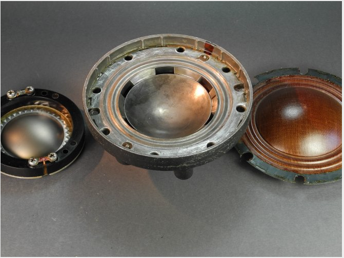

So, perhaps plug and play, with a 17.5T Peavey magnet? Atlas won't say how strong the SD-370 is. I see certain differences between the design of the SD-370 and the FS100W. Do you think they are one and the same?
I too am very interested in this. They look similar but there are differences in the exterior. The FS100W has three vertical ribs on the exterior, and the SD-370 has only two ribs per quadrant.
The AS100N looks to be the current driver available from Atlas sounds and shares its exterior design of the SD-370.
No Peavey magnet required. Plug in, hit play.So, perhaps plug and play, with a 17.5T Peavey magnet? Atlas won't say how strong the SD-370 is. I see certain differences between the design of the SD-370 and the FS100W. Do you think they are one and the same?
The only difference that I can imagine is the
magnet itself. With over 115db at 1W/m at 220hz there is definitely a rather
great BL force at work already. Trying to fit any new magnet structure could
very well be a step back.
Klaus

I emailed the guys at Atlas sound and they were extremely helpful. Here is their response regarding the similar drivers
I had to run this one by the old OEM guy .
Here's the reply .
" The Federal Signal FS100 (now obsolete) was an entire siren speaker, not
just the driver. However, the FS100 used a driver nearly identical to the
SD370 - theirs was manufactured by Korean company Sammi Sound. They later
acquired the compression technology from Sammi Sound and opened their own
factory in Danville Kentucky rebranding it as Alta Sound (later they stopped
marketing products under the Alta brand).
The Federal Signal FS100 driver is very similar to the Atlas Sound
(obsolete) SD370 driver
The Atlas Sound AS100N driver is very similar to the current Federal TS100-N
driver - both being thinner and using a Neodymium motor assembly while the
former SD370 and FS100 driver used an AlNiCo motor assembly.
In summary: All four drivers are essentially electronically very similar,
just the newer versions use modern technologies and rare earth magnets
(Neodymium) thus are smaller and lighter, an advantage when used in a
vehicular application where space is a premium."
