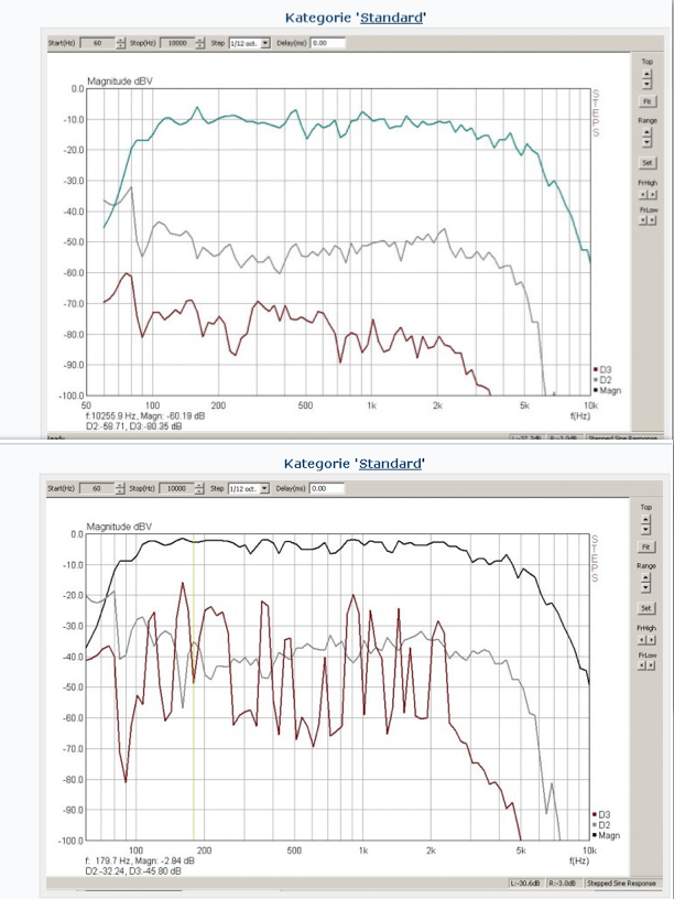

As I mentioned in post #118 the very long, slowly flaring horn throat required for LF reinforcement also increases distortion due to air non-linearity at high SPL.Regarding the rise in distortion at the higher output level, the 3H component is not relatively uniform across the range in its rise, unlike the second harmonic. I see distinct spikes, albeit a lot of them and it makes me wonder if diaphragm break up is occurring down low due to high excursions and high compression. I wonder thus, if the distortion both in its level and general shape, would be different if the driver were to be tested at the same or even higher SPL's but high-passed at say 200-250Hz.
Looking at Dietmar's Sato horn driven at .15 watts it reaches 100 dB at .7 meters with second harmonic distortion at only about 4% at 100 Hz.
At 110 dB at .7 meters (presumably 1.5 watts), the D2 rises to around 11% at 100 Hz, generally a linear increase of around three times the distortion, but the more objectionable third harmonic distortion has not risen in a linear fashion, probably due to air non-linearity rather than diaphragm break up.
It appears with the nature of the non-linear distortion, if the power input was raised to 15 watts, D3 would rise over 100%. The diaphragm would also likely be hammering on the phase plug at that level.
Raising the crossover point would reduce distortion somewhat (and eliminate the problem of the diaphragm hammering on the phase plug), but the air non-linearity would still present a problem with such a long throated horn.
If one wanted to reduce third harmonic distortion at high SPL, a better choice would be a more rapidly expanding horn, which would not go as low.
Or one could simply use larger diaphragm drivers, which don't require such extreme throat pressures (or excursion) to achieve greater SPL with less distortion.

Ok guys,
I spoke to Dietmar last night and he discovered a fault.
The third harmonics are not what you see on the pic.
His mic pre was clipping but he did not notice it.
It dawned on him when he measured the SD-370 and found
an unusual rise in H3. He did not remeasure the K55 but
he indicated that it behaves in a normal manner with the
harmonics at 110db compared to 100db.
The SD-370 is better yet with lower distortion. The only limitation is
that it just goes up to 1.2khz so it needs another driver on top.
