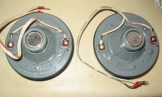

" The Federal Signal FS100 (now obsolete) was an entire siren speaker, not
just the driver. However, the FS100 used a driver nearly identical to the
SD370 - theirs was manufactured by Korean company Sammi Sound.
The Federal Signal FS100 driver is very similar to the Atlas Sound
(obsolete) SD370 driver
The Atlas Sound AS100N driver is very similar to the current Federal TS100-N
driver - both being thinner and using a Neodymium motor assembly while the
former SD370 and FS100 driver used an AlNiCo motor assembly.
In summary: All four drivers are essentially electronically very similar,
just the newer versions use modern technologies and rare earth magnets
(Neodymium) thus are smaller and lighter, an advantage when used in a
vehicular application where space is a premium."
What does it mean that they are an entire siren speaker, not just the driver? It can still be hooked up and used as a speaker, right?
Also, I think nd compression drivers have a detailed but intense sound to them, compared to more laid back ferrite magnet compression drivers in similar size, but not sensitivity.
Pano, It is a way to make a lofted pattern that is as good as you do the detailing. For some of these bass horns and high horns people are talking about it would work well for a fiberglass horn lens.
I hate working with these toxic plastics and itchy glass fibers.
They were sold as a complete unit with a siren attached.
Okay, I thought there was some kind of 12V siren tone generator or something inside of them, and I was afraid it would not have normal speaker inputs. Siren signals would be fun for a few seconds but not all the time.

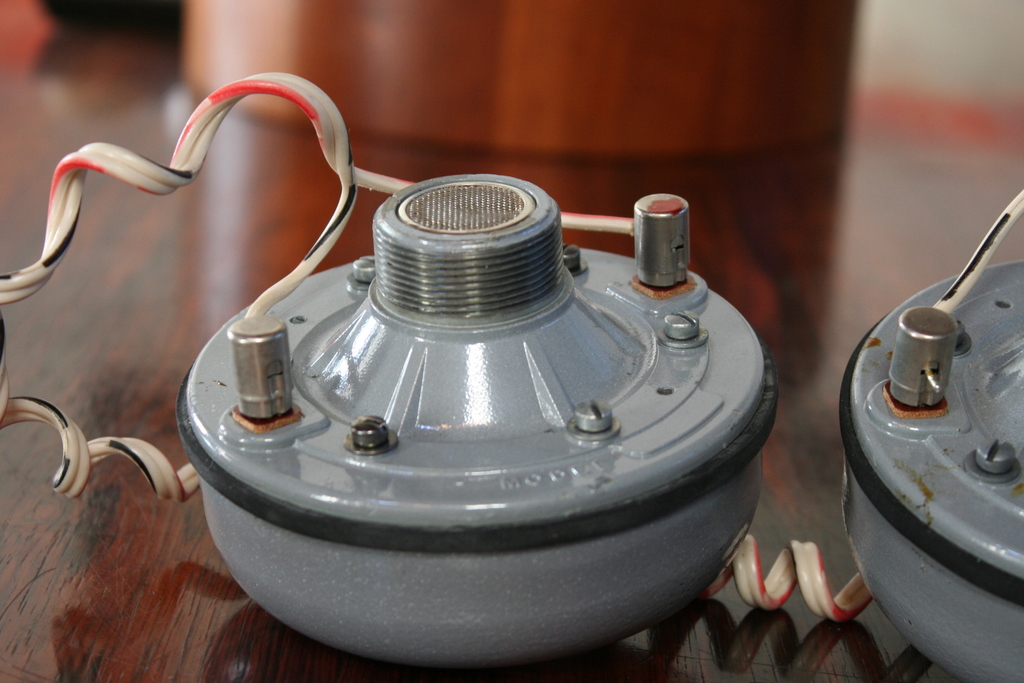

The neodymium versions will be more pricey and they will have a smaller back chamber, so may require more mod work?
Interesting double half roll surround on that "370"...
What were the mods to the 370??

Throat must be 18mm corresponding to the inner diameter of the SD-370s exit.
I measured the K55-V to have a 2.05 mm thoat and assumed Atlas would use the same for all their drivers.
At least that is what I could see through the metal protection mesh. Maybe there is another edge under the grill that I did not see. To me it seem like the throat is the width of the metal mesh. I don't want to open them if the diaphragm is not autoadjusting, but I guess after 40 years I should clean them out. Romy the Cat seem to be very keen on re-centering diaphragms in his Vitavox survival guide. I tried that on my Beyma 1" but it was very difficult to know when they were centered.
