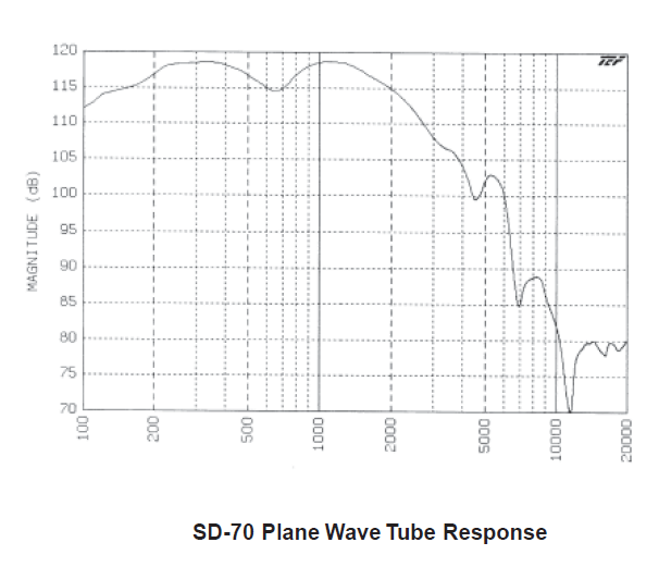

As impressive as the modified K55/Atlas PD5V is, I am convinced that Atlas has
two even more impressive drivers. If the goal is to use a good
tractrix or Seos from about 800-1200hz on up, these drivers are killer. I think
they approach Goto level bass performance to below 100hz. Honestly.
The SD-70 and SD-370.
SD-70 = 112 db w/m at 100hz on PWT.
58W full power operation at 200hz.
If they are not lying to us(and they havent with he PD5V) this is it. Search over.

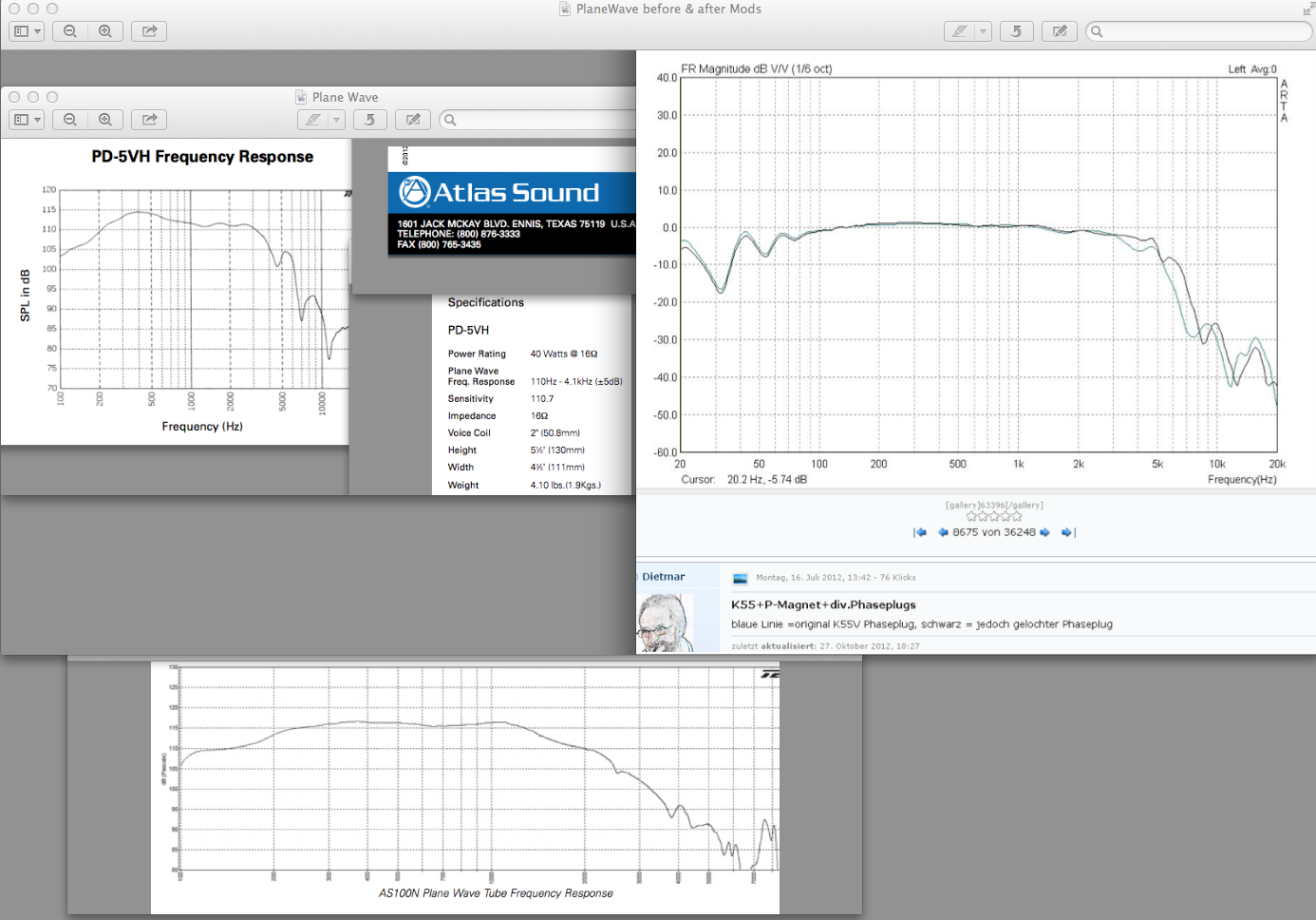

SD-70 weighs 600 grams more than a K55-V, and it plays in average 5 dB louder, 116dB compared to 111dB. I wonder if they gave any thought to sound quality, when the purpose was police sirens.
I wonder if the Altas AS100N is similar? It's a siren driver with a Neo magnet.
Specs can be found here:
http://www.atlassound.com/FileDownload/AS100N_Data_Sheet_____ID1680.pdf
Doesn't play very high, in stock form.

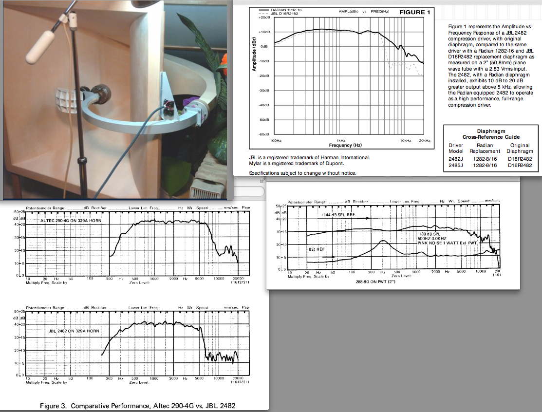

I have a pair of the very large and heavy Altec 290 drivers that are rated to play low and have phenolic 'frams. They also top out circa 5KHz. I've never been able to get much under 300Hz from them, but then maybe I don't have a big enough horn. 😉 (size does matter)

The AS100N has a 2.75" diaphragm, so it has quite a bit more Sd than the PD-5VH.
The frequency response is much more narrow than the K55/PD-5VH, but it looks like it could cover the decade from 200-2000 Hz on a "mini Sato" with no modification.
Could not find plane wave tube response for the 290, but I'd expect its LF to be less than the Altec 288 since it rolls off more than the JBL 2482.I have a pair of the very large and heavy Altec 290 drivers that are rated to play low and have phenolic 'frams. They also top out circa 5KHz. I've never been able to get much under 300Hz from them, but then maybe I don't have a big enough horn. 😉 (size does matter)
The horn has to be huge and long for these compression drivers to go low, and the huge horn will have less output potential in the 100-200 Hz range than a 12" speaker in a small box.
Efficient though, nice for those in love with low power amps.
Yes Art, I looked again and the 290 is given down to just 300Hz. Maybe with some mods it will play lower. 🙂

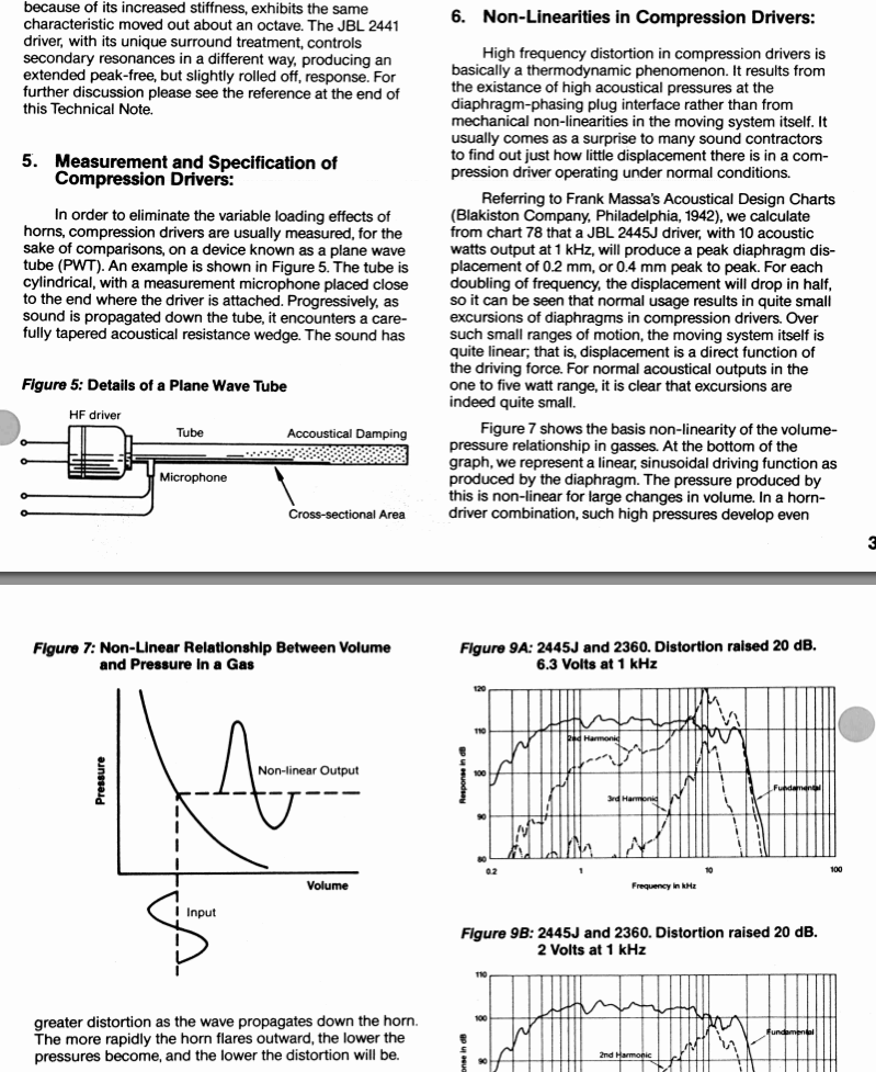

Having heard a number of big horns (though not as big as the Sato) driven by compression drivers with diaphragms from 1.5" to 4", my impression is that directivity and harmonic distortion both play key roles in their sonic signature.
The lower and louder the small diaphragm horns are driven, the more distortion they produce.Mucho distortion, or not much?
The problem is (at least) two fold, we expect distortion to increase with excursion, but in addition air becomes non-linear at the high SPL in a horn throat, as mentioned in the JBL Technical Notes Volume 1, Number 8, Characteristics of High-Frequency Compression Drivers :
"In a horn-driver combination, such high pressures develop even greater distortion as the wave propagates down the horn. The more rapidly the horn flares outward, the lower the pressures become, and the lower the distortion will be."
To achieve a low frequency cut-off with a tiny diaphragm, a very long, slowly flaring horn is required, which also increases distortion.
Distortion makes things sound louder, so a distorting horn/driver does increase the sense of dynamics 😉.
