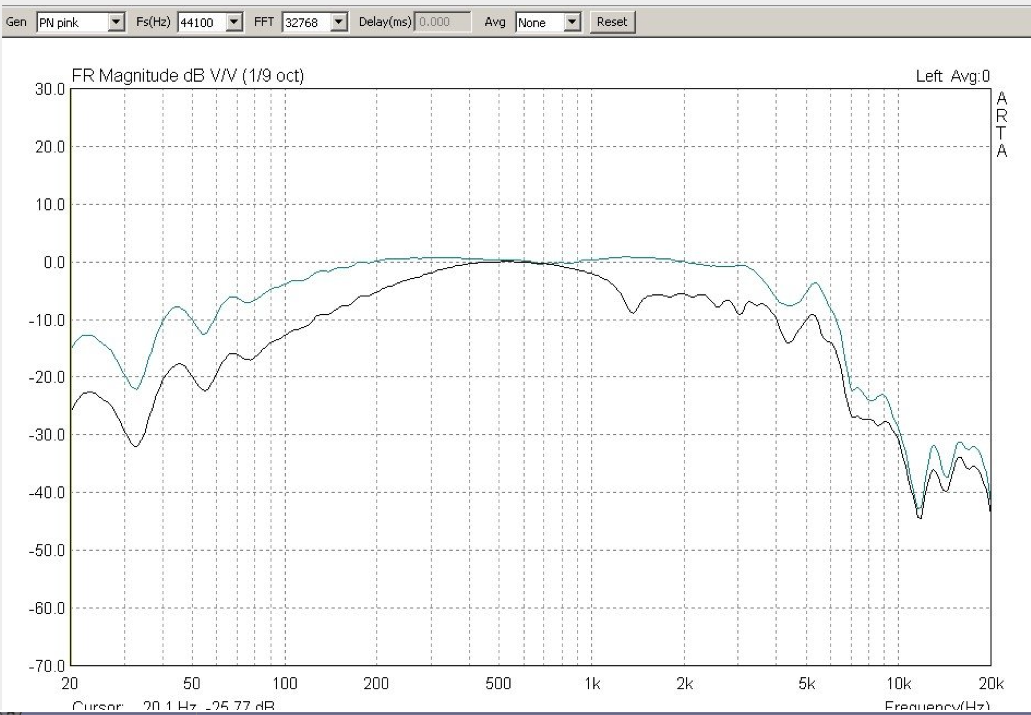

Radian,Here is a pic of the modified K55. Just a Peavey magnet structure glued
on with a little felt cavity attached to the vent hole.
Before is black and after the mod blue line:
What was the horn (if any) used for the before and after measurements, and at what distance and drive level?

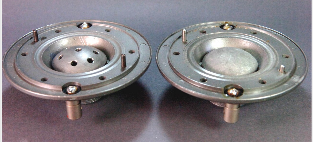

Say, Klaus, in post #50, what is being shown??
I see what looks like it might be the stock K-55 on the left, but what is on the right??
Also the WE555 has the dome inverted so that the concave side faces out the throat and faces into a conic phase plug. Wondering how that is happening on a Peavey motor assembly? And, for that matter, is this how the K-55 is set up as well??

Radian,
Art
It was done on his Sato horn.
Here is his plane wave tube measurement
comparing the already mod.K55 with and without holes in the phase plug.
Pretty impressive work as he managed to the that sucker to about 5khz.
Interesting that the mod shows hardly any LF improvement on the plane wave tube, but around 9 dB at 100 Hz increase on the Sato horn.

Art,
The plane wave tube differential I think is shown in post #1??
This last post shows the modified driver vs the modified driver with holes in the phase plug.
No no, the mod (bigger backchamper, peavey magnet, spacer) was done on both of the plane wave tube measurments. It just shows an additional mod
comparsion with holes in the phase plug vs. none holes.
