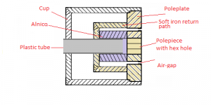

I am still not certain how it should look like inside. Are you avoiding the question, Radian? 😉
Is it just to widen the hex-shaped hole to almost an inch wide, and make sure the diaphragm dome have room in the magnet? Or does the dome-shaped chamber in the magnet need to be larger as well?
With backchamber, I assume we are talking about the dome-shaped hole in the magnet behind the diaphragm, together with the hex-shaped hole, that needs to be widened.

I am still not certain how it should look like inside. Are you avoiding the question, Radian? 😉 ..
Sorry I did not get that particular question.
The hex shaped hole lies within the Alnico magnet which is basically a tube
extending all the way back to touch the cup. The cup is of soft metal and
builds the magnetic return path.
The problem is I don't know how that cup is hold in place. I have never seen
one open either as there is just no need to open it. Now the hex shape of the
hole might give away that the cup is screwed on. Just put an Allen wrench
in the hole and try to turn the cup counter clockwise.
The neodymium magnet needs to have the exact same length than the Alnico
one because it needs to touch the cup for the mentioned magnetic return.
The center pole piece is sometimes glued to the alnico magnet. You need to
get it off and put it on the new neodymium magnet. It would be great if you
find a neodymium magnet in the form of a tube, then you would not have to
drill a hole through it. I don't even know if it can be done with a brittle material as Neodymium.

Are you sure the cup is the magnetic return? If so it must be heavier
than I seem to recall from years ago...
...Perhaps it is a bit anemic, and there is some loss there??
I'd expect that for an alnico magnet there would be an internal path with a flat (round) plate on the back with the center having a cylindrical return to the center pole piece, forming the gap. The cup being for weather protection and cosmetics.
Alternately the center piece being an alnico slug, and the return goes to the outer part, like early JBL drivers.
Anyone got a side shot of the driver??
As far as fitting a neo driver, it would only need a new return path, the front pole plate would remain the same... in any event there could be spacers of nice soft iron to make up the missing dimension, or just pile on extra neo magnets? 😀

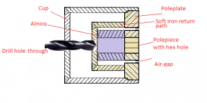

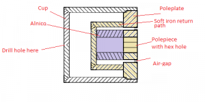

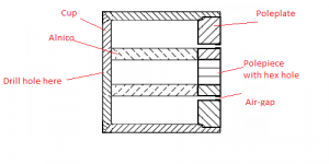

How much easier can it get than to drill one hole in the Cup?
The 0.2mm spacer just clamps the surround more on the outside
giving it more freedom to move and making it therefore also less
stiff for a lower resonance.
Thank you for the detailed picture. This make it look easier, but there is one thing. Reshaping magnets is tricky because it can screw up the magnetism. I might end up having to replace the magnet anyway.
Wait, you said cup. Do you mean I should widen the hex shaped hole or just open up the cup on the back side, and keep the width of the hex hole?
You also mentioned replacing the center magnet with a neo magnet. Where did this idea come from? Peavey does not even have neo magnets in their compression drivers, so it cannot have been tried yet by your friend.
As the alnico is usually in a pipe form there should not be any reshaping
neccesarry if we drill from either of the sides. If it is in a full cylinder form then it gets more tricky.

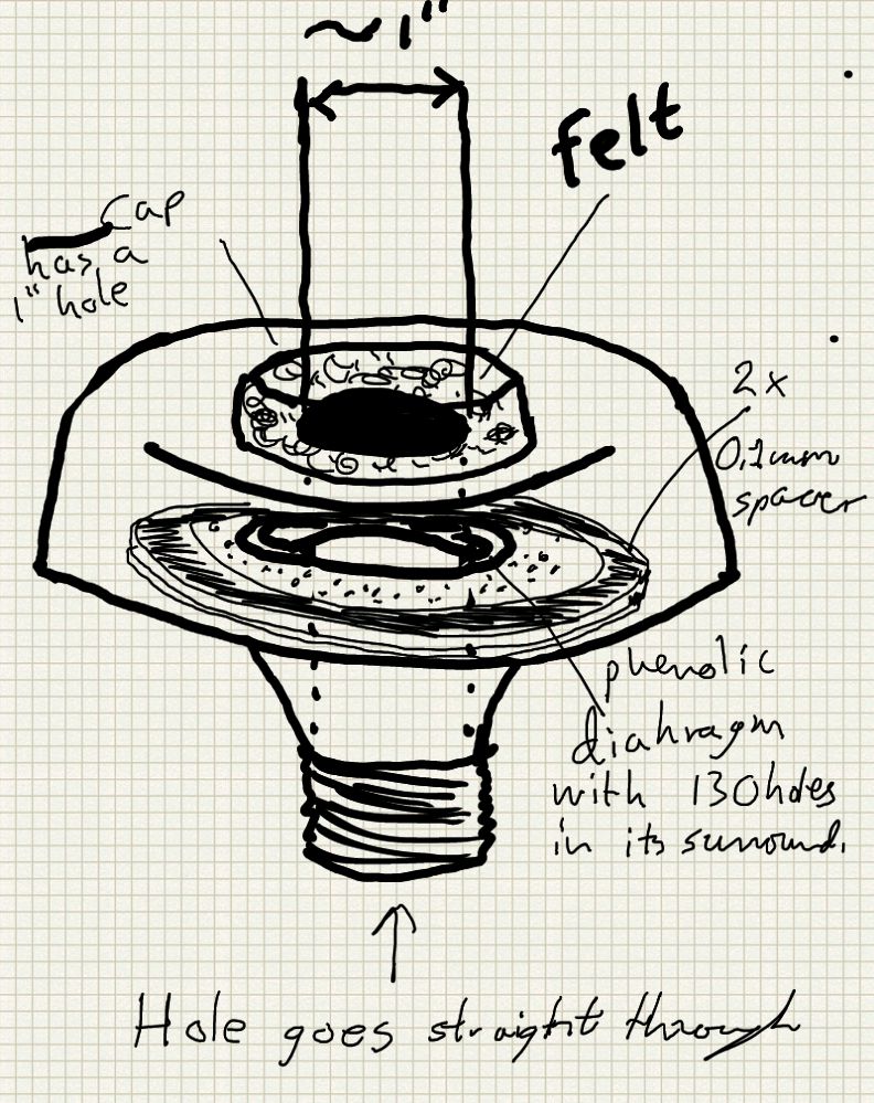

Here is a sketch that Dietmar made and I modified to illustrate the spacer
mod in English. It gets the diaphragm to 1mm max excursion.
Like so?
I am not sure you wanted a straight hole through.
Did his 130 holes in the diaphragm surround ever give any better result?
The 130 Little holes in the surround was my Suggestion to lower FS. It did not work
because it coupled the air behind the diaphragm with the compression chamber in front
of it. I should have checkt the design of the driver more thoroughly. Something good
came out of it anyway because after Dietmar sealed the holes again with very elastic
glue it had more compliance. This raised the Output in the lower Region so we knew
we where on the right track with lowering FS but we just used the wrong method.
