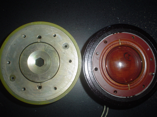

I assumed the Peavey driver just happened to have the same diameter VC as does the K-55. _-_-
Hi Bear,
I think you are right. I never ask Dietmar how he managed the clearence
to the dome on the pole piece. He might have used a very big drill.
The magnet from the peavey driver has not changed anything
on the driver except the force from 1.2T to 1.9T and the ability to have a
bigger back-chamber.
The little hex hole is all the cavity the stock driver has behind the diaphragm.
In all reality those who use a computer or do otherwise equalize the signal
can just drill the hole all the way trough the back cover and put a little
cavity there. Most easily done with a syringe whoms tip is cutt off and fixed
some how on the hole. Then the inner piece of the syringe can be adjusted by
ear or measurement until the right volume is found. This is by the way also
very easy to do when trying to find the right back-chamber volume for a bass or mid horn.
A sewage pipe with a movable plug will work great.
After the right volume is found a permanent chamber with equivalent volume can be installed.
In my opinion the to small back chamber of the stock Atlas/K55 unit is just a safety
measure to limit the excursion. Most of those drivers where used in paging
horns mainly for speech and often used with just a cap as a 6db filter below
150hz-200hz in the bigger horns.
Although the bigger force from the Peavey magnet equalized the unit quite
drastically, it does not make a difference in the achievable spl at a certain
frequency. The right back chamber with the ability to equalize the signal
will do the exact same thing but with a bit less efficiency.
Transients do usually benefit from a bigger BL factor but how different it
sounds is a question that can only be determined by an A/B test.
Klaus
It is hard to believe that two totally different speakers would have identical voicecoils. Using the same wire diameter. Former diameter, coil length and positioning so they sit in the gap exactly the same would seem to be more than a coincidence.
Atlas just continued the WE design as far as I know. Why should they change
anything on the phase plug design and the diaphragm for the purpose the Atlas driver was designed ?
Getting rid of the field coil and aluminum diaphragm was all it needed to have
a rather good sounding driver with minimal manufacturing cost.
After the modification the two drivers are almost identical in the performance
up to 3.5khz which also points to the fact that there is no significant difference
in the design.
They will certainly sound different because of the difference of the diaphragm
material but I guess it will be hard to tell in the lower to 1khz region which
I want to cover with this driver.
Klaus
Radian, have you made the mod yourself?
I am still confused exactly how the cavity need to look like, and what Peavey magnet to choose, for it to fit exactly.
If the only change to the magnet is to increase the cavity to clear the dome, I bet a dremel tool can be used.

I too am trying to find this information in the German thread….
The only 50.8mm VC peavey compression driver I found is 1.75T, not 1.9T. Maybe a nd magnet would be better, but Peavey does not carry those. I tend to prefer the sound of iron magnets over nd magnets. Beyma and B&C do not have 2" VC. The EV ND2-8 has a 2" VC and nd magnet, but I can't find it anywhere. Only diaphgrams.
I might settle for the 1.75T Peavey. It is probably the one he used anyway. The 1.9T is probably a misprint. I wonder if I should choose the 16ohm or 8ohm peavey magnet?
8ohm peavey magnet?
Don't get to focused on the kind of magnet used. As I said before, just
drill the hole all the way through the back cover of the stock driver and
attach a little cup of some sort. See how this gets the lower frequency
raised.
The lower registers are usually not what can be raised with a stronger
magnet. In the case of the K55 it was just an indication that the back
chamber was way to small ant that the added force brought the driver
nearer to the ideal system Q.
Unless one needs the extra boost in the hf ,finding the right back chamber
volume for the stock unit has theoretically to exhibit the same result.
My drivers are still at Dietmar's so I can not check if the iron cup wich
is also funktioning as the return path, can be taken off. In that case
the length of the alnico magnet can be measured exactly and be substituded
with a number of neodymium rods of same lenght arround the center hole.
But then again why go through all this if we only use the driver from lets say
150hz to 1khz?
Klaus
