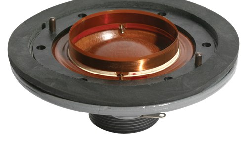

It is the yh200-2 'louder speaker' and you guessed it right because of its funny name, it's Chinese. The google translate says it can 'make it prettier'. Hmmm.
The GOTO's has 19.5T and more. There must be a purpose for these strong magnets, even for midbass GOTO compression drivers.

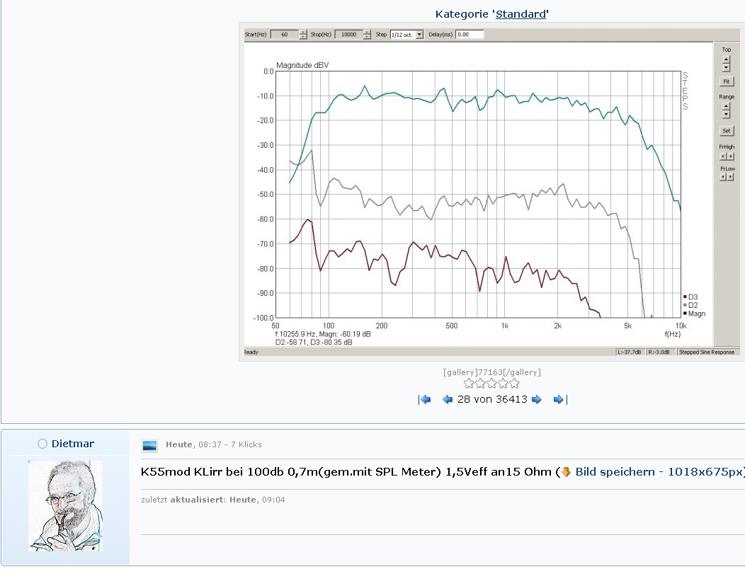

Here are the distortion tests that Dietmar did yesterday.
Let's give him a big applause as he responds to questions from a forum in which
he is not even involved.
Anyway here is the distortion for 100db:
SPL-Meter in 0,7m distance(to keep reflections down).
measuring microphone at the horn mouth on axis; no crossover;
measured with stepped Sinus(ARTA) :
1,5V eff at K55= 150 milliwatt for 100db !!!

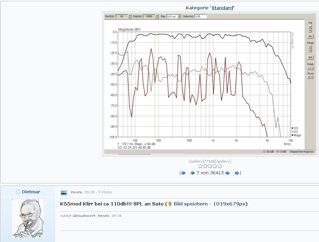

At app. 150 Hz D2 distortion is about -40db (1%), D3 even only -60 db (0,1%)
At 110db D3 raises significantly see pic two.
Higher listening levels at home are in the low 90s averaged.

Big thanks to Dietmar and Radian for those ARTA plots!
Very clean, very consistent at the 100dB level. Interesting how H3 gets funky at the higher level. Art, what's your take on that?

I thought from back of an envelope figuring that the distortion would reach around 10% at 113 dB at one meter.Big thanks to Dietmar and Radian for those ARTA plots!
As Dietmar's test shows, it reaches around 18% distortion at 150 Hz at only 110 dB at .7 meter.
Using the inverse distance law, 110 dB at .7 m equals a direct sound at 2.8 meters (9.1 feet) of 98 dB, only 88 db for the 100 dB level.
I had "kinda" thought the Sato would keep up in level with a 12" in a small box, looks more like an 8".
As far as curves in a horn eliminating distortion, that would only happen to the extent that the curves reduce HF, and Deitmar's Sato certainly does not do that.
At any rate, the distortion levels seem in line with what I had expected for a small diaphragm at "realistic" levels.
I say "realistic", as large drums can easily exceed 110 dB SPL at 150 Hz.
That said, the harmonic content of drums makes distortion hard to detect 😉.
Thanks, Klaus and Dietmar for providing the data.
Art

Regarding the rise in distortion at the higher output level, the 3H component is not relatively uniform across the range in its rise, unlike the second harmonic. I see distinct spikes, albeit a lot of them and it makes me wonder if diaphragm break up is occurring down low due to high excursions and high compression. I wonder thus, if the distortion both in its level and general shape, would be different if the driver were to be tested at the same or even higher SPL's but high-passed at say 200-250Hz.
