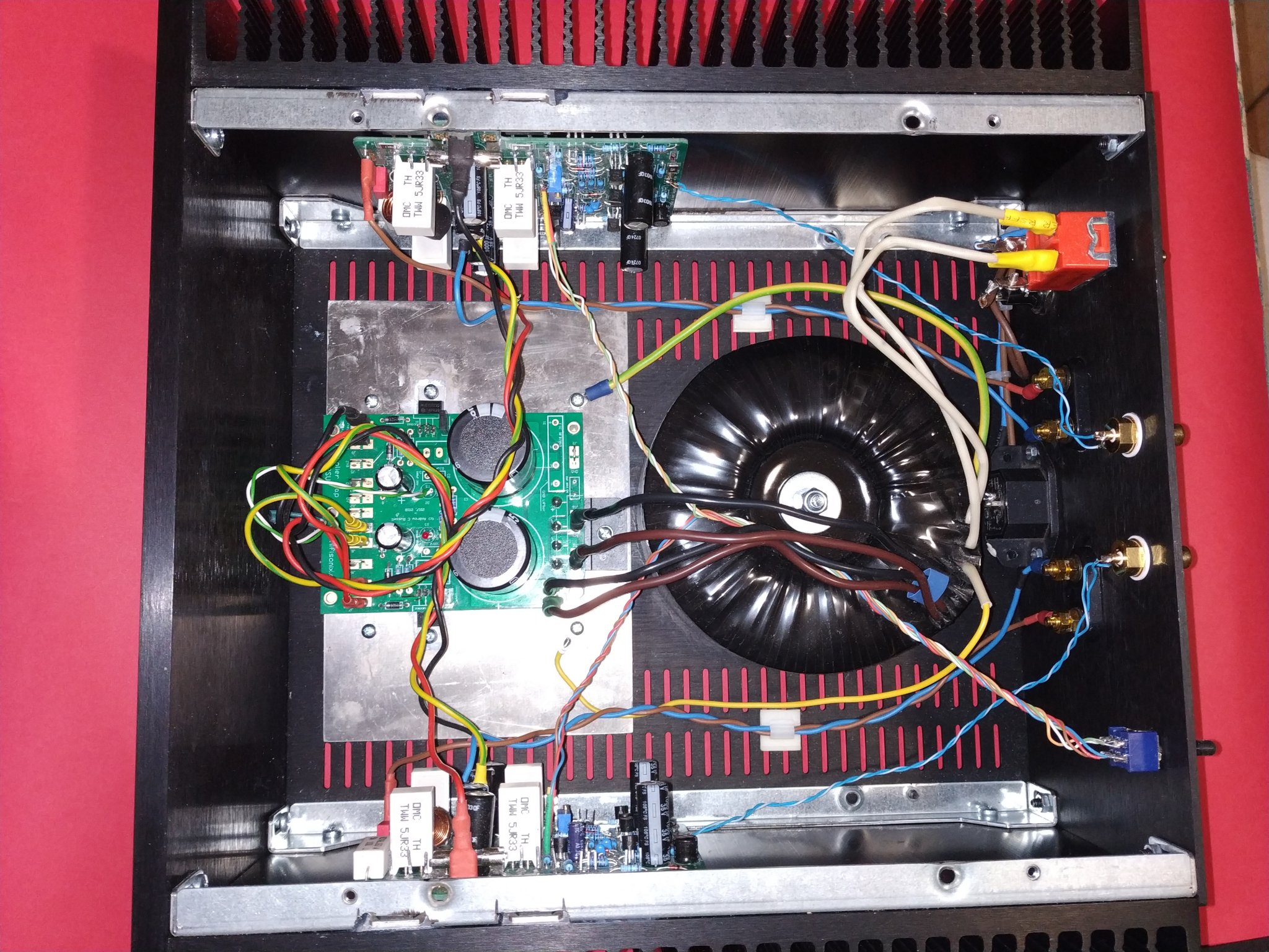

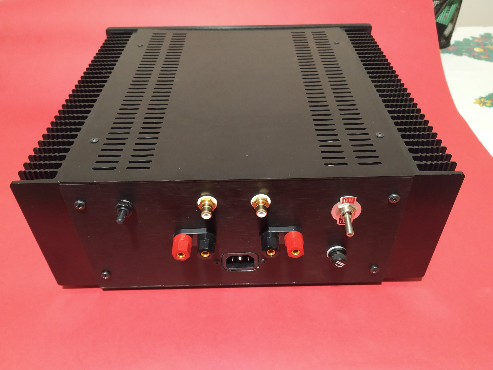

Pics of the inside and rear please!! It will help some of the newbie builders to this circuit like crispycircuit above…😉

Thx for the pic. Very clean build. I don't understand how the power transformer is wired up. How do you like it in your system? Are you not using the grd. lift on the
Olopollo,
Nice clean looking amp, as a suggestion it is good precaution to insulate your primary wiring. The ground lift suggested by crispycircuit will help a-leave any potential hum issues, and if you read over bonsai’s article on ground loops it may help keep the amp quiet with a little movement on the internal wiring.
