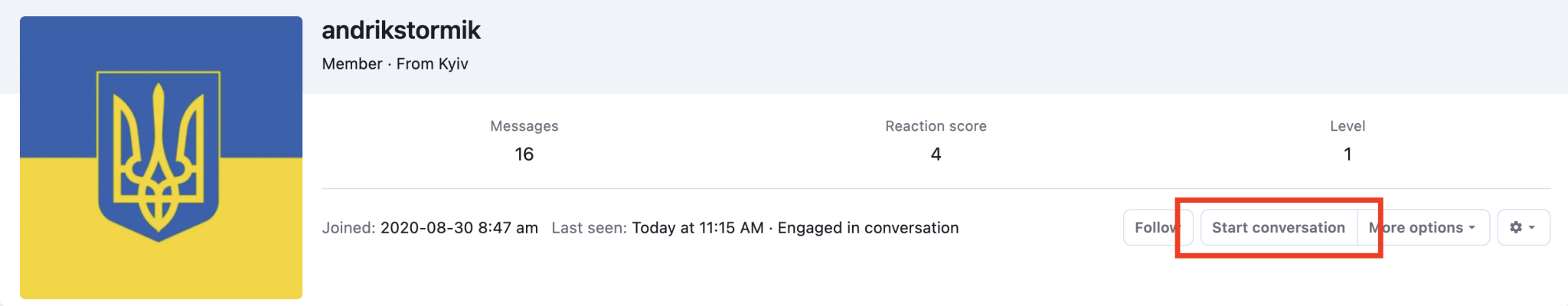

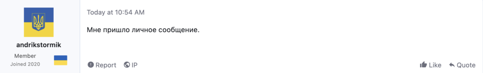

Neither can I. I will attempt to send you one and please reply.on this forum I can not send a private message.... I can not understand why so.
