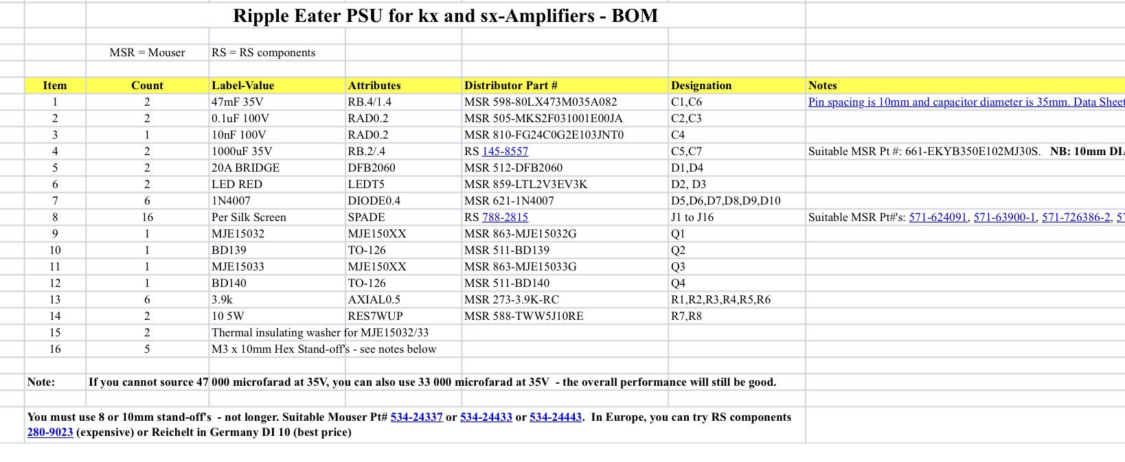

I fell in love with this amp and ordered two more with two ripple eaters. A newbie question, out of curiosity I'd like to try a different power supply than the one that came with the kit. Where should I connect the speaker return J1 ? The transformer is 19+19v ac. Also where can I find the ripple eater bom? In the bonsai site I can't download it.
It’s in Excel format. Should be downloadable.

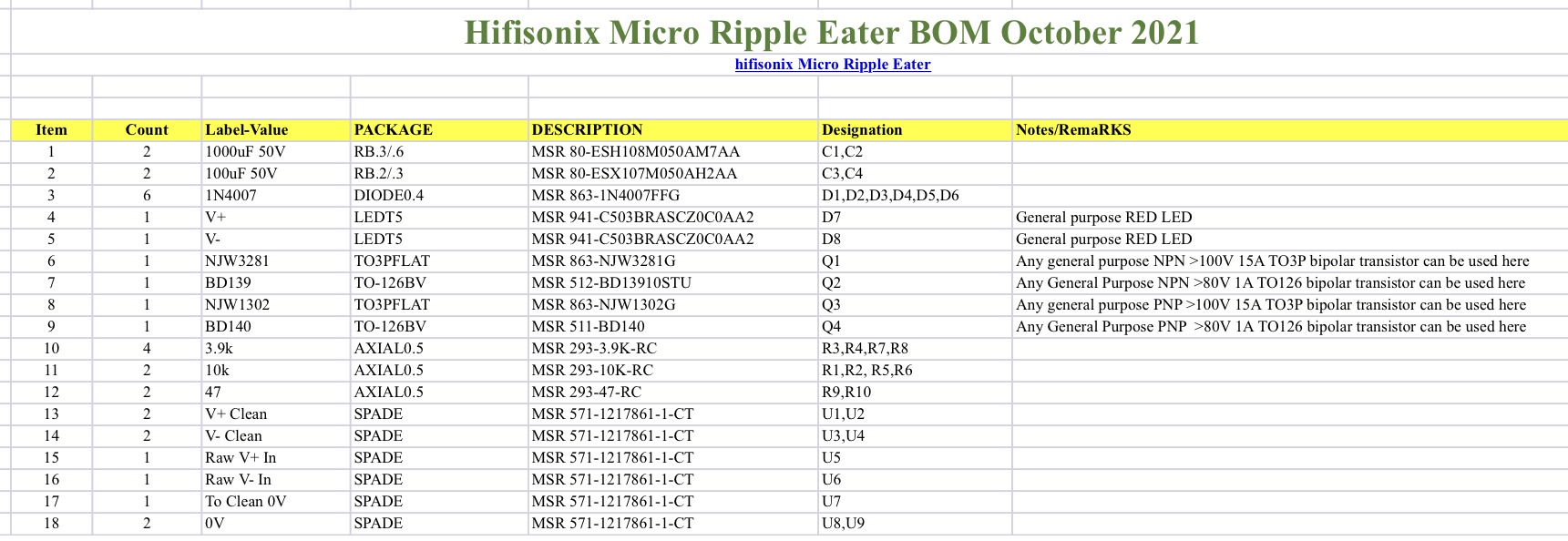

Is it the Micro Ripple Eater? This is only available from www.hifisonix.com. Here is the BOM :-
Here is the BOM for the ripple eater board sold only by Jim’s Audio. This one is a complete power supply with reservoir capacitors etc. Please replace the MJE1503X devices with NJW1302 and NJW3281 and mount the devices to your amplifier heat sinks. Any help you need, let me know.
Reactions: poseidonsvoice
Looks good Bonsai. Perhaps also add in the ‘notes’ section, the preferred option of NJW1302/3281 to make it stable for larger current demands like 2 ohm loads.

Hello,
it's shown as 47mF which is milli-Farad aka 47 000 uF 🙂

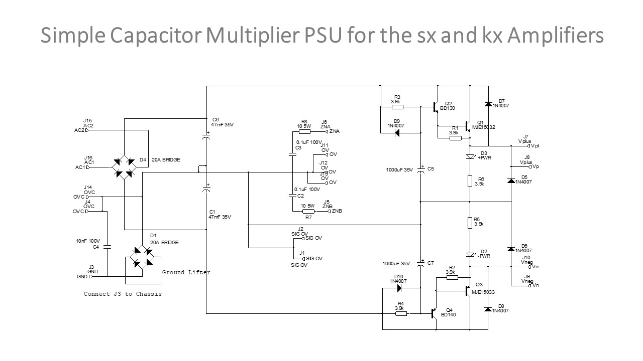

Per notes on the build page, it is recommended you use TO-3P or TO247 devices for Q1 and Q3 - see the build page here for more details http://hifisonix.com/simple-ripple-eater-psu-for-the-sx-and-kx-amplifiers/
If you are building a kx2-Amplifier, you can leave off R7, R8 and C2 and C3 as these are fitted on the kx2-Amp amplifier modules. For the sx and nx-Amps you will need them.
