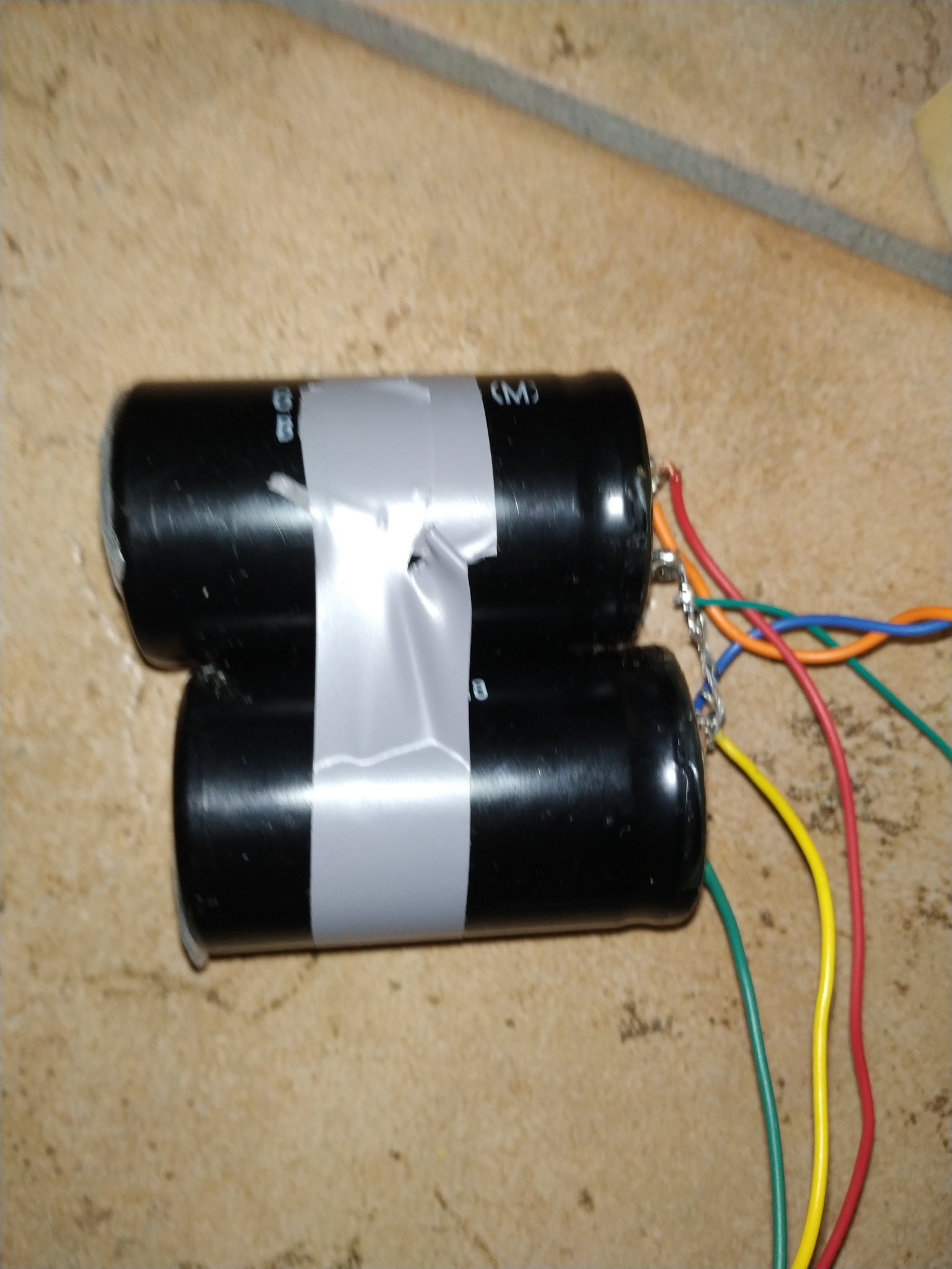

I confirm It, new capacitors but not working. It drove me crazy.Salve, ho sostituito l'alimentatore con due pessimi condensatori da 10000uF e sembra che l'amplificatore voglia far crollare il pavimento 🙂 . Forse un errore di montaggio sugli alimentatori? O cattivi condensatori?

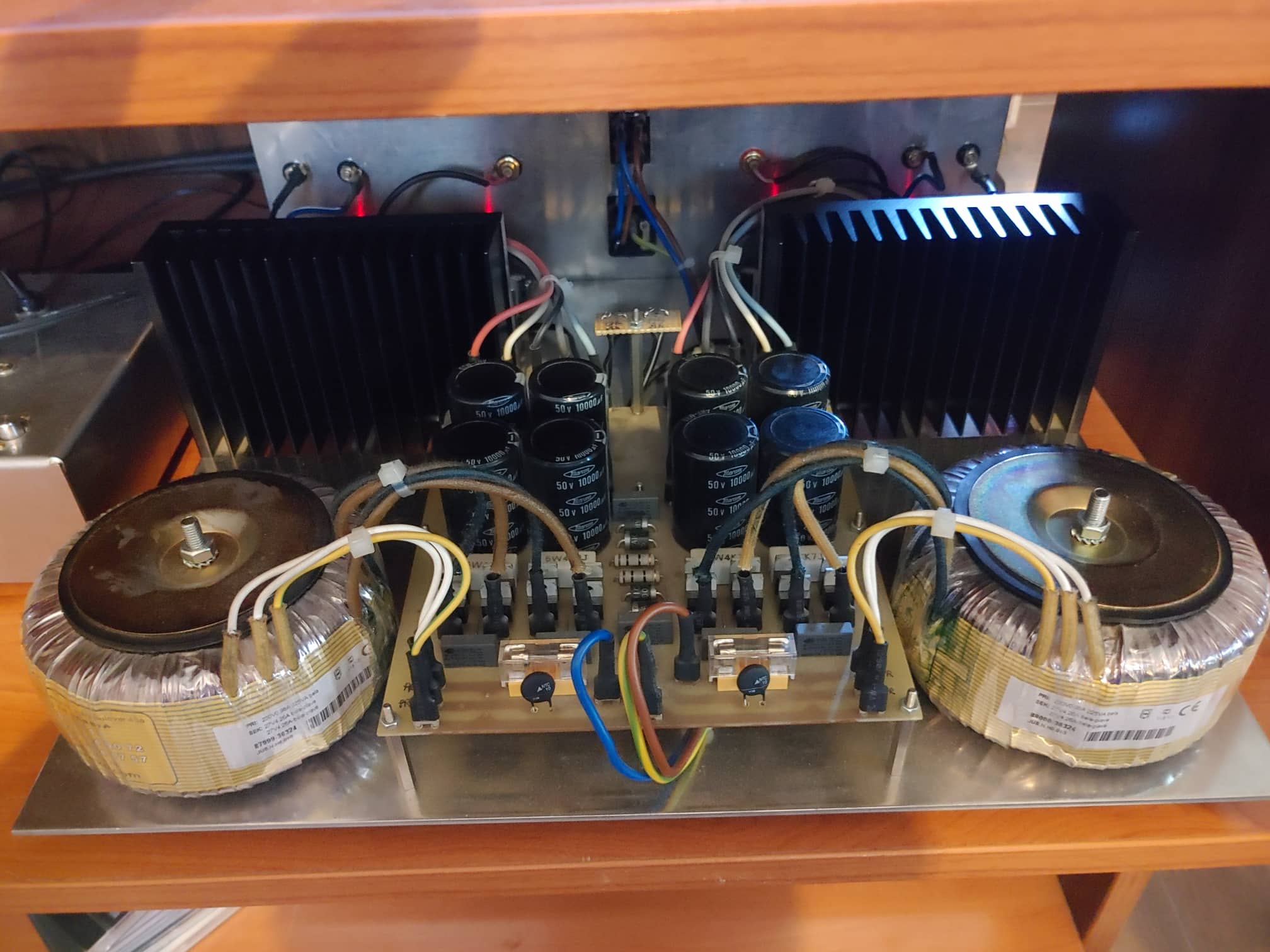

Hello Andrew,
As you suggested on the kx2 homepage, I'm sending you the necessary information.
So, I have a working DIY dual mono amplifier in AB class with 250VA transformers each, that outputs +-27V on secondary winding,
and I'm hoping that I can "transform" it to dual mono kx2 amplifier running in AB class.
So, the construction basically follows your guidelines, there is a PSU PSB and two amplifier PCBs, as you can see on the photo.
Since the heatsinks are not as big as the ones suggested in the kx2 documentation, do you think that this is possible and do you have any suggestions ?
Thanks in advance!
Filip.

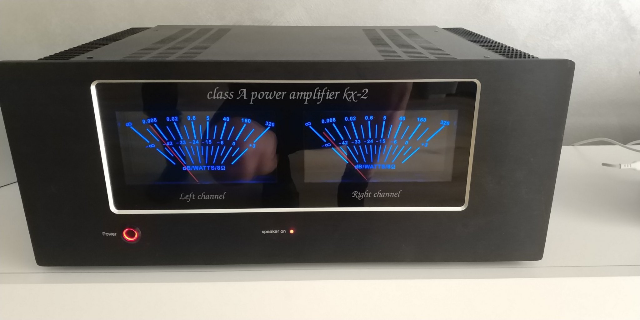

I want to show off my kx2 amplifier. Thanks to Bonsai for a great sounding amp, I think it looks great now too.View attachment 1070144
Congratulations!
Were you got those blue vumeters?

You can use the ones sajti recommends or you just use the same devices used in the VAS (1381 and 3503). There are no other changes needed to the design.
Unfortunately the 1220 and 2690 were discontinued after the Kx2 was released.
