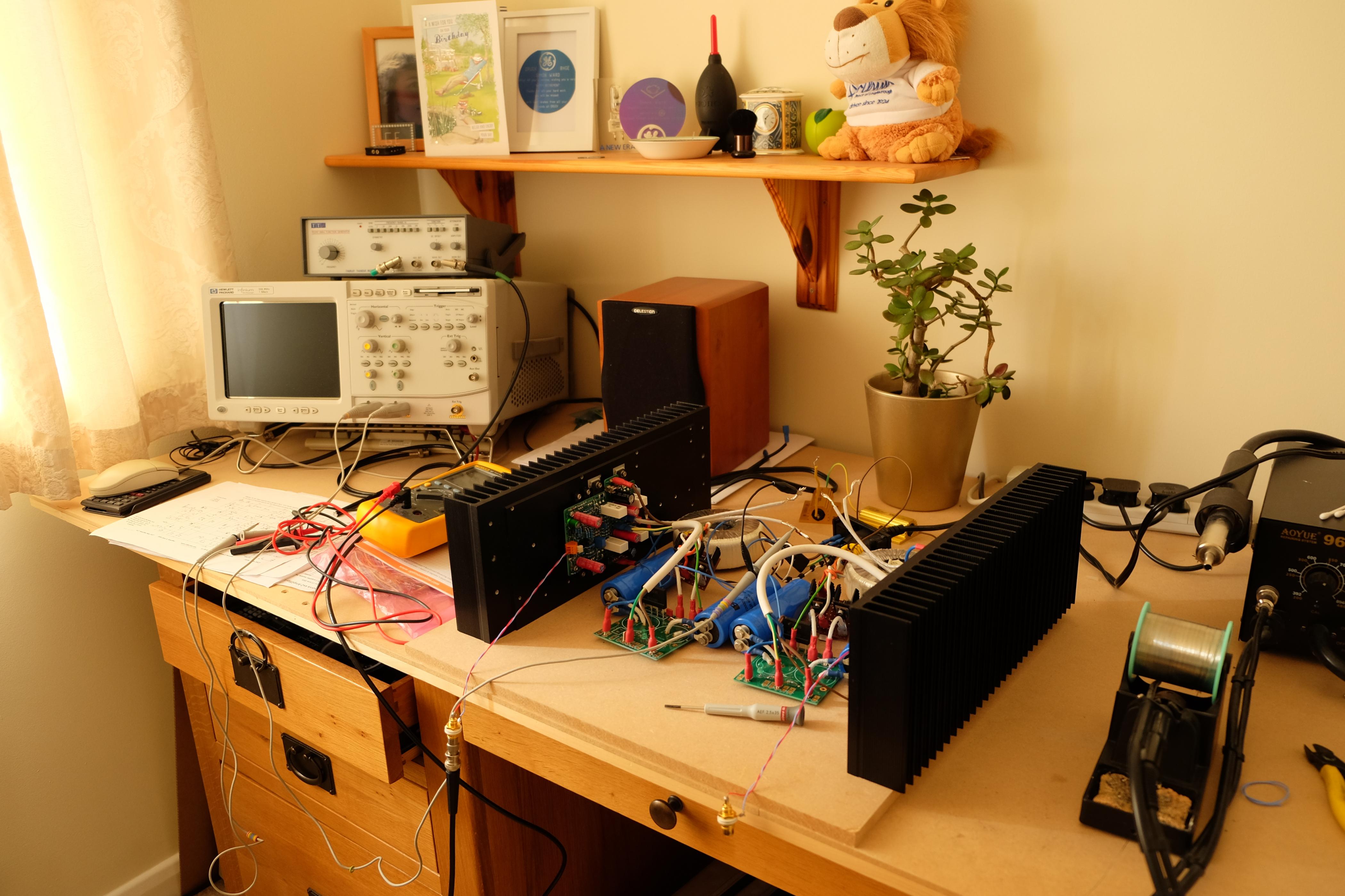

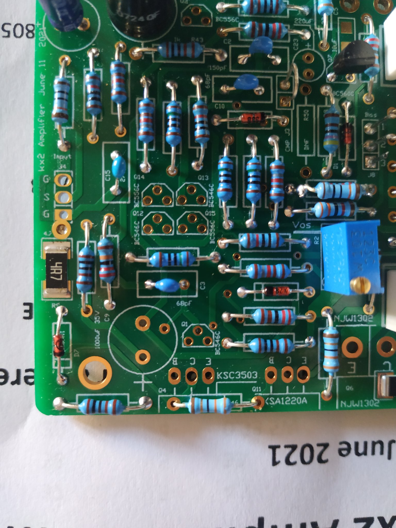

I managed to get all the parts ok, and have built the amplifiers. But have not cased them up properly yet. Despite that I have powered then up, tested them and had a listen over a few days. I have ordered some bits from Modushop to case them up properly. Surprisingly, I have hardly noticed any mains pickup. No doubt it will be worse after I box it up!
Measurements wise I have a couple of possible anomalies but most are close to yours. I didn't need to tweak the offset far from the pot mid position. So that's good. My transformers are both 200VA 19.7-0-19.7 loaded giving -+ 25 Volts DC. Run cool and quiet.
First thing I noticed was the Bias appears to be the reverse of pin 1 & 3. IE pin 3 is Class A not 1. I have on both channels 1.5V over R19 not 1.25. Over both pairs of output resistors I have 305mv Class A, 187mv Class AAB and 64mv Class AB. Which is odd. Not sure if that would be the lower rail volts or gain of Q7. Which are both gain of 505. Standing current is 0.975A Class A. Any advice on this would be appreciated Andy.
I have tried the amp on a pair of Celestion series A speakers which I have not listened to for a while. These are have very clear Mids, but tend towards over bright and edge towards harshness. The sound they created was amazingly good bright but not hard, Jazz Saxophone sounded lifelike. Great mids and tight Bass. Exciting to listen too with lots of detail. I have tried the amplifier with my Tannoy Floor standers. Surprised at the tightness of the bass, extended as well. Expected the clearer mids and imaging. All an improvement over Symasym. Sounded is more balanced than the Celestions, not so bright but imaging superb.
Attached a couple of photos of my lash up..

In "kx2 Transistor Amplifier Notes" Q12-13-14-15, they are BC546B BC556B, in the PCB are marked B546C B556C. Are they substitute? Unfortunately BC are not available for the next few months, my amp will get covered with dust.🙁
You can use C or B versions. Just make sure the are gain grade matched like this:-
Q12 and Q14 must both be either B or C. Do note make say Q12 B and then Q14 C
Q13 and Q15 must both be either B or C. As above, don't mix B and C

Terps, apologies I only just saw this post of yours now.I managed to get all the parts ok, and have built the amplifiers. But have not cased them up properly yet. Despite that I have powered then up, tested them and had a listen over a few days. I have ordered some bits from Modushop to case them up properly. Surprisingly, I have hardly noticed any mains pickup. No doubt it will be worse after I box it up!
1. The gain of 505 for Q7 is perfect and should not be causing you any problems
2. Your standing currents are a bit on the low side. Can you check that R18 is 220k and then R1 = 18K and R48 33k.
3. Note if you have these resistor positions swapped, the class A and class AB will be swapped on the switch
4. Long shot, please check that C5 is not leaky
5. I assume you are using 1% tolerance resistors for the 1/2 watters but 5% for the 0.33 Ohm 5W ones.
6. Can you conform that your bias stability is good once the amp is warmed up?
Once you have boxed your amp up, provided you keep the supply rail cables tightly twisted and the same with the speaker cables, you should have an amp that is as quiet as your bench top lash-up or better. The noise floor on the kx2 in class A mode at 15W RMS out is very low at about -115 dBr.
Happy to hear you liked the sound!
