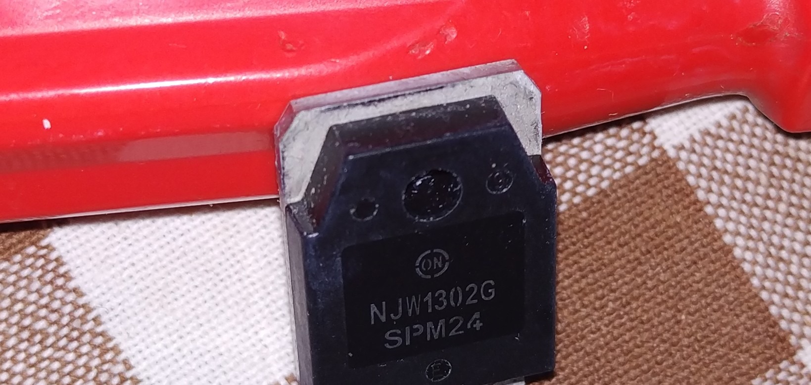

A: R12 10,0 mV - R14 8,6 mV - R13 27,8 mV - R15 29,4 mV ------ R10 0,456 mV - R11 0,455 mV
B: R12 7,9 mV - R14 7,4 mV - R13 26,4 mV - R15 23,8 mV ------ R10 0,454 mV - R11 0,456 mV
power supply AC 19 Volts DC +- 27
There is a lot of difference between emitter NJW 3281 and emitter NJW 1302 compared to 0 volt.
R10 and R11 do not look right. You should be measuring about 560mV (that's about half a volt), not 0.45 mV. If you are in fact measuring 456 and 455 mV then that's ok - but please recheck.
The voltages across R12-R14 and R13-R15 are all on the low side. You should be measuring about 40mV across each resistor in class AB mode and about 65mV across each transistor in class AAB mode.
Can you measure, wrt the output (ie the output side of L1) the voltage at the collector and the emitter of Q7. You should measure about 1.3V to the collector and then -1.3V to the emitter.
