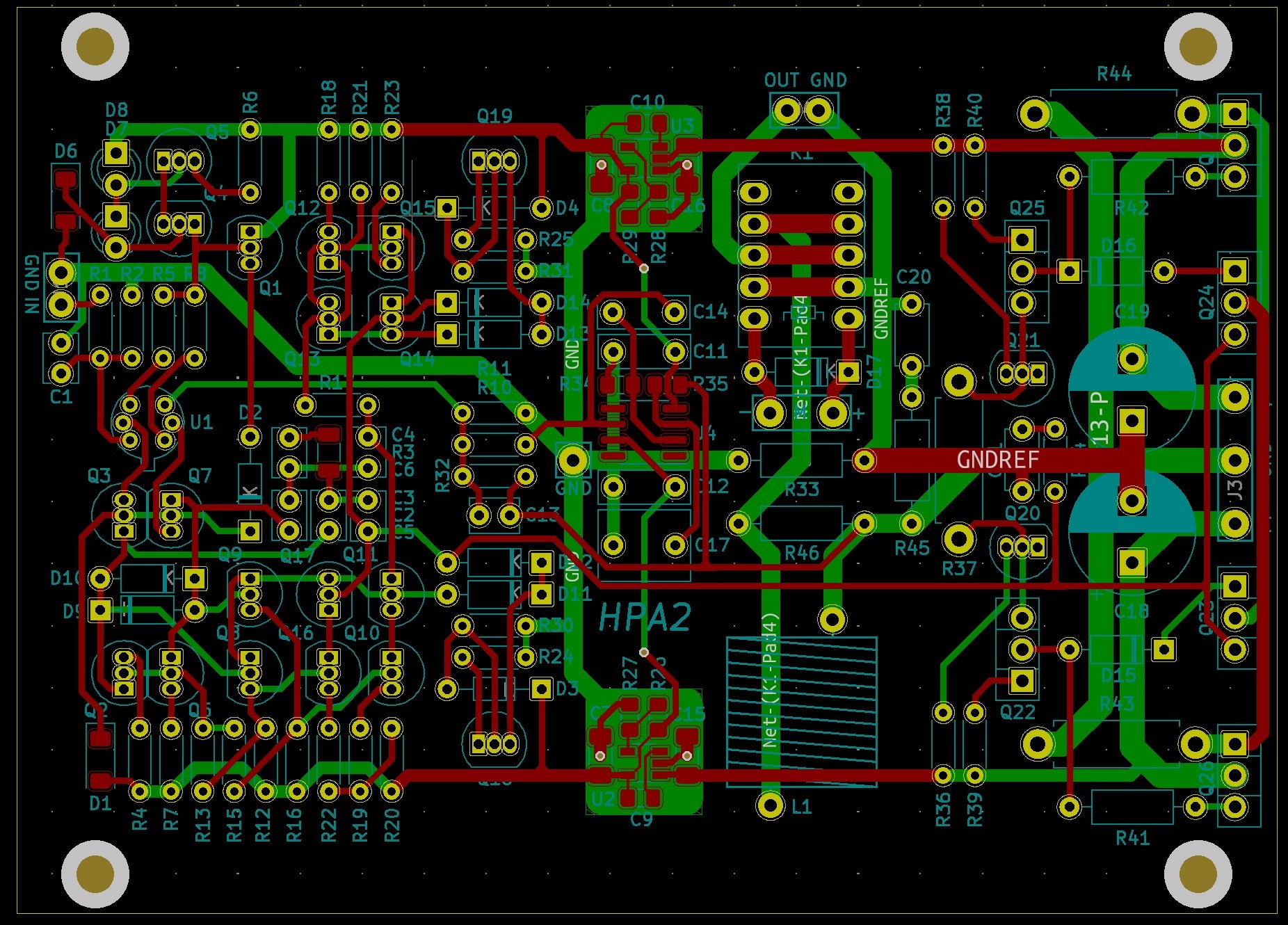

Since no one objected to my proposed PC board change

Yeah, the proposed change has that backwards, which is why I hesitated. If this were a high-speed or micro-stripline circuit, I would worry about reflections and parasitic inductance and so on. Not that I have any experience with high frequency circuit boards. I am convinced that these effects don't matter below 10MHz, which is well above the internal bandwidth of this amplifier. The wavelength is around 1000 feet at this frequency. Reflections still happen, but the phase angle differences are so small as to be insignificant, at least in theory.
I think you can go overboard fussing over PCB symmetry. There are plenty of fine amplifiers that aren't even close to symmetrical. The word that comes to mind is "precious." It can seem too self-conscious. It's time to just order boards and stop trying to impress the magazine photo editors.

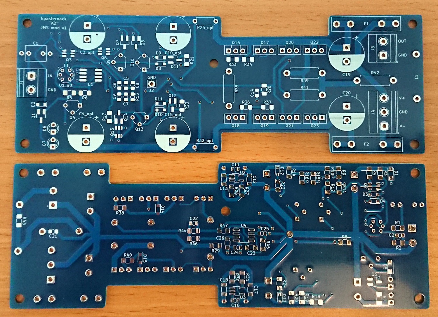

My own wait is over! This is a long and skinny layout of Henry’s A2 amp that is designed to be mounted to the walls of a 2U enclosure. I’ve also already found a problem that I didn’t spot before sending the gerbers off, but should be OK to work around it. I’m looking forward to finding some time this weekend to start the build.
Thanks Henry and others for a very enjoyable thread and to Henry for all of the comments and suggestions on the draft layout.
Looking forward to hearing about your progress on the A3! 🙂

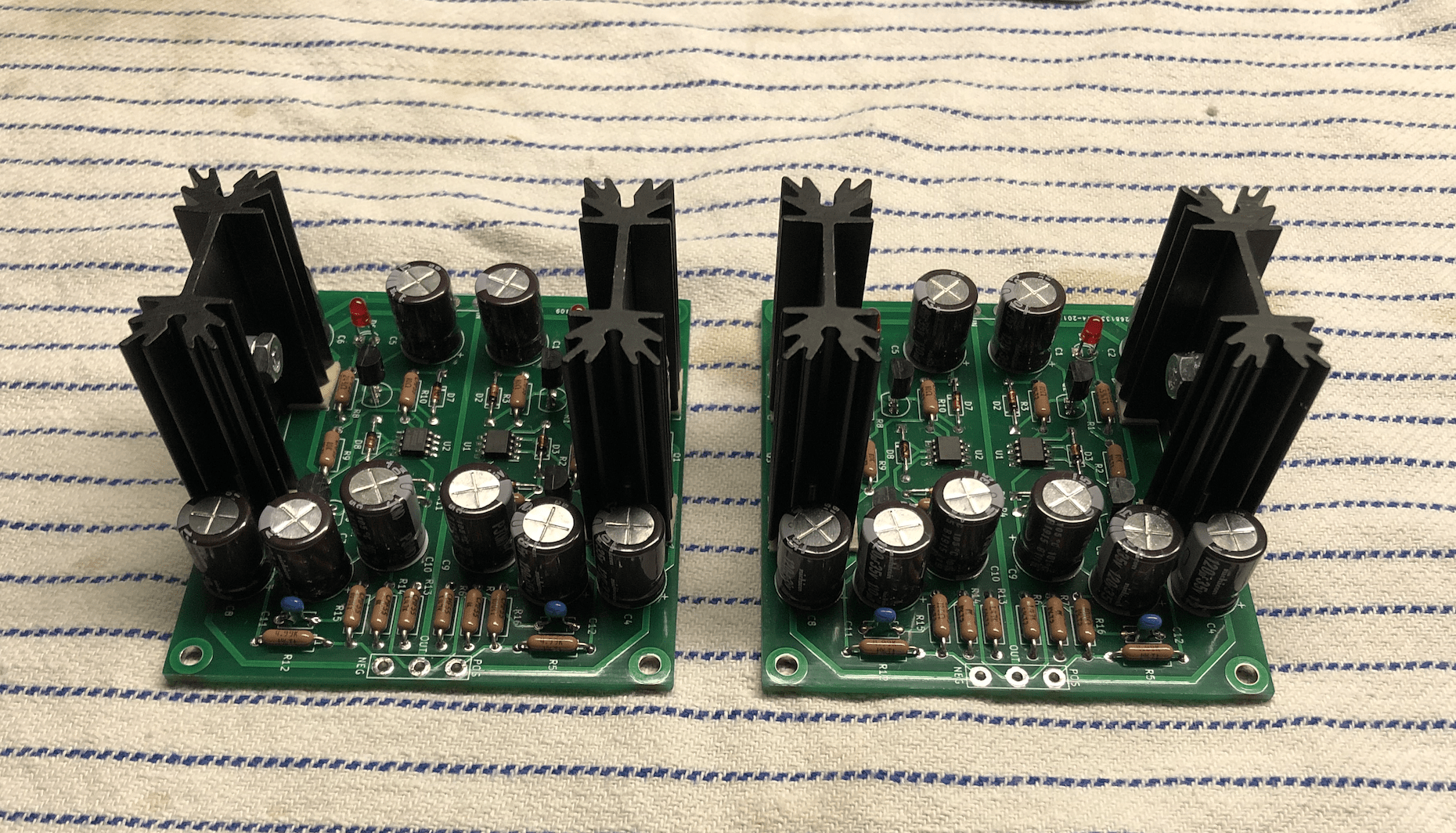

I've had good results in three different projects now with my version of the Jung/Didden Super Regulator. Assuming my layout is good, performance should be on par with the diyaudio store version, which in turn should outperform the HPA-1 Darlington follower on paper. Super Regulators are reputed to work well in subjective tests, but who knows what that means in this application?
Awesome. I'm super keen to hear how this works out for you.

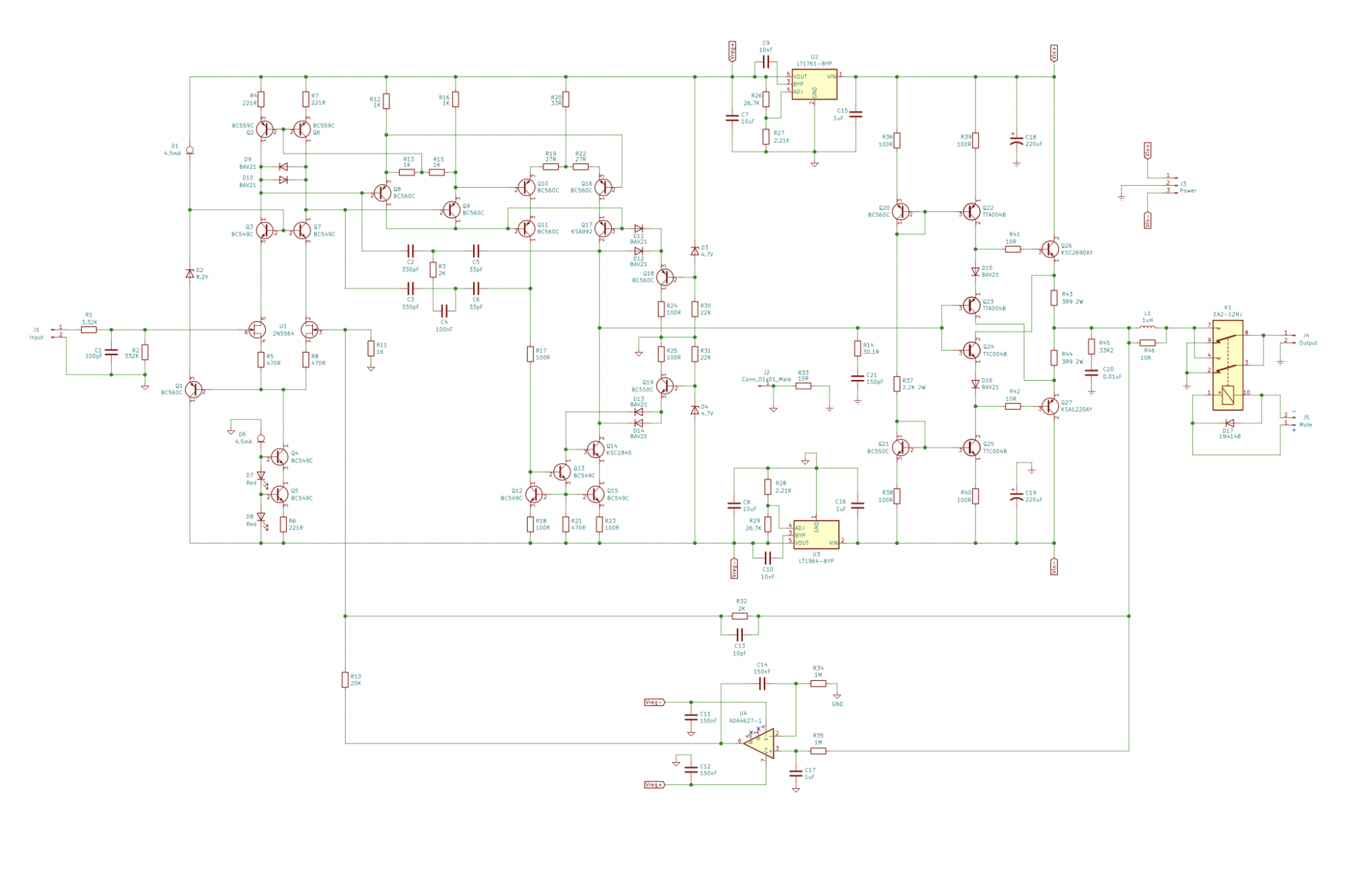

Hi, Jam. A2 is the new name for my HPA2/Cordell amplifier. It's the same as what I sent you privately a while ago. The schematic posted way back in this thread may be a little out of date, but for people who are interested, I can send a link to the latest Kicad files.

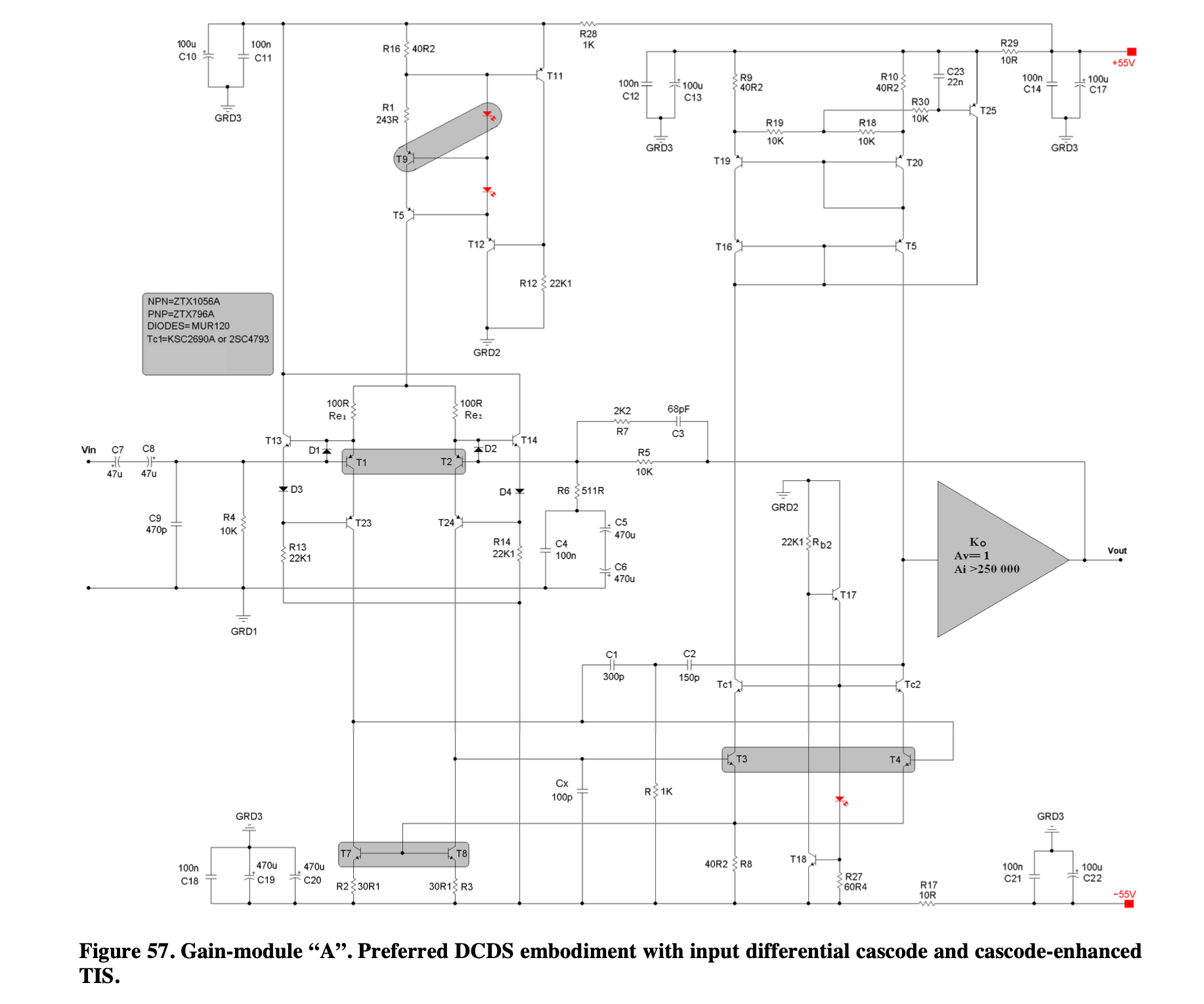

I don't remember if I mentioned this before, but there's a thread on the Solid State forum describing an ambitious power amp design based on the same Cordell schematic as my A2: https://www.diyaudio.com/community/threads/vfa-front-end-the-bunnyphant.369957/
The OP pulled out all the stops on this, including a diamond buffer output stage with four pairs of output transistors, multiple compensation networks, and every trick from Bob Cordell's book. Getting it stable has been a problem, but they've made progress.
I mention it because OP has been reading Kiwanuka's paper and the referenced "DCDS" circuit which has some similarities to Cordell's front end.
If you take a look at the compensation circuit in the lower center of the diagram, you see a single-ended TPC network, and then a 100pF capacitor labeled Cx. I've written here before about how my "flying" balanced compensation scheme in the A2 doesn't work as I thought it did because the mirror impedance on the left side is essentially an AC ground. With no voltage gain on this side, Miller compensation isn't happening. That's why Kiwanuka has Cx, and not a duplicate of C1/C2/R in his diagram, which I mistakenly tried to implement in my circuit.
As Kiwanuka points out, there are two signal paths through the front end, which are summed in the mirror, and if you only compensate one of them you end up with a non-minimum phase response and something less than the desired single-pole, -20 dB/decade response. So he puts in Cx and adjusts its value to get the optimum slope, combining the responses of both sides of the VAS.
I've been wondering why my compensation scheme works. It occurred to me just now that the left/lower leg of my A2 compensation network, being connected to a low-impedance node, is probably acting something like Kiwanuka's Cx. There's some real subtlety there because the compensation current goes into the mirror, not ground, and the resistor in the network is floating instead of connected to ground (or the rail).
In principle, you get much better PSRR keeping that resistor referenced to the supply rail instead of ground. That was my intent for the "flying" network to begin with. Somehow, this thing sorts itself out and ends up with the proper slope and phase shift, at least according to SPICE. You can see the simulated response is picture-perfect:
I'm nervous as always about releasing this design with a detail I don't understand and suspect is wrong, but I can't argue with success.

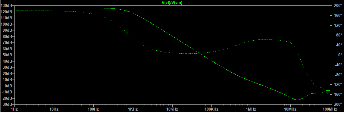

Another thing I learned recently is why my loop gain plots always show a rise above 10 MHz. I got some good information about this from another thread. I followed instructions on how to insert a voltage probe for loop-gain simulation from an LTspice video on YouTube. It turns out you really need a full Tian probe (it is left as an exercise for the reader...) if you want to get accurate results. Tthe partial probe I used doesn't account for current flowing in/out of the inverting input. The high-frequency rise is due to capacitive effects in the input pair which the Tian probe would account for. Fortunately, with JFET inputs, the input current is low enough not to seriously mess up the plot over most of the bandwidth of interest.
The Tian probe is much more work to set up in SPICE and I haven't gotten around to trying it yet. But I want to because I'd like to better understand the circuit behavior at the high end of the frequency spectrum.
I know this is a little esoteric, but I want to keep people up to date as I learn new things about this design.
