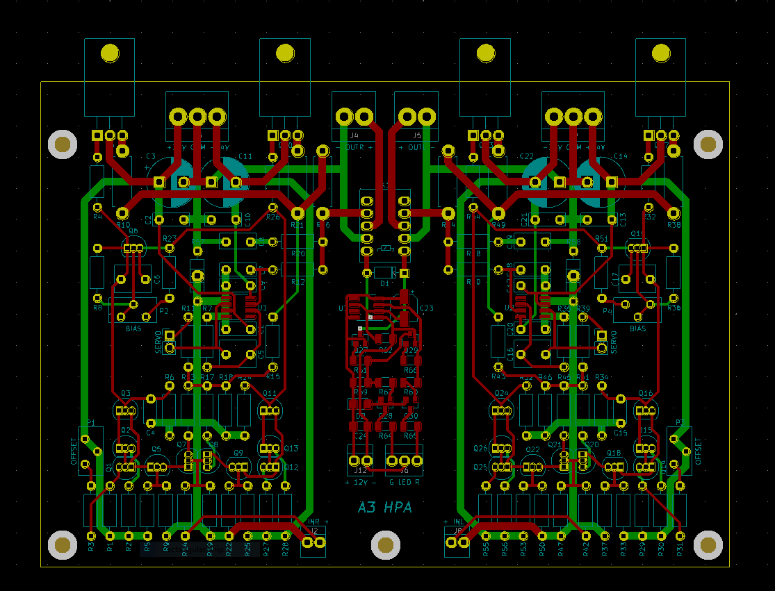

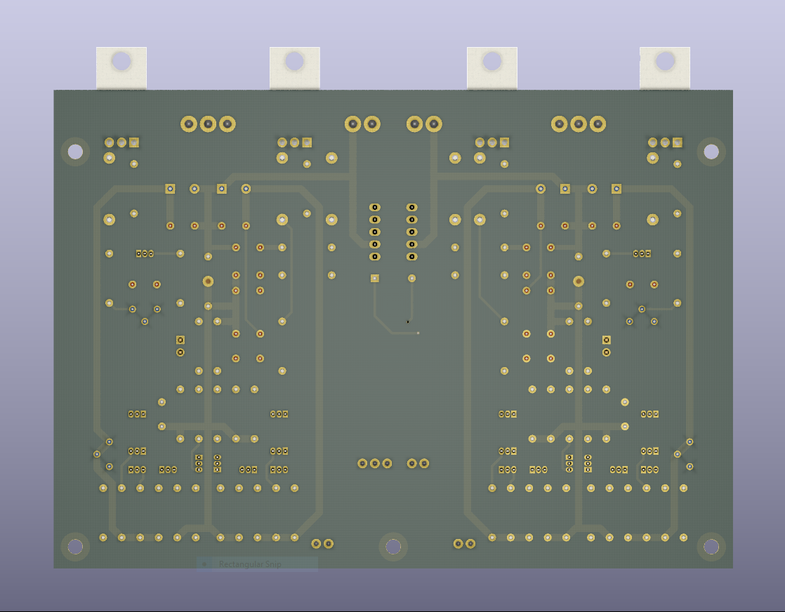

The layout looks great, care to share how the bottom layer looks?
Sure. The main update for today was to the relay circuit. I hadn't changed the signal layout at that point, which is why I just posted the one image. Just now, I did some minor work around the bias spreaders. And I've made many, many small adjustments, aligning things perfectly and so on.

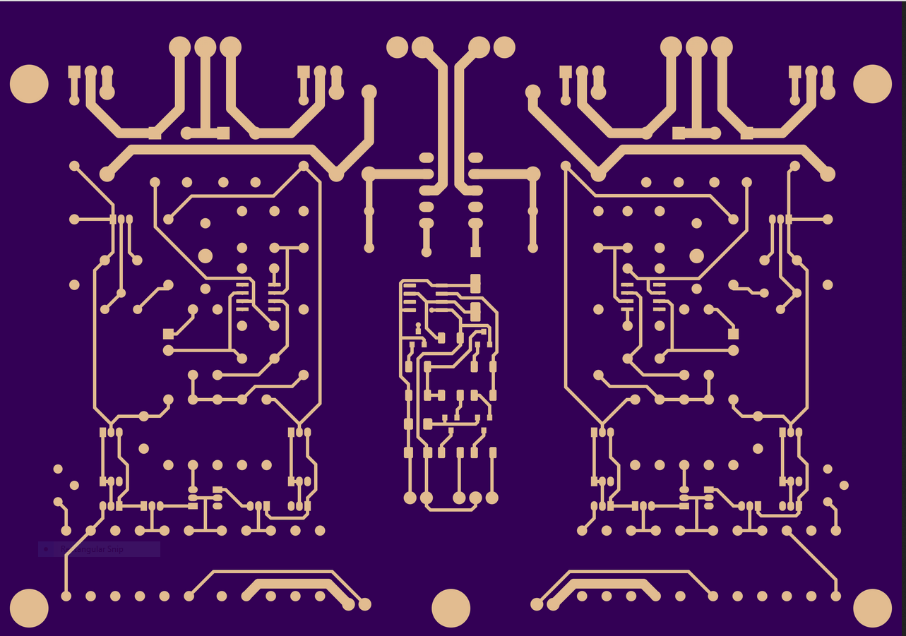

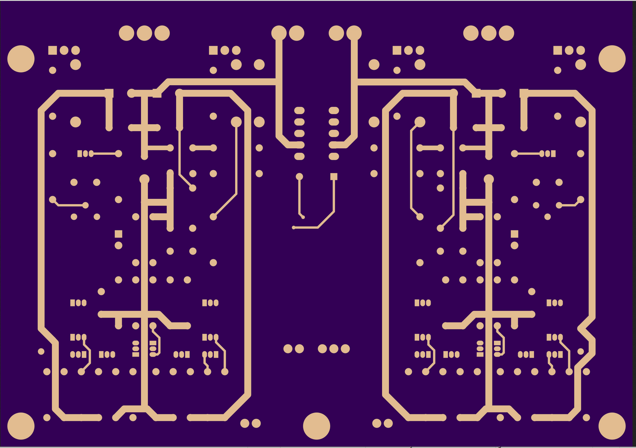

I like the OSH Park Gerber viewer for design verification. I'm trying to decide if it's worth spending $106 for three boards to get ENIG finish and support the home team. I'm not very fond of purple.
Maybe try their "after dark" service instead? I used to order those PCBs all the time before I had to pay import stuff for every Oshpark order. Click the spoiler for an example. It costs just as much, you just have to tick the right box after adding the design to your cart. Oshpark is really great for tiny PCBs because they exclusively charge by PCB area, for larger ones it gets expensive quite quickly.
Good suggestion. The After Dark option is cool, but for some reason I can't decide if I like it or not. Probably the best thing to do is to build the prototype on a cheap board so I don't waste a lot of money if I need to make changes. If I really have the urge to build one of these on a gold-plated board, I can always make another one later.
BTW, reviewing the purple images above, I spotted two errors from my changes tonight. They're on the inboard traces connected to the bias pots. So no need to call those out if you see them, but if anyone finds anything else, by all means let me know.

Henry,
That is one awesome looking board..... you got me beat.
One small comment....one of my mentors insisted that traces should enter pads at 90 degrees whenever possible.........so this is a no no according to him.😉

Thanks so much, Jam. LOL, that is one of the mistakes I mentioned above. I moved two resistors up and forgot to fix the traces on the bottom pads.

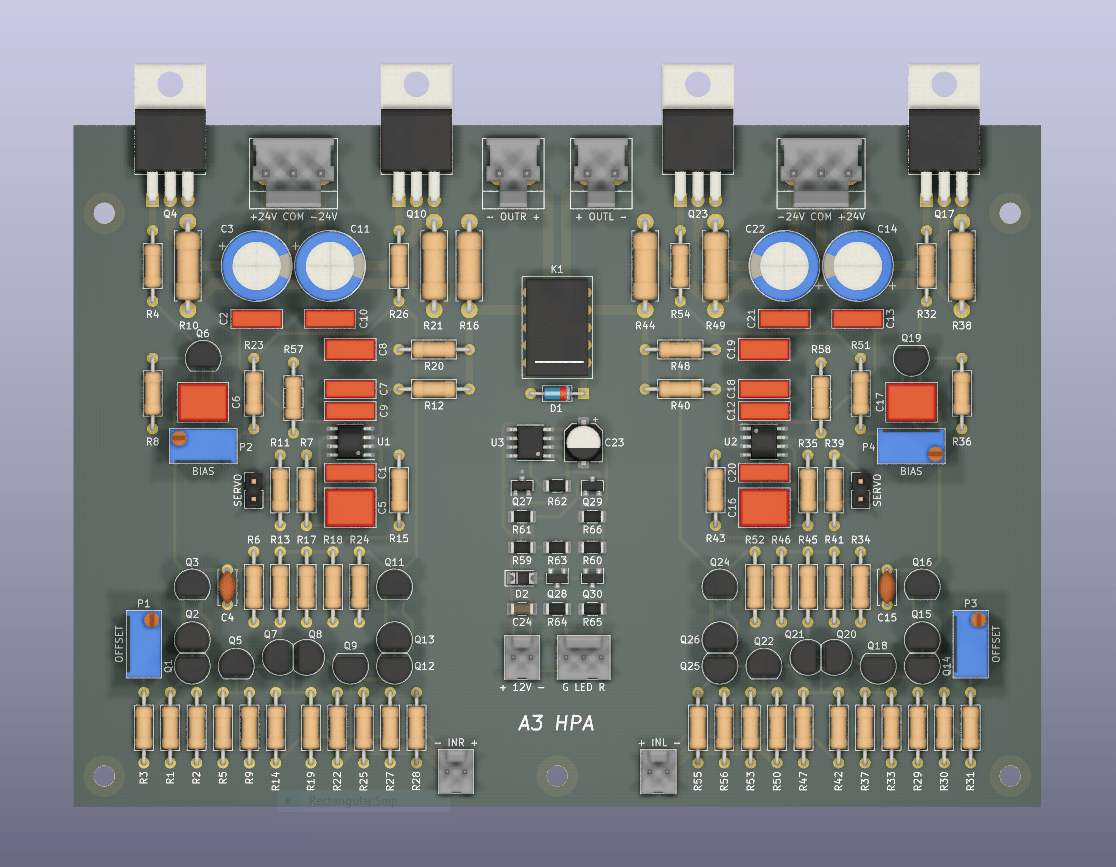

Henry,
One suggestion with your layout - and only that - is that in my experience a long line of resistors can confuse with stuffing and should be avoided.
Along the bottom of each channel, you have eleven resistors in a row. If you break it up with larger gaps to say 4, then a gap, then 3, another gap, and then another 4, stuffing them is easier to select correct resistors. This breaks the memory issue to only 4 max resistors, not to 11. It is not better in terms of appearance or function, but it can reduce stuffing errors.

Cosmetically maybe, but otherwise you gotta be joking.One small comment....one of my mentors insisted that traces should enter pads at 90 degrees whenever possible.........so this is a no no according to him.😉
Electrically you have a point but there are other issues to be considered. My friend was a profesional board designer and insisted on using a set of best practice rules for consistancy. In real world applications when tiny traces are used to attach to a pad at the wrong angle it can cause etching problems during the board fabrication process, which could lead to a weak connection. They are known as acid traps.
Most designers are aware of the problems caused by acute angles in a circuit board and are therefore trained to avoid them. However, mistakes do happen. Often, PCB acid traps are the result of simple human error, although some design software programs may also set circuits to acute angles if the settings are not properly adjusted.
Now on the other hand some audio designers insist on not laying out right angle traces (lose electrons when they spill over the edge
) Seriously this has large ramificaions in RF design. Having a set of guidelines and rules can't hurt, surely, it leads to better and more consistant designs and products.

Thanks for the PCB suggestions. I've read that acid traps are less of a problem nowadays because of improved production techniques, but I try to avoid them anyway. Traces entering pads at off angles look bad, though, IMHO. WRT breaking up long rows of resistors, that's a good idea and I will incorporate it in my next design. I used to avoid "tee" junctions but apparently they're not a problem for low-speed circuits so I use them sometimes. For instance, the output ground traces are tees. I played with changing that and couldn't decide which way I preferred. The electrons probably don't care.
I have this acute angle here, and it annoys me. I may change it, but for now I've decided it's the best compromise for mainly arbitrary aesthetic reasons.
It would be nice for the vertical trace going to that pad to be the same distance from the board midline as its twin on the other channel, but then that forces me into another compromise.
