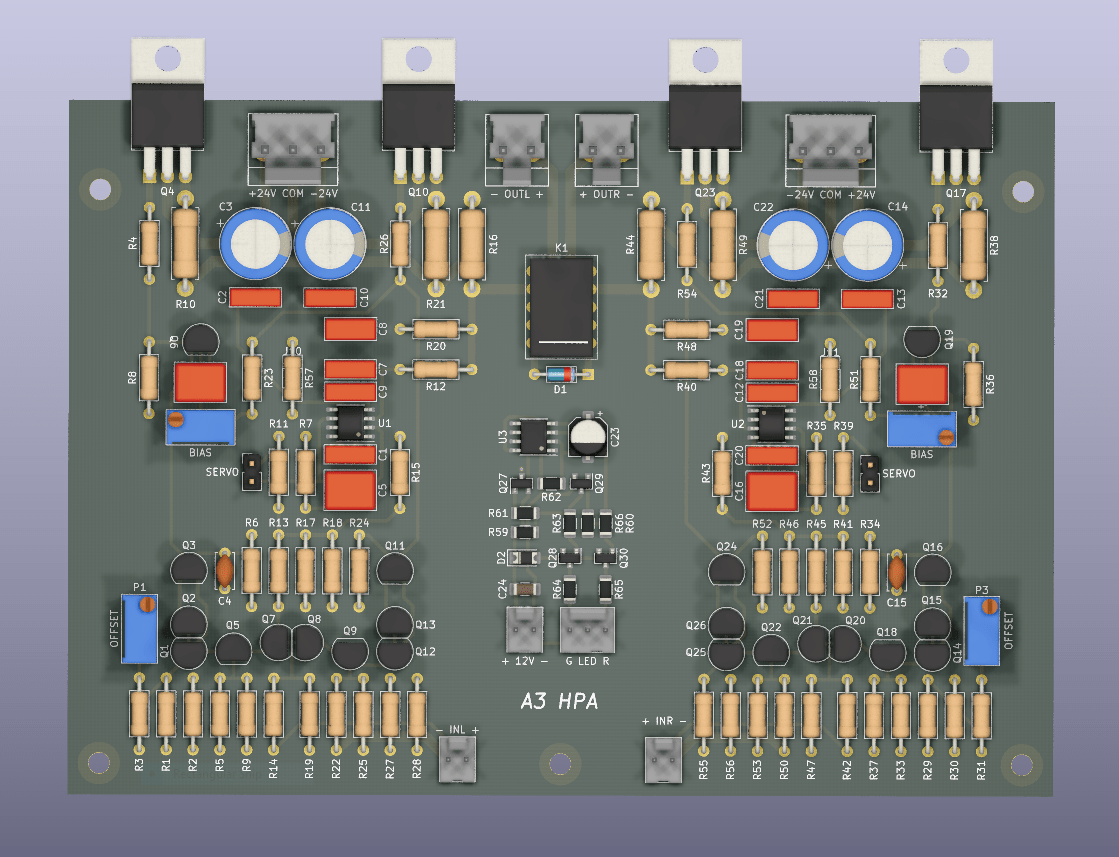

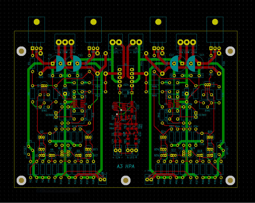

I'm still revising the layout. It feels a little cramped and busy to me.

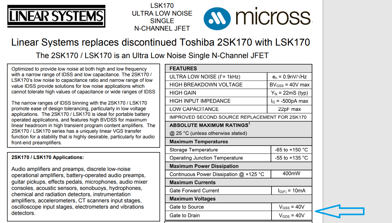

I don't know the answer but in the Linear Systems datasheet for the complement (2SK170/LSK170) the breakdown voltages appear to be symmetric. This might be a clue. If anyone know for sure please post a reference.
Good observation. I think the odds are in favor that the transistor can be used in either direction without any problems. I do wonder whether Jeff made a conscious decision to do it this way, or if he just didn't think about it. As I said, I prefer to hide out over here, but you might ask him in the official thread.

I've been spending hours working on the board. I substantially improved the organization of the resistors around the offset trimpots, and also cleaned up the relay driver. I've been checking everything very carefully, adjusting track registration, removing orphan traces, and trying to make the layout as symmetrical and precise as I can.
I was looking at other people's boards in the main thread. It's impressive how many good implementations there are, and how each designer takes a different approach. I think my own board is looking quite good now, though many of the changes will have no effect on performance, and you might not even notice some of them.
I don't know if anyone is interested in this, but I spend a lot of time just looking at the layout and trying to understand the flow of the circuit. If the layout is good (to me), it feels clean and unstressed. In a lot of ways, this work is like editing a text document, reading it over and over and trying to express myself as clearly and concisely as possible.

Well, this is all for today. I feel like it's close to a release candidate. I need to adjust some of the parts designators, and I think the relay connectors need to move down a little bit. I'd like the relay circuit to be more symmetrical, but it's not a symmetrical circuit, so the heck with it. Overall, the board seems like it's logically laid out now, and not too contrived.

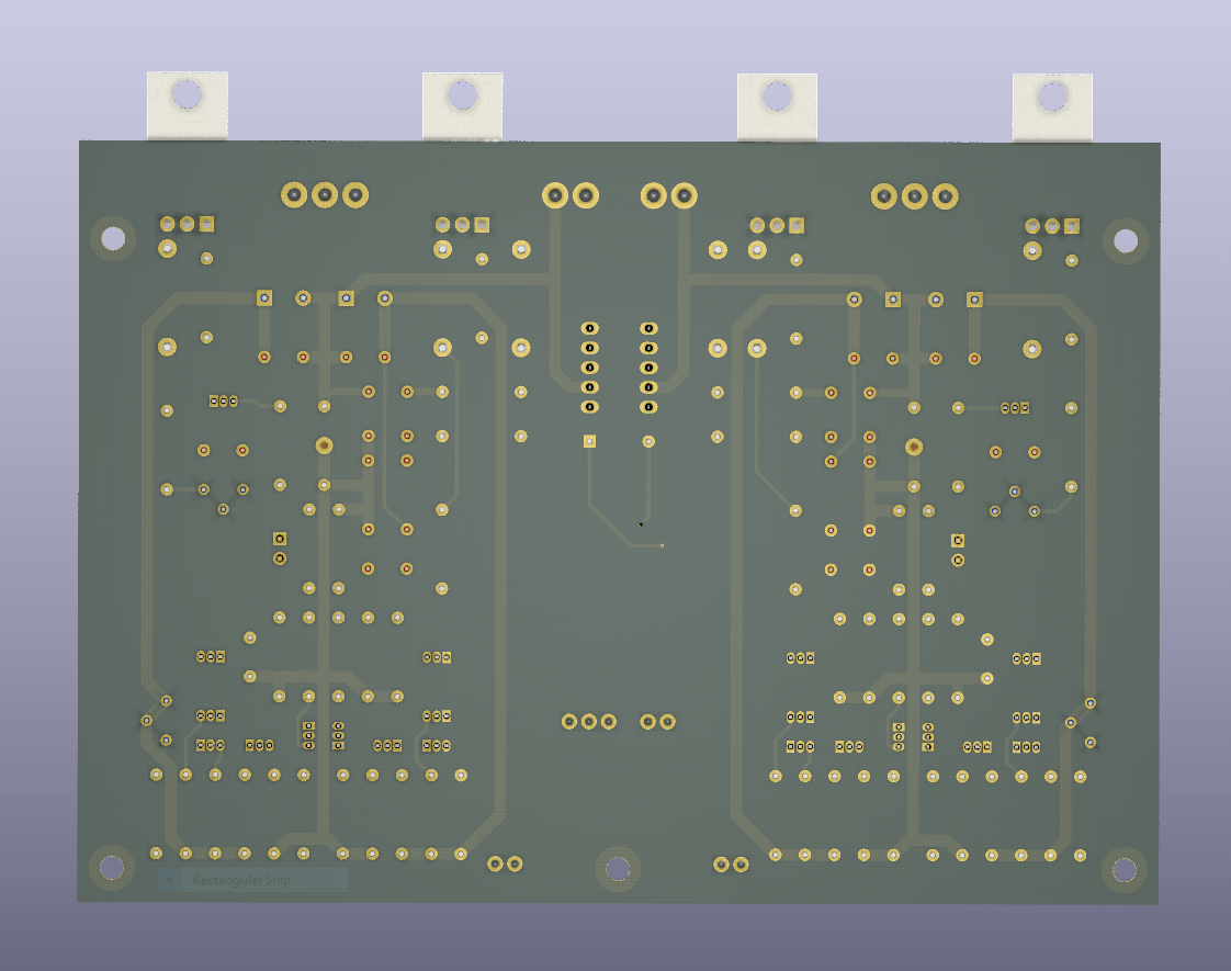

So, looking back, I've posted four versions of this board. To me, that's like eight or ten hours of painstaking work since the initial layout, and each change SO important that every revision MUST be published. From the perspective of the casual viewer, meh, looks pretty much the same. LOL, I will stop posting my drafts.
I know that feeling - hours and hours of scrupulous work, all but invisible to those who haven't had their head stuck in you circuit gubbins 😀.So, looking back, I've posted four versions of this board. To me, that's like eight or ten hours of painstaking work since the initial layout, and each change SO important that every revision MUST be published. From the perspective of the casual viewer, meh, looks pretty much the same. LOL, I will stop posting my drafts.
Looking good!
Henry,
I apperciate anyone thst can layout a symetrical complementary circuit, looks like you understand the concept.
You have to learn to think up side down whlie being laterally inverted 😵 not an easy skill. This is not much a problem with two terminal non polar devices but when you introduce three terminal devices like transistors or fets, the hurt begins 😢. Some people have a difficult time or just plain can't do it. It took many hours for me to layout the attached board (complementary circuit- amp front end)
. It will get easier with practice.
It gets really hairy when you have to layout a balanced complementary symmetry design as in the second example.
Keep up the good work.
