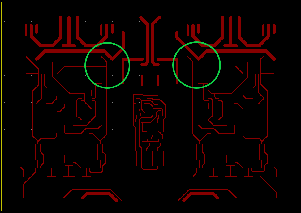

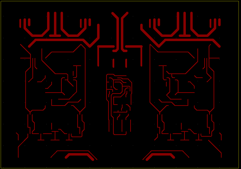

I told myself I wasn't going to ask for layout advice, but I'm going to do it anyway. The two long vertical traces connect the front end to the OPS gate resistors. I can even things up at the cost of two tee junctions as shown below. As I said before, I'm not really opposed to tees, and the signals don't care at audio and low RF frequencies, but it's supposed to be bad style. So I throw this question out for opinions, do you think this is an improvement?

Since no one objected to my proposed PC board change, I've decided I will go with the new scheme. At this point, it's more playing games for appearance than anything else. I will make one last check, then order boards, possibly today. Tonight if I have the energy I will create a BOM and order the passive parts I need (as mentioned before, I have all the semiconductors already). I think I'll just go with JLCPCB, so in principle I could have a board ready to test within a week and a half or so.
