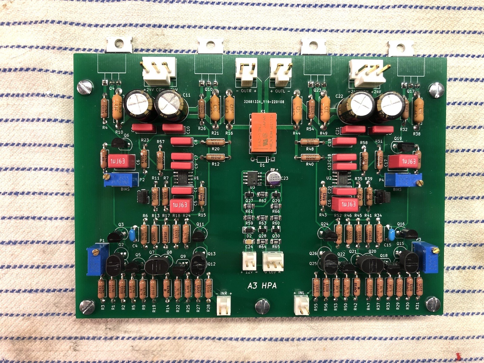

The board is really quite small (4" x 5.5"). It's kind of funny; this doesn't feel like the Mighty Pass Labs HPA-1, LOL. But, of course, we need to wait and see how it works with headphones.
One thing that surprised and slightly annoyed me: The TO-92 footprint I used is pretty tight and the folks at JLCPCB scribed the board between some of the pads, presumably to remove short circuits following the hot air solder plating. They didn't do this on any of my previous boards. It doesn't hurt anything, and is hard to notice, but it's not a super-duper feature.

Second channel is done and tested, same as the first.
I discovered this morning that one of the MOSFETs I installed yesterday had been damaged. The case had a chip in it and the mounting tab was bent. I replaced it. Bummer, but I ordered eight of each type, so I have plenty.

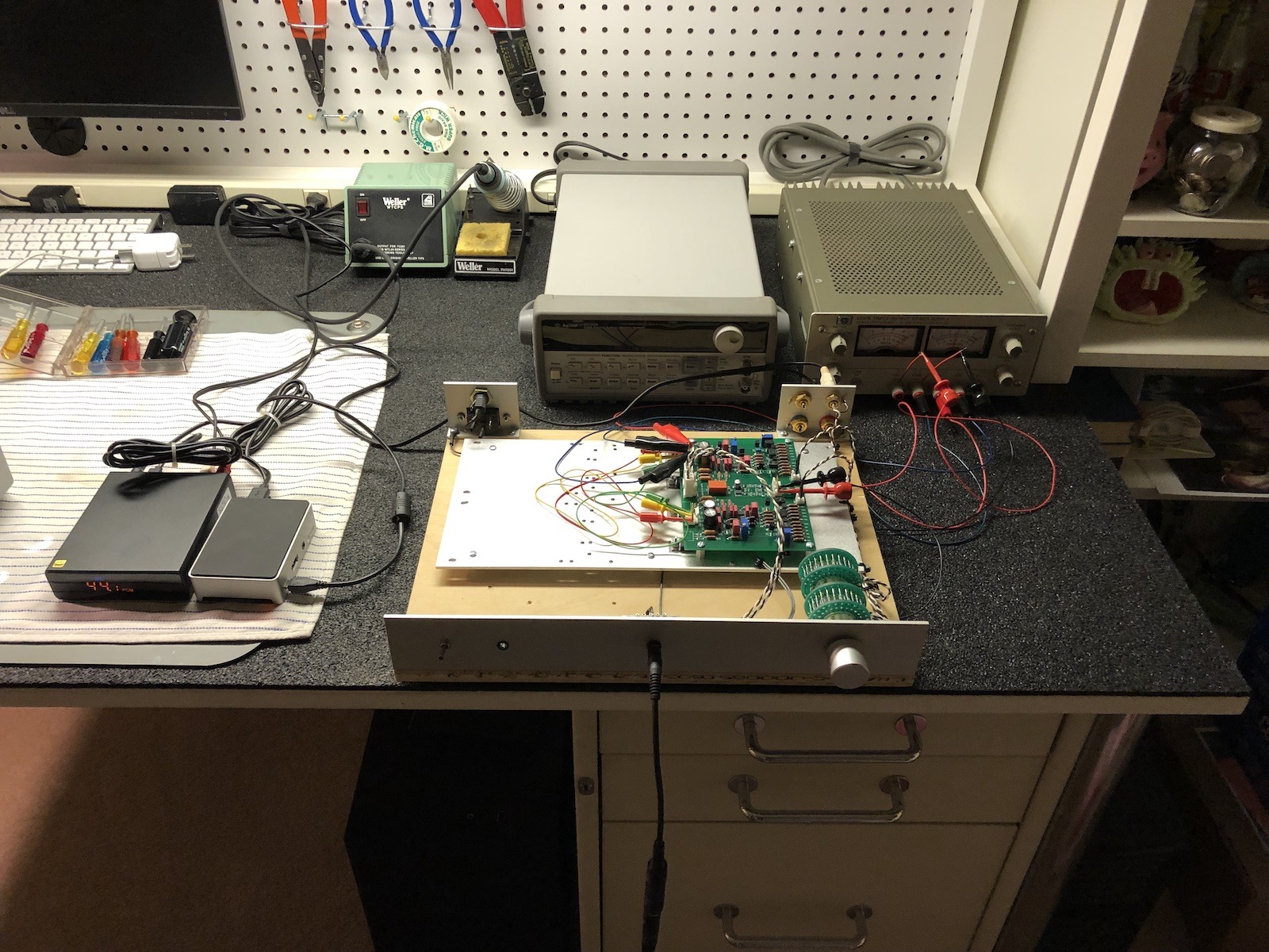

Well, well, well. I am listening to this thing right now.

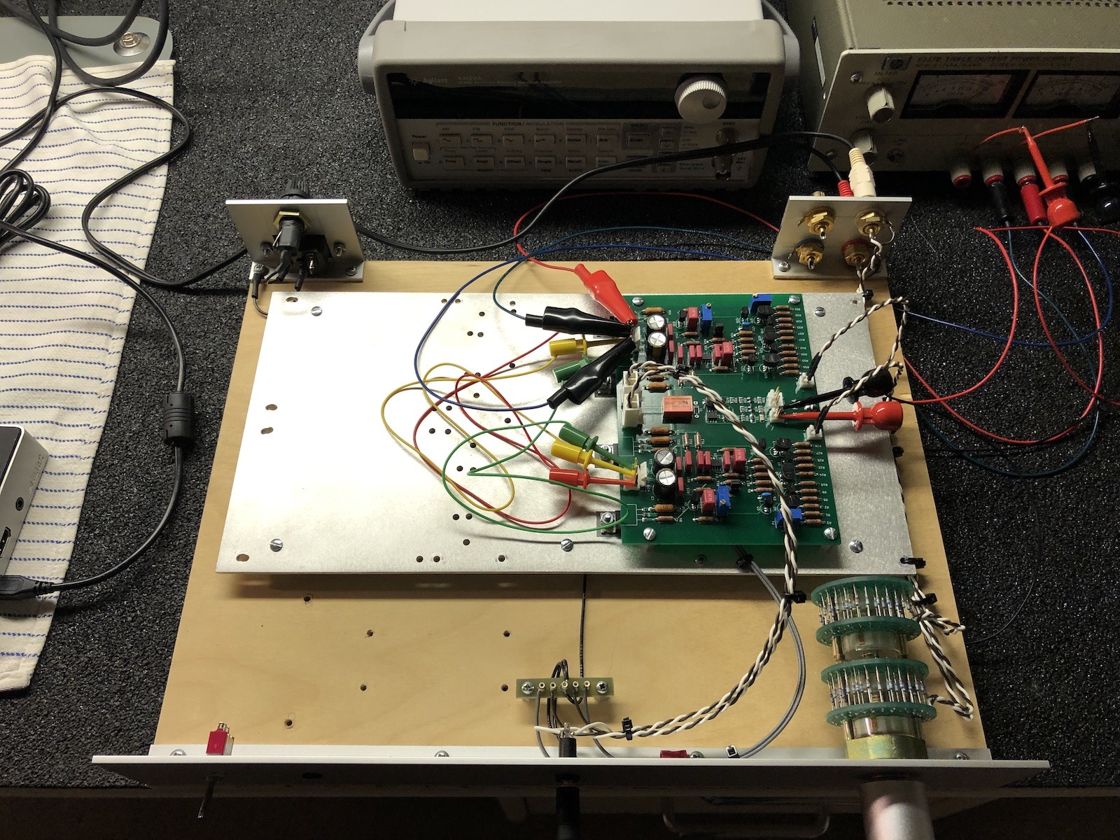

Yes, I am running it off of a forty year-old HP bench power supply. Stay calm, Mark. I do understand serious evaluation is pointless until I give it a proper power source. I just wanted to see if it worked.
The sound is very promising. I don't want to get carried away with the subjective descriptions like I did with the A1/A2. It has a bit of a "tubey" quality. Organic, maybe. It's quite pleasant to listen to. Not hyper-detailed. It has plenty of bite on the top end, though. No doubt it will tighten up with the official power supply. It's a different presentation from what I'm used to.
I checked the bias and offset quickly but didn't try to trim anything. The panel meter on my power supply is holding steady at 260mA. The metal plate is warm, but not hot as expected since the dissipation is about the same as the A1/A2.

I've been listening to this setup for about an hour now. Bias is still steady. No flames.

I was concerned from the very start of this project about bias stability. The diamond buffers in the A1 and A2 stabilize very quickly and the bias barely varies. The A3 bias slowly drifts down over time, but as I mentioned, settles at a constant value in the test rig and doesn't get too high as long as I stay away from the spreader transistor. It has a negative temperature coefficient, i.e., if I heat the spreader the bias drops. So it should not be prone to running away.
I understand now that the proximity of the spreader in the commercial design, and the unvented cabinet, are part of the thermal design. If I have problems, I can experiment with replacing the spreader with a TO-126 device mounted on the chassis floor and connected to the board with short wires. The temperature slope of the whole circuit will depend on the thermal resistance between the output and spreader transistors, evidently. I think it will probably work ok as-is. The aluminum plate gets pretty warm and is in close proximity to the board from underneath.
