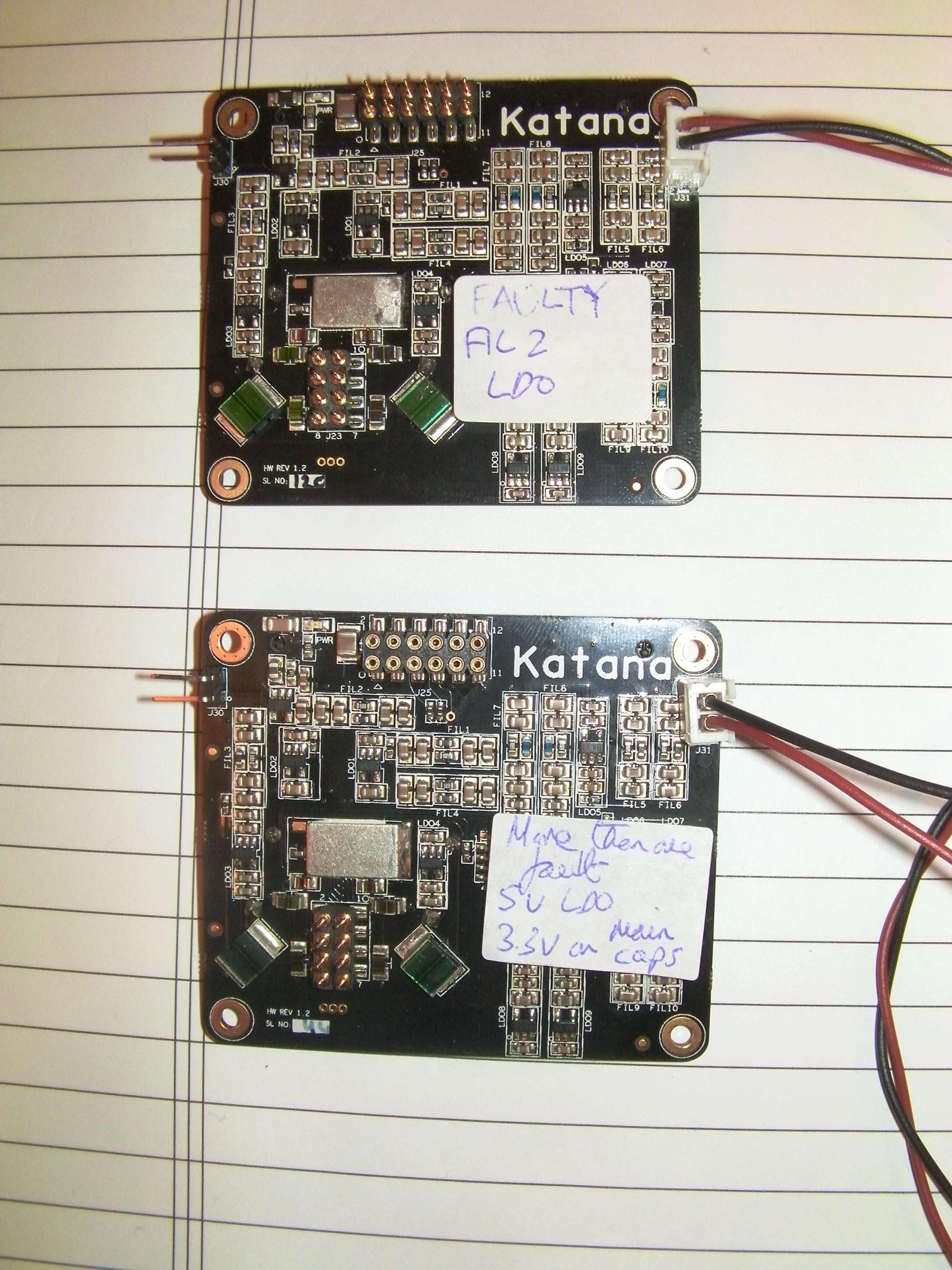

To spice things up further though I have just noticed this...
https://www.diyaudio.com/forums/att...1543167376-fifo-buffer-rpi-sbcs-sany0679a-jpg
Apart from the labels can you spot the difference. Note that both connector males are properly orientated in their sockets and both of the flying leads are as supplied by Allo. Ooops!
The upper lead was supplied most recently. The lower lead came with my original Katana. I'm upset again.

Man, You might have saved my day after feeling like the last idiot, thinking I did something so stupid 🙂

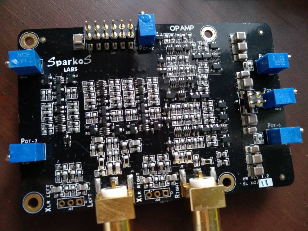

So it looks like I also fried my katana 1.2 player with Isolator 1.3, trying to connect the DAC board to an external 5V PSU. The faulty cable either arrived on November 23rd, with the initial package, or on December 14th, with the output stage replacement for the left channel only "mono" version I received originally.
Thanks to your posts, I realized I had 2 different (inverted polarity) cables provided by allo from the 2 shipments! Now, looking at your photos and the ones from the katana manual, I'm confused about which polarity is the right one? Attached is a screenshot of Katana 1.2 manual showing positive (red/brown) on top whereas I understood from your conclusion that it should be the opposite? Or maybe the new manual also has the same miserable error as some cables??

Hi Cdsgames/andre,

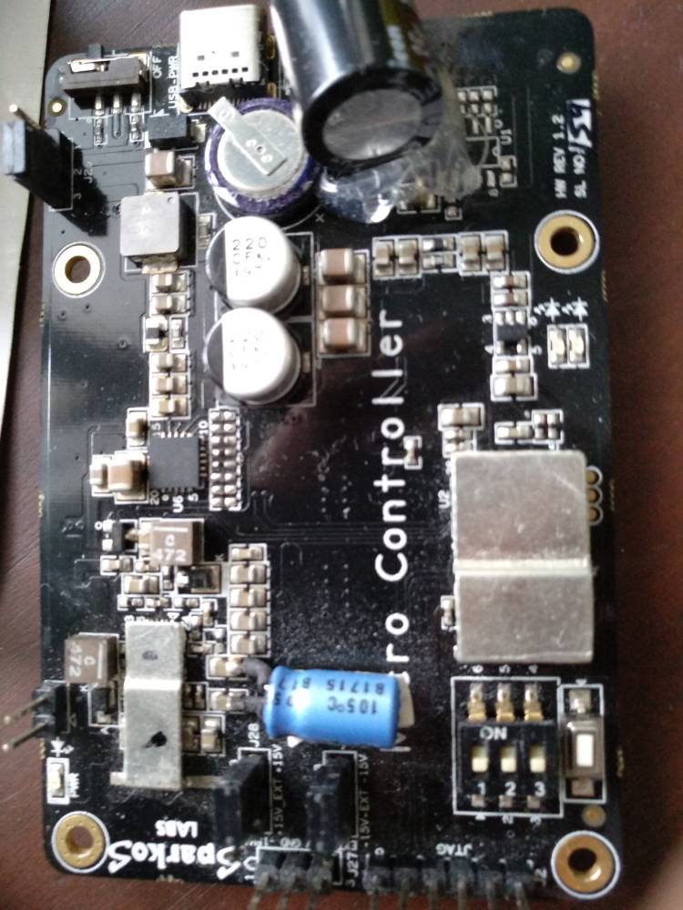

Apparently, there is no music output from the THD. The sparko MC had been heating up so bad. I am running the katana stack with isolator ever since (almost 3 weeks since I recieved the THD stage) ysing 2 power configuration with the supplied smps from allo.
I dont know what is wrong with this wether this is a sparko or pi related issue. View attachment 725377View attachment 725378View attachment 725379View attachment 725380View attachment 725381

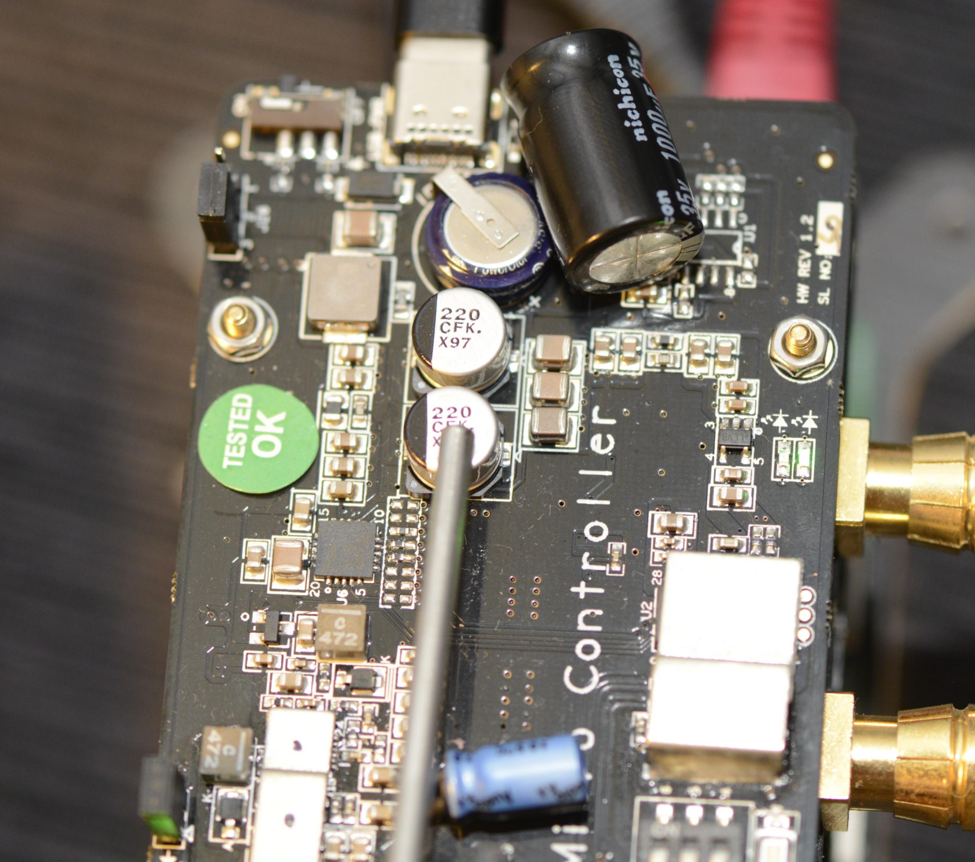

hello gtv4.. exactly.. this area of microcontroller where you pointed it with metal.. those film caps heats up like an oven.. it can fry your finger. Worst is.. the convective heat to the acrylic box also is too hotFunny you should say that - I'm currently in an e-mail ding dong with Allo trying to sort out exactly the same issue. I've the MC drawing 2A on its own and see 55C on the MC caps
by the way.. 55 deg measurement using that rod is not accurate. since the air surrounding your space contributes to the reading of temp. the tip of the metal in contact with those film caps is so small. its hotter than 55 if you isolate it.

Its just.. with continous usage.. my equipment encountered a sudden heat up and sound output vanished. hope allo can troubleshoot this. otherwise.. it can be a serious quality and reliability issues for Katana.
I don't messup with power supply nor any hardware. I just plug n play and toy with the OS and softwares.

I am using a 2 smps configuration. Never tried tri powering the Katana v1.2.
Break down happened at the recommended power configuration of Katana and after continously using it for 3 weeks. I only plugged it out when I travelled for 24 hrs for a long vacation. I plugged it back for 15 hrs and it worked flawlessly, and then the heating ang circuit buzzing occured without doing anything. on it.
You are probably right re the temp reading - my IR thermometer has given up the ghost and this is the memsahib's K type cooking rig.

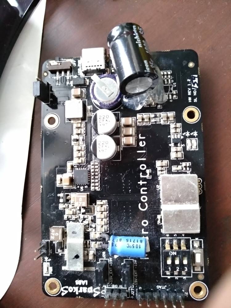

gtv4.. mine worked for almost 2 mo. then heating occured. the buzzing or squeaking sound stays when prolonging the microcontroller section powered.You are probably right re the temp reading - my IR thermometer has given up the ghost and this is the memsahib's K type cooking rig.
Back to the subject. I was one of the wrong polarity-frying-Katana group and the latest finger pointing is that the microcontroller board is not outputing +-15v. Allo has kindly agreed to send a replacement. Lets hope the OpAmp board was not affected by the fry up and/or the MC issues......
im now in touch with allo's rep.. i also checjed the ssh output in the volumio..
I have a 2 year old child.. it could cause him blister if he touched it. good thing i was able to detect it early.

@Jonathan P, I forgot that also, a board revision would normally trigger a HW revision number change. ALL of your boards pictured are HW revision 1.2. Allo would absolutely have to change the board design (and would have changed that revision number) to have changed which pin on J31 takes the +5V input.
@marudo (and @gtv4),
I did some probing around the Microprocessor board and those 2 conductive plastic caps appear to be in the 5V feed to the what I identified as a TPS7A4700 regulator (U6) which I believe is the pre-regulator before what I believe is the DC-DC converter (U3).
To get hot, either the voltage going into the stack is too high or it is drawing too much current. I'm assuming you have checked this, but if not, can you check the output voltage of the SMPS feeding the Microprocessor board? Easiest place to check is across the + & - terminals of the supercap on that board.
Also, can you measure the current draw of that 5V feed? @gtv4, looks like you did this already, was the voltage still at 5V?
Finally, can you check the temps on the 2 heat sinks, the one on U2 (microprocessor?) and U3 (DC-DC converter?)?
Thanks!
Greg in Mississippi
Thanks!
Greg in Mississippi
