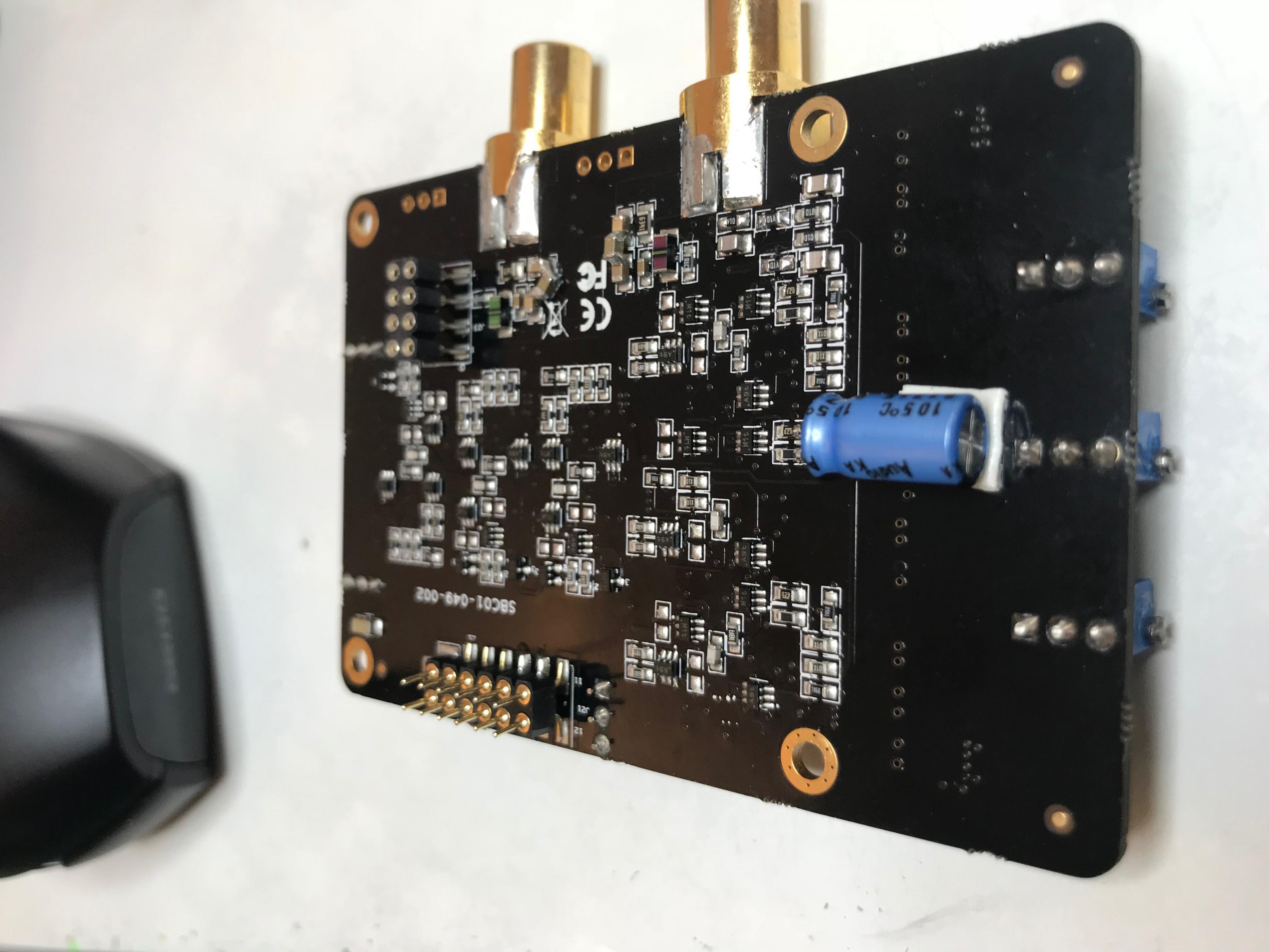

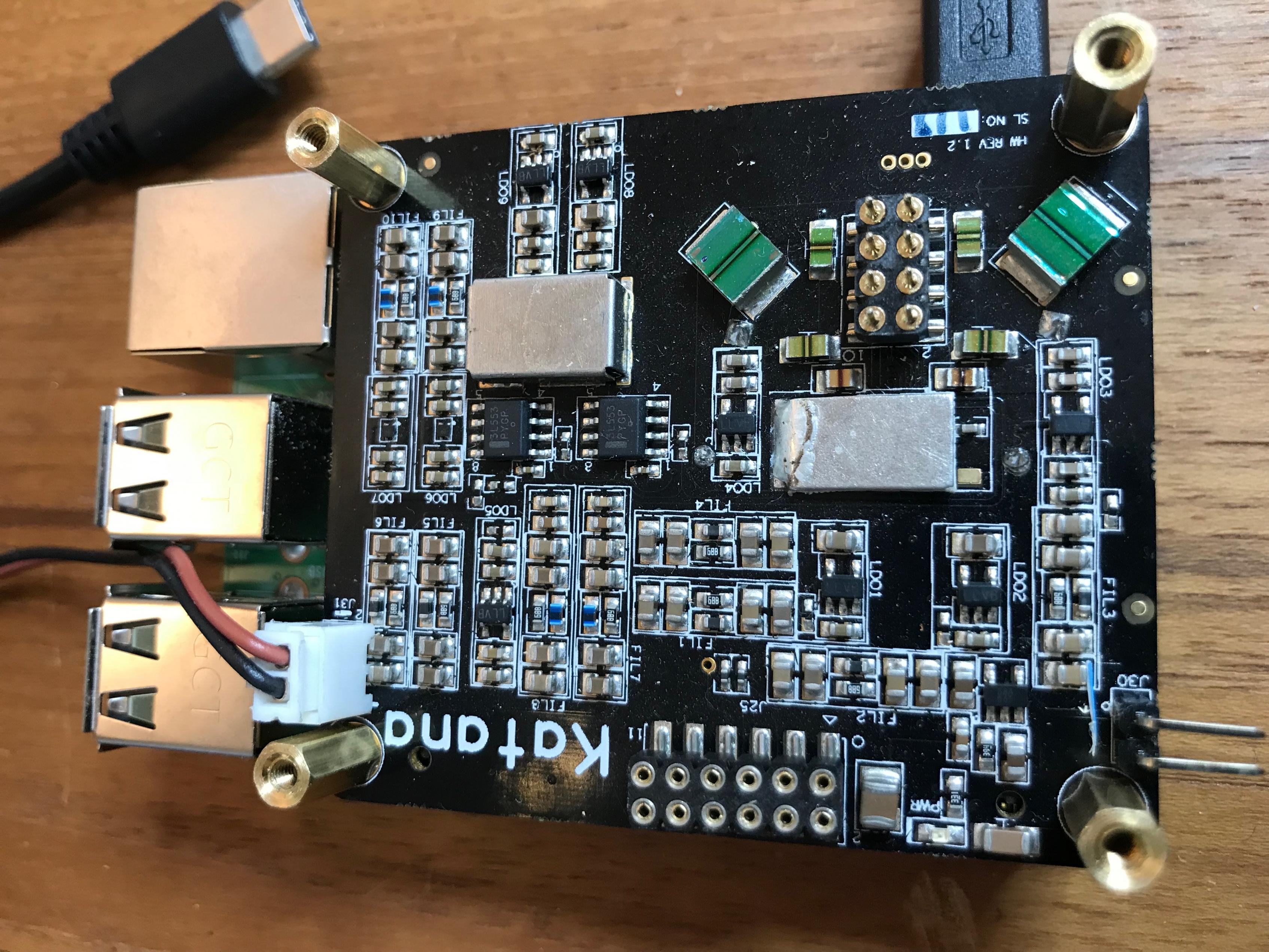

Hi Terry
can you please check your Katana , the stage should be fine for your revision
I don't think it is...
Please check pictures of THD board and katana

What is the problem with the Katana board?
Katana board is working, but connectors are inverted. As on my thd card. So they match.
I received sq output stage with new(correct) connectors.
So they prefer to send me a new version of katana maching my sq board.

HI everyone, How can I know which board is Katana SQ or Pure TDH? Because it has not label on the board. I still burn in the stack and wait to finish. Thanks !
Hi, Could u show me a close look of THD board, I want to compare THD and SQ board ( I think SQ board label a X-Board on the rear) !Hi,
The SQ board has a small, slightly raised area around the pin header with 6-pins (?) that is a little piece of PCB material glued on top of the main pcb. The raised area has an SMD cap and two SMD resistors on it.
The THD board does not have those particular mods.
