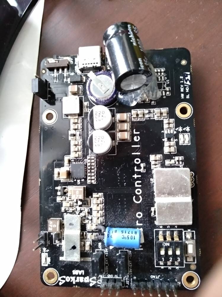

Does it still work after cooling and power cycling, or is it always broken now?

I cooled it a little bit. But I can hear the squeaking sound in the board itself.. I think the output stage is damaged too..
do u think a component breakdown?

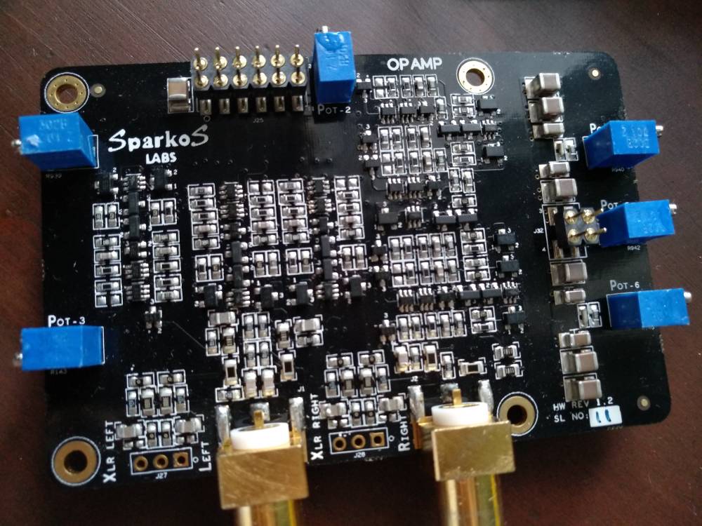

Mark, can you please clarify what you mean by the SQ boars is more distorted compared to the THD+N board? Which one sounds more musical? What I mean does a Violin sound like one, what a cello, piano, drums, etc.?
The sound quality is more distorted than the THD output stage, for those who notice that type of thing. What kind of sound quality are you looking for? Also, why do you want a picture, you want to buy on looks? Anyway, if it helps you can see what makes it different from the THD board in the picture posted a few pages back in this thread:https://www.diyaudio.com/forums/vendor-s-bazaar/294940-fifo-buffer-rpi-sbcs-286.html#post5628255 It has the mod that says 'Katana-X-board' on it. If click on the pic to open it, then click on the white X in the lower left hand corner, it will blow up to full size so you can see clearly.
To me, I don't like distortion. I want to hear what's on a record as it was intended to be heard by the artist and the producer. Cymbals sound like real cymbals, low level reverb tails are clearly audible, etc. All the little details are there and they all sound good. For that, very high quality accurate reproduction is required. As a reviewer, I tested Katana in various configurations and did listening comparisons between it and other very high quality dacs. The good news is Katana *can* be an excellent dac. As of this time, I only know one way to get the best sound quality out of it. What is best IMHO is Katana with the THD output stage (the one with less measured distortion, and it sounds that way too), with an optional 'Isolator' board, and with modest +-15v and +5v linear power supplies for Katana boards. The RPi can be run on SMPS (I used IFI brand). It also sounds clearly better with about 100uf of good quality film caps on each of the +-15v rails. The linear power supply I used was from a kit that cost about $70. The +15v regulator inside the power supply was an LM317, but was replaced with a bit better newer three terminal regulator at some point in the past. The power supplies may add (I'm guessing) maybe $150 to the cost of the dac system. The Isolator board is an extra cost too. A picture of the setup I tried that gave the best sound quality is attached below. The red block on the left is the film caps taped together.
That's very interesting. Can you tell which board the squeak sound is coming from? It would suspect one of the +-15v switching inverter inductors. That is the type of thing that might be able to make noise. To see if that is the source or if the sound seems to be related to the +-15v, you could try turning off the little slide switch on the MCU board that can disable the inverter.
If not coming from there, then it might help if you could track it down to where you think it is coming from.
While thinking about this, what makes you say you think the output stage may be damaged? Is the sound distorted/noisy, etc.?
Also probably a good idea to separate the boards and examine them visually very carefully, and also check for any odd or burnt smells on any of the boards. Anything you can do to provide Allo with some more information may help them figure out how handle what sounds like it might be a warranty issue. Unless your wall wart power supply went over-voltage and caused a problem then about the only other possibility is that something went wrong on one of the Katana boards without any known cause. In other words, a warranty problem exists.

I will examine this later. By touching the acrylic near the film cap and the audiophile cap. I almost burn my finger on its temperature outside. I hadnt experimented on it. Im a plug and play kind of person. I dont toy with the 15v other than what was supplied by allo.
by the way.. Im using the walwart from allo.
in a two power configuration only.
im really frustrated.. it nay pose safety risk in my part.
gosh.. there is no output in the katana

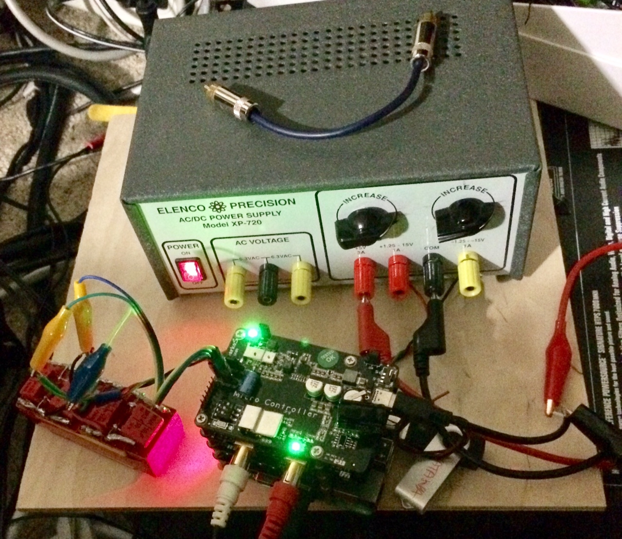

Can the SQ board be powered by an external +/- 15 volt psu?
Yes.

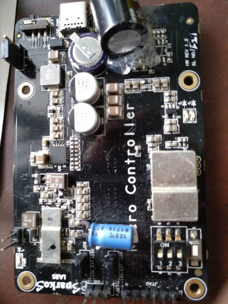

Apparently, there is no music output from the THD. The sparko MC had been heating up so bad. I am running the katana stack with isolator ever since (almost 3 weeks since I recieved the THD stage) ysing 2 power configuration with the supplied smps from allo.
I dont know what is wrong with this wether this is a sparko or pi related issue.
