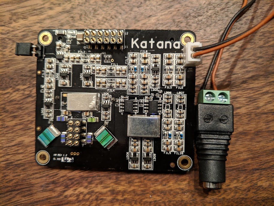

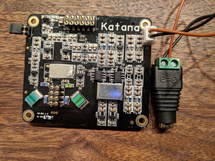

Hey Greg,
Just for clarity, in case it matters, on my Isolator board it shows HW revision 1.3.
For the photos of my setup, I posted a link to online album. Let me know it you can access it and if the photos are clear enough.

I think it would be important to clarify John and cdsgames posts about inverted J31 / connector polarity because I don't want to fry it again! :|

Unless your Katana DAC board has a HW Rev different than 1.2, I am absolutely certain that the positive connection is as I described. BUT it is always good to confirm that with a continuity check as I described... If you don't have a meter, I suggest getting an inexpensive one from someplace like Harbor Freight. Doing any sort of DIY work (and connecting wires like this is definitely DIY) you want a basic understanding of how to use a meter to measure continuity, resistance, and AC & DC voltages. You will save a lot of $$$ & frustration with these in your toolkit. Hooking up power to something you have a question about and haven't checked will eventually result in a 'destroy a board' failure.

P.S. Why I'm certain of what I say about where the +5V pin is on the Katana rev 1.2 DAC board is that I have 4 of them here, 3 of which I've powered up and used. Some came with the brown lead (+5V) on the connector in the right place, some with it in the wrong place. I confirmed where it should go before connecting power on each. They all had the +5V pin where I described, even the ones with the power connector installed backward.

BUT it is easy to check which way is correct with a quick continuity check. The positive side should have continuity to one of the pins on J30 AND to the 5V pins on the RPi GPIO header, 2 and 4. The ground side should have continuity to GPIO pin 6 (among others) AND to one side of almost ALL of the capacitors on the board (as most will have one side go to ground on this board... not so on the Opamp board). ALL of the Katana boards I have measure this way.

Hey Greg,
Do I have to detach Katana from the stack to perform your continuity test?
The results don’t seem to make sens so I assume I did not measure properly or maybe I got the wrong pins for GPIO2-4-6.
I added a photo to my album (Katana - Google Photos)
with wires in GPIO header for the pins I measured resistance between J31, J30 and caps.

So here are some results:
Isolator J30 pin away from the mounting hole (towards the caps in the middle of the board)
J31 +: about 1.2 ohms
J31 -: about 60 ohms
GPIO2
J31 any of the 2 pins (+-): about 1600-1700 ohms
GPIO 4
J31 any of the 2 pins (+-): no continuity
GPIO6
2 big caps _- side) under Katana board (7N2222)
J31 +: about 50 ohms
J31 -: about 3 ohms

@Jonathan P
Some hints... First search online for Raspberry Pi GPIO Pinout to get a map of the pins on that connector so you are checking the right ones.
Second look for the pin numbers on the bottom of the Katana circuit board at the GPIO connector corners so you can match the map to the pins. Note that pin 1 is indicated by an arrowhead.
Third probe the fingers at the base of the GPIO connector. These are where each position of the GPIO connector are soldered to the board and easier to reach.
Fourth you are looking for zero or nearly zero ohms between the pin I indicated as the +5V one on J31 and one of the pins on J30 and pins 2 & 4 on the GPIO connector. Easiest to reach that J31 pin on the bottom of the Katana board.
Let us know how you make out.
Greg in Mississippi

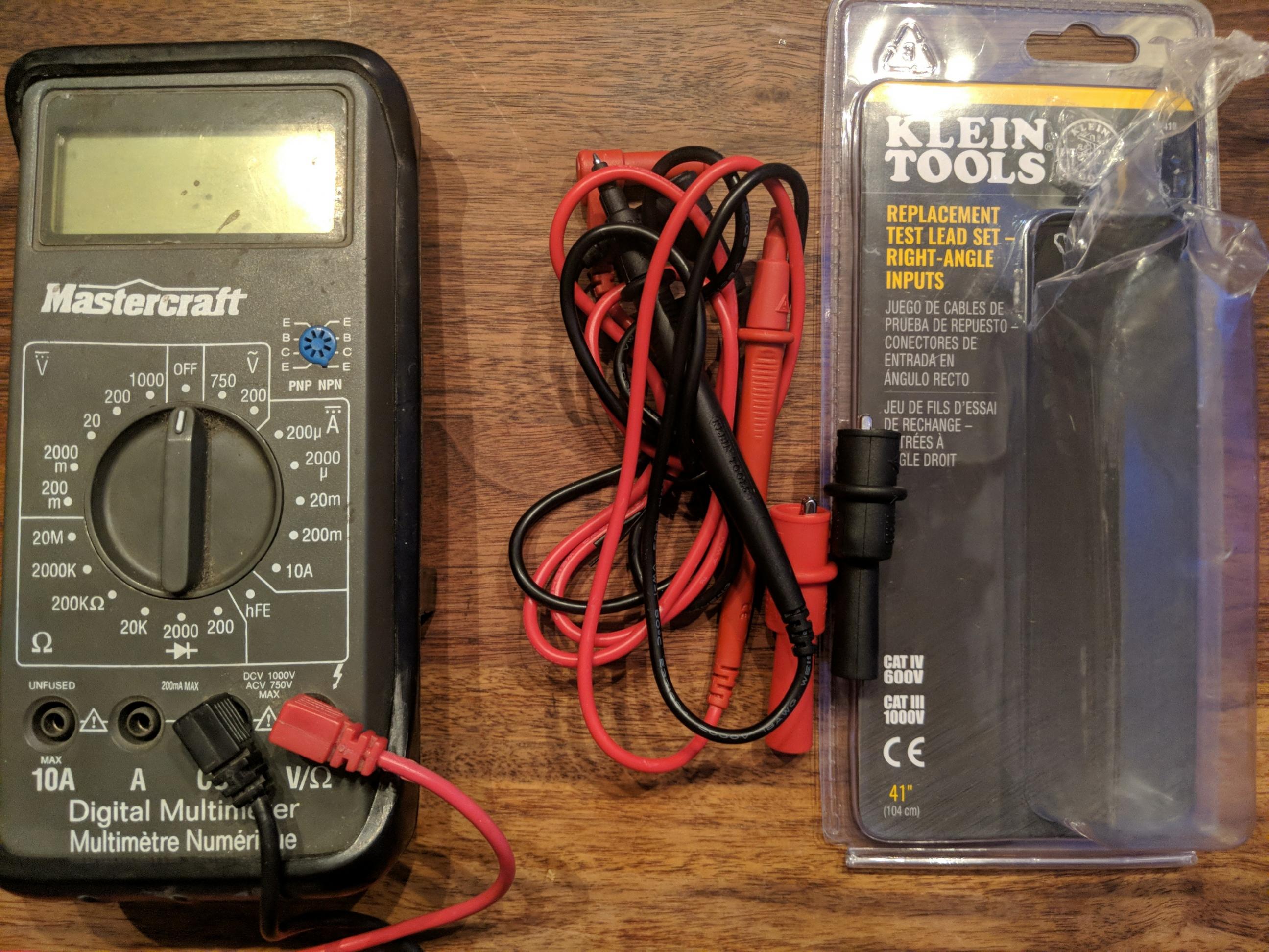

I think I have a decent multimeter but one of the probes is broken so it’s hard to get reliable readings.
I still get some K/Mohms readings where I shouldn't but I suspect it’s due to my broken meter probe and my fingers touching the probe points.
So using a 200 ohms range threshold to identify open/close circuits, here’s what I read:
Note: positive side = the side shown in my photos that you identified as the side closer to the mounting hole close to the last “a” in “Katana” printing.
If I understood correctly, that would mean that the culprit is not this J31 connector/cable.
Who could the culprit be then?
@Jonathan P, First, your link doesn't work. Send in a PM?
I sent you the link in PM and I'll give it another try here:
BTW, who was your customer support contact at Allo before?
My customer support contact people were:
- ruby@allo.com
- ravips@cem-solutions.net
...BUT it is always good to confirm that with a continuity check as I described... If you don't have a meter, I suggest getting an inexpensive one from someplace like Harbor Freight. Doing any sort of DIY work (and connecting wires like this is definitely DIY) you want a basic understanding of how to use a meter to measure continuity, resistance, and AC & DC voltages. You will save a lot of $$$ & frustration with these in your toolkit. Hooking up power to something you have a question about and haven't checked will eventually result in a 'destroy a board' failure.
Can’t agree more. I’ill work on it!
- positive side => J30 => GPIO 2/4: continuity
- ground side => GPIO 6 / CAPS: continuity
- My other Katana J31 connector/cable with reversed polarity? And I got lucky in my first test but not in my second?
- Loose Katana J30 jumper
- Wrong MC J27 settings? All open, according to the manual
- iPower know to fry connected gear?

Hi Greg,
Thanks for you answers.
All photos in my google album show the setup for the last Test I performed, with the cable on the right in the image with the 2 J31 cables/connectors you mentioned.
For clarity, here are photos of the 2 cables connected to Katana:
- cable1 photo (RED wire on top close to mounting hole)
- cable2 photo (BLK wire on top close to mounting hole)
- All setup photos
Just before this last test, I also did the exact same test with the same boards, supplies and jumper settings. The only difference was to use cable2 instead of cable1. Not so smart, agreed! The connectors on cable2 were super loose so I thought it could be defective and switched cable2 with cable1, obviously without noticing they had opposite polarity. Didn't notice either the + sign on the board hidden under J31 connector :|
Note: I read 5V at the end of both cable1 and cable2 between brown and black wires so I assume the PSU polarity and provided black/green barrel connectors I attached to cable1 and cable2 are connected properly.
Logically, if my readings are valid, it should mean that it's this previous test with cable2, that is more likely to be the culprit, or J37 on MC or something else, right?
How to tell if this is the case? Are my photos and continuity checks sufficient to confirm it’s ok in my case?BUT some Katanas have the socket on the J31 turned 180 degrees when they were installed
FYI, I followed your advice and got a new set of top notch (I believe) Klein Tools leads with removable clip extensions for my multimeter 🙂
