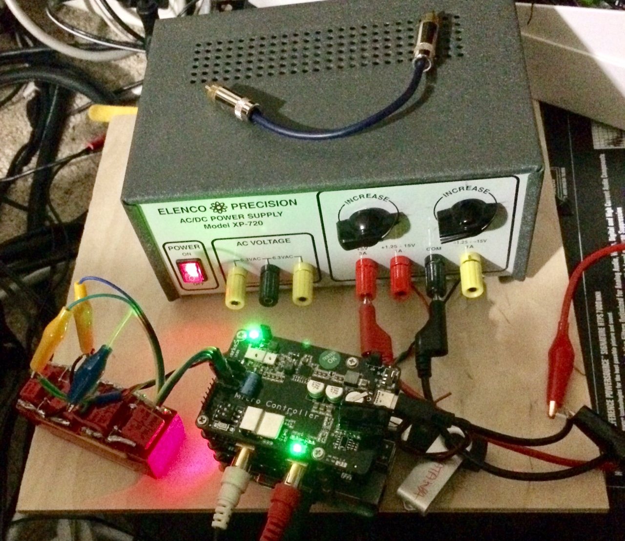

Katana needs at least a modest +-15 and 5v linear supply, and some film caps on the +-15v (~110uf per rail?) to sound its best. With the right interpolation filter it can sound excellent, IMHO. It can be done for maybe around $150, plus a 5v supply for RPi.
Trying to use it with two or even three 5v supplies is almost is garbage by comparison, again IMHO. That may seem a harsh thing to say, but just try the linear solution and see if you don't agree, is all I can say.
That means three supplies with the RPi.
See attached picture for how I did it. That power supply was a $70 kit, and the red thing on the left is some film caps taped together.
