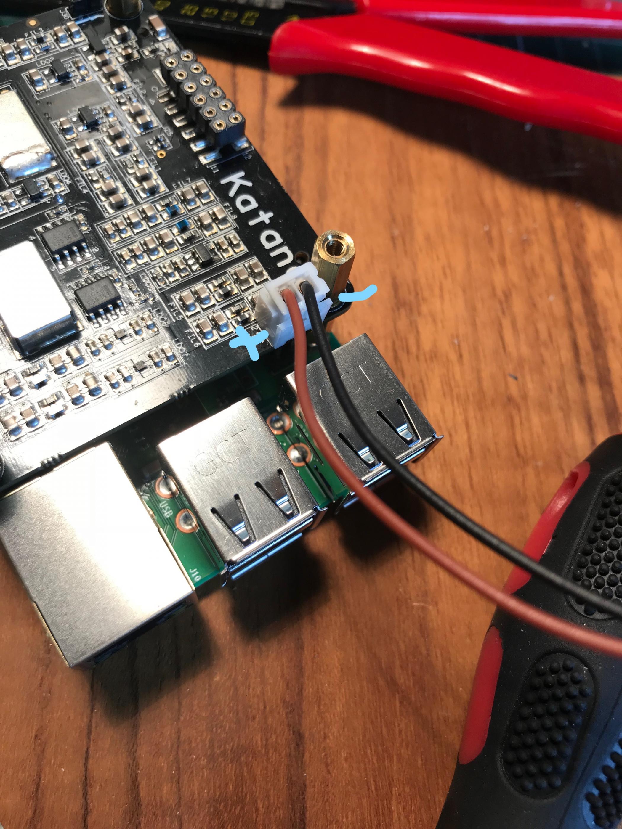

thank you for the fast support!
I just received the cable today.
Does someone can just confirm to me that it is the right polarity please?

Looking at the katana pdf and the black cable is on the left.
Did I received a wrong cable?
I'm a bit lost now...

That cable looks wrong to me. Brown wire should be near the word 'katana' on the right. Isn't that how the manual shows it?
Color code is wrong on that cable.
POSITIVE (+) is always next to the word Katana , next to the assembly hole.

Thank you very much Mark!
