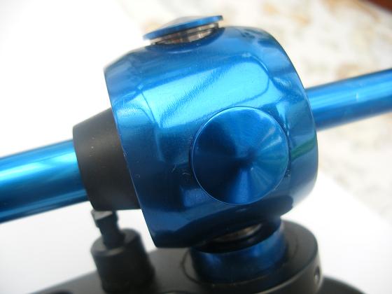

its fitted with this arm at the moment
best wishes for now
j7
