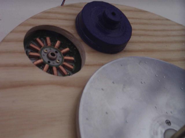

as a test i asked my wife to sit on the spindal ....she said NO
but i recon it may have turned her with a slight start ....lolol
its strong for a tiny ampage draw
best wishes
j7

just tryed a linn outer platter ...the brushless motor turns it fine ...starts almost instantly...and its silent
Can you hear any difference in sound quality? Or have you not got that far yet?
(I am following your progress, because I see this as a possibly upgrade and a wy to get 45rpm)
Regards
Iain
Regards
Iain
hi iain
i cant say i noticed much sound difference from the perspex platter and the metal linn platter ....although i would need sit down and compare for a few hours ...before i say for sure
the main thing i noticed is that the motor is almost silent...and i have heard that some brand new floppy drives are commin on much smaller pcb boards ...this is good for us
i mostly use old floppys ...but maybe i need pay my pc shop a little visit
any questions just ask
best wishes
j7

I am toying with the idea of replacing my papst ac motors with floppys. Or just building a TT from scratch. Any views on this?
If the motors are so silent, could they be used to direct drive?
possibly iain ..i havent tryed direct drive

The circuit I posted way back was for a 3-phase sine-wave oscillator, suitable to feed the inputs of three amplifiers (ordinary 12V chip-amps will do) which then feed each phase winding of the motor. Aren't hard-disk drive motors only 2-phase? (You'll need a quadrature oscillator to drive two power amps if that is the case). Also hard drives spin quickly, so the stator windings will be low inductance. I think that they will not have enough inductance to make the motor work well at lower RPM such as you'll need if you're trying to use it as a belt motor for a turntable.

There's oodles of information on DIYaudio.com, including information on re-winding and better magnets.
Personally, for the sake of cheapitude, I would retrofit the controller from a four-pole DC brushless motor in a 120mm computer fan. These are cheap ($10 or so...if you buy one new), reliable, and thanks to their PWM input, variable in speed. As an added bonus, the combination of more windings and 12 poles (that's what I found on my Nakamichi floppy drive) should vastly drop the RPM.
Add a rotational encoder and a $2 microcontroller, and you can regulate the speed via a feedback loop.
I would never thought about fan motor 🙂. That's and idea !!!
I wonder, how heavy platters can be used with those motors? I thought about use of single layer of MDF ( 3/4'').

5 1/4" drive
I've just gutted a 5 1/4" drive and find that simply applying 12V across the terminals on the motor board marked 12V, GND made it spin (and in the right direction). I bodged up a strobe by connecting a high brightness LED to my function generator via a 100 Ohm resistor and established that there's quite a powerful servo locking the speed to 360rpm. The whole thing seems to be locked to a 787kHz crystal. The hub is 1.454" in diameter, so a carefully machined 45rpm step (1.5" for a 12" platter) would just slip over it, and the 33 1/3 step (1.111") could be above. Given that it's locked to a crystal, I think the only way of varying the speed would be to remove the crystal and replace it with a higher frequency crystal divided down by a programmable divider.
EC8010 said:I've just gutted a 5 1/4" drive and find that simply applying 12V across the terminals on the motor board marked 12V, GND made it spin (and in the right direction). I bodged up a strobe by connecting a high brightness LED to my function generator via a 100 Ohm resistor and established that there's quite a powerful servo locking the speed to 360rpm. The whole thing seems to be locked to a 787kHz crystal. The hub is 1.454" in diameter, so a carefully machined 45rpm step (1.5" for a 12" platter) would just slip over it, and the 33 1/3 step (1.111") could be above. Given that it's locked to a crystal, I think the only way of varying the speed would be to remove the crystal and replace it with a higher frequency crystal divided down by a programmable divider.
