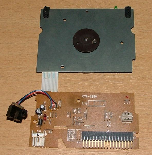

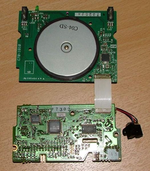

I fixed the switches and joined the pins. On my floppy the motor
only starts after I insert and remove something into the photo
interrupter. I see the same device on your board but as you say
every floppy is different. Is it possible to run the motor without
the logic board or is the main chip involved in the operation?

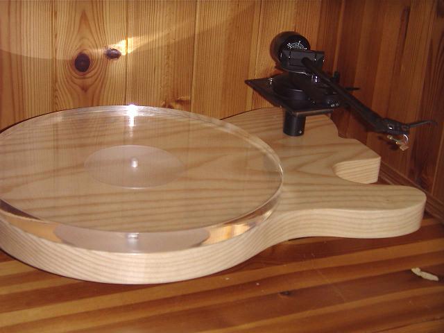

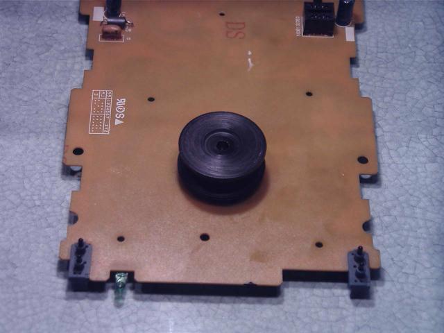

hi
you have what i call the inverted type floppy ...with just the spindal sticking out ...this will make a fine motor for turntable
u need to use this end to mount a pully on ...u will need flaten the surface or pull of the existing pully ...to help mount your new 33/45rpm pully

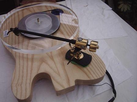

the long awaited part 3 is now ready
http://www.audioorigami.co.uk/FloppyProject/FloppyDIYMotor3.htm
thanks for your suport
best wishes j7
best wishes j7
that would be part 2.
http://www.audioorigami.co.uk/FloppyProject/FloppyDIYMotor2.htm
I found this 800ohm resistor inline to the motor controller…
(by jumpering each resistor with a 1000ohm resistor to see if any speed change was possible)
Each floppy will be different…so if you want to try varying the speed you will need spend a few minutes checking

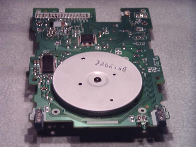

hi
also raiseing the hieght of the magnet with a thin shim changes the speed....
finding what resistor changes the speed can be made easy by...
i wet my finger and put over the resistors to find out what resistor changes the speed fast
hope that helps
best wishes
j7

OK!
Thanks, I will try the finger trick 🙂 I am really anxious to get my DIY TT going 🙂 Audiorigami; do you have any pulleys that would be suitable for use with a linn lp12 subplatter? How much would it cost me? Thanks yet again!
Clever.

u can make tempory pullys from plastic easy with a electric drill....the final size will take a few attempts round about 16-18mm should be a good starting point
hope that helps
j7
hope that helps
