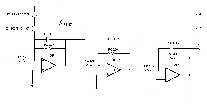

It's not the stepper motor, but the three-phase drive motor for the floppy, which normally runs at 360 rpm. I've used these myself, but I only used the motor as a 3-phase synchronous motor by building a simple 3-phase oscillator and using three low-power drive amplifiers, one for each phase, driving the stator in a 'delta' configuration.

This is the type of 3-phase sine-wave oscillator I use. I've set the frequency to give 33rpm on my turntable, so you'll need to alter the value of the 10k resistors (and perhaps the capacitors) to get the correct frequency for you.
I run ordinary LF351 op-amps on +/6V, which also feeds the three power amps. Any low voltage audio power amps that will supply about 6V pk-pk at a current of 300mA or so will do.
If you dismantle the floppy drive, you'll find the rotor just pulls off. It's fairly easy to trace the three winding connections to the flexible ribbon. Simply connect the output of each amp to one of the stator wires. If the motor rotates the wrong way, swop over any two of the connections.

Perfect, thanks. That's exactly what I need. I've already pulled my motor apart, traced the windings, etc.
