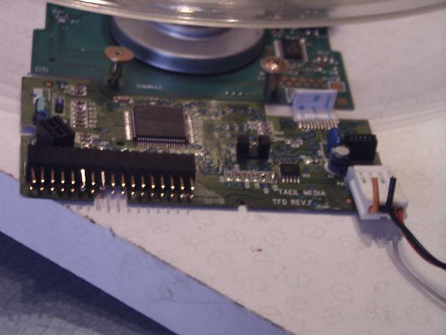

I have a plinth, a Mayware formula4 mk3, Linn LP12 subplatter w/ bearing + subchassis and an Originlive platter.
I am just missing a motor and control circuitry.
I tried a couple of dc motors with LM317T, but the speed kept wandering ( so I thought "sod it" and put the almost finished TT away a couple of months ago).
hi tom
the new type floppys are what i have gone for ...simply coss they very easy to find
infact the old 5inch floppys are much better because they used bigger stronger motors...its the same wireing to make them work ...and slightly more ma to drive them ...so yes the 5 inch type are even more perfect....again every manufacter has made its own types ...so half the fun is opening the unit to see

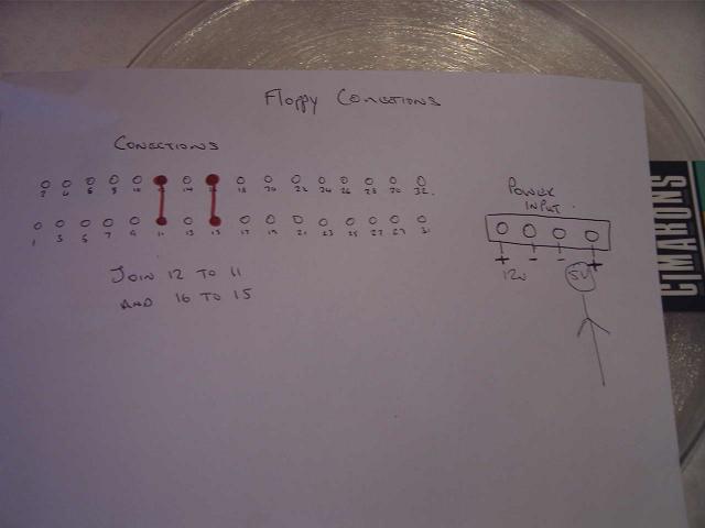

these units are all negatively - triggered....
pins 12 and 16 are conected to the - of the battery pins 1-33 are all - as well....you cant do the unit any harm with a 4 or 5volt (mobile phone )battery...so dont be scared to try out things
the 12volt circuit is not needed in our use ...only the 5 volt side
12v (yellow) and 5v (red)...although a 12v battery could be used if you wanted with a drop down 5v regulator
i will have some time to photo my test unit with vary speed and wireing ill post tonight
so get out and grab some junk out your bin:)
best wishes
j7
here is the wireing....easy
